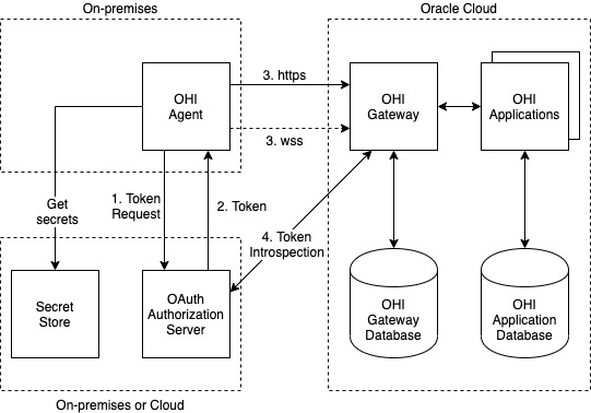

The following picture provides a high-level overview of the operating context for the OHI Agent:
OHI-agent-prerequisites
It shows the following prerequisites for using the OHI Agent:
  • An OAuth2 Authorization Server: the OHI Agent retrieves tokens from the OAuth2 Authorization Server that it uses to access the Oracle Insurance Gateway. It does so using the OAuth2 client_credentials grant type. The Oracle Insurance Gateway inspects the token and for this to work the OAuth2 Authorization Server must support the OAuth 2.0 Token Introspection standard (RFC 7662). Alternatively, the OHI Agent can also be configured to access the Oracle Insurance Gateway using Basic Authentication.
  • Secret Store: The OHI Agent requires access to a secret store for retrieving secrets. An example of such a secret is the username/password credential that the OHI Agent uses to retrieve the OAuth2 token. Either configure a Java KeyStore or HashiCorp Vault as secret store. Details on the secret store configuration for use with the OHI Agent are listed elsewhere in this guide.
  • Secure connections: the OHI Agent requires connections to the OAuth2 Authorization Server, Vault (optional) and the Oracle Insurance Gateway to be secured by using certificates. Details on setting up secured connections with the other components mentioned here are listed elsewhere in this guide.
  • If a load balancer is used for connecting to the Oracle Insurance Gateway make sure that it supports setting up secure connections for both the HTTP and WebSocket protocols.
