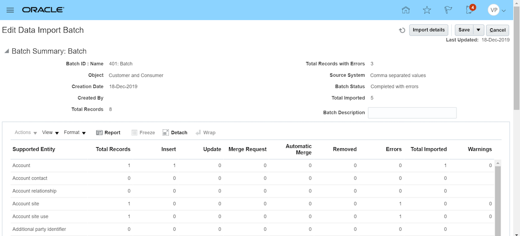

Fusion Import Results
The Oracle Insurance Gateway tracks the status of loading and importing data. Please note that although the import process finishes with status 'succeeded' that does not necessarily mean that all data was imported successfully. Check the results of the import process in Fusion itself. For example, the following screenshot shows the results of a CUSTOMER import batch that completed with status 'succeeded':
Of 8 records that were uploaded in CSV files 5 were imported but 3 were not.
