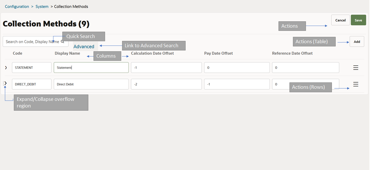

Page Layout
Components
Pages using View and Edit Object - List template has the following components:
Entity name and results count
  • Non-configurable, default functionality
  • The entity name plural is displayed above the table. Total count is displayed next to it
  • The count is only displayed when the user has performed a search
  • If no results match the search criteria, the message indicating that no rows were found is displayed by the results component.
Primary Navigation Actions
The primary navigation actions 'Cancel' and 'Save' are available on the page in the edit mode
Action 'Save' saves the object list and brings the object list back to view mode.
  • During save operation page gets into page gets into the Busy State-'Cancel Not Allowed.
  • When the request is processed and a response has been received, the page leaves the busy state, and the object is displayed again in the view mode in case of success or in the edit mode in case of failure.
Either a success confirmation or object validation messages are displayed. Server side validation errors are displayed in the overflow area of the erroneous record and a generic message about the presence of errors is displayed above the table component.
If the user decides to 'Cancel' editing the object list, a confirmation message is displayed in case there are outstanding edits on the page.
Optimistic locking is applicable when an object list is saved.
Configurable Actions in floor plan
  • Optional component
  • By default no action is available unless specified in the floor plan
  • Only 'edit' can be configured at page level, action link 'Edit' is displayed when defined
  • The primary navigation action 'Edit' is available on the page in the view mode only (when configured)
  • Action 'Edit' brings the object list in the edit mode and the object list can now be updated.
    • When action 'edit' is not defined then the page gets rendered as view only.
    • This also implies that the object cannot be brought into edit state. Action 'edit' should be configured on the plan to get the object in edit mode.
  • Example use case: To make a page view only, no actions are defined at page and table level
  • Optional Component
  • Links are placed next to the Edit action
  • For more details refer Links component
Auto Fetch
  • Optional property
  • Set true to auto fetch records
  • Center aligned
  • Can be customized to search on multiple attributes including flex codes, reference fields
  • For more details refer UI-presentation-configuration/components/quick-search.adoc[quick search] component
  • Displayed as a hyperlink which will display the advanced search dialog
  • Enables search on a combination of attributes
  • For more details refer Advanced Search search component
Sort
  • Displayed next to Advanced search when defined
  • Can have only the default or multiple sort criteria
  • For more details refer Sort Component component page
Pagination
  • Used to control number of records to be displayed on a page
  • Can be configured to display 5, 10 (default), 20, 50 or 100 records by using the 'Show' drop down list.
Table
Required component.
Used to display the object list in form of a table.
If no records available or no results match the search criteria, the message indicating that no rows were found is displayed.
For more details refer table component page.
Table component consists of the following sub-components:
Actions (Table Level)
  • 'Add' link is displayed at the table level when configured
  • Action 'Add' enables addition of a new record to the object list, that is, a new row gets added at the top
  • Multiple records can be added at the same time
  • It also brings the object list in edit mode
Rows:
Rows can be configured with the following components
Actions
  • 'Remove' is displayed for each record when configured in the row component
  • Action 'Remove', deletes the object from the list
Columns
  • Each property defined in this section forms a column in the table.
Labels
  • It is used to display property values in form of a label and can take in exactly one property per label
  • Multiple labels can be added to the results
Region:
  • Used if additional properties need to be displayed in the row overflow region
  • Hidden by default, user is required to click on the expand arrow to display the overflow area
  • Set 1 and Set 2: Sets are used to display multiple propertied as a set. Each result can have up to 2 sets and each set can have multiple tiles
For more details refer Table component page .
Conditions
  • Can be used to control conditional display of fields
  • For more details refer to Condition component page
Object Navigation
An object list can be opened by a direct URL
Responsiveness
The CRUD page can be used in desktop and tablet format. Scrollbars are added to the page to support responsiveness.
