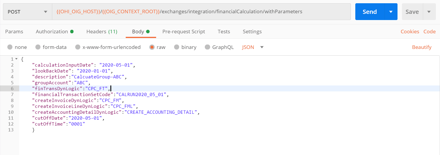

The image below shows the invocation of this integration using Exchange Integration Point - With Parameters
finanicalIntegration
The financial message generated by Oracle Health Insurance is accessible to FinMessageTransformation dynamic logic through bind variable 'finanicalMessageOHI'. The financial message gets transformed into ORMB message using transformation dynamic logic and is SFTP to ORBM (via destination 'ORMBSFTP') (see the previous example, for destination configuration) using DELIVERY step 'finMessageTransDeliver'
