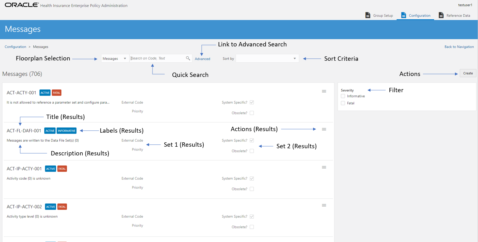

Components
Search Object - List View template can have the following components
Entity name and results count
Non-configurable, default functionality
The entity name plural is displayed above the results. Next to it the total count is displayed.
The count is only displayed when the user has performed a search.
If no results match the search criteria, the message indicating that no rows were found is shown by the results component.
Floor Plan Selection:
Search Object - List View template supports multiple floor plans for the same page
The user can switch context with a drop-down located next to the quick search input
Actions
Optional component
By default no action is available unless specified in the floor plan
Only 'Add' available at page level, action link 'Create' is show when defined
Redirects user to the create object page (recursive) in create object mode
When more than one view and edit object plans are evaluated by the system, then they are all shown as available options in the drop down. User selects one of the options and the create object page is shown using the selected floor plan.
Create as drop down list - The floor plan description is shown. The options are ordered based on the floor plan code ascending. Selecting a plan from the list, opens the create object page for the resource using the selected template.
If only one plan is evaluated, then the drop down is not shown and on selecting the action 'Create', system immediately opens the create object page using the evaluated template.
For details on floor plan evaluation refer to the chapter 'Presentation Configuration' in the guide.

Quick Search
Optional component
Center aligned
Can be customized to search on multiple attributes including flex codes, reference fields
For more details refer quick search component
Advanced Search
Optional component
Displayed as a hyperlink which will display the advanced search dialog
Enables search on a combination of attributes
For more details refer advanced search component
Sort
Optional component
Displayed next to Advanced search when defined
Can have only default or multiple sort criteria
For more details refer sort component page
Filter
Optional component
Filter criteria is defined to give users option to further filter the search results
A filter entry is used to restrict the search query, not to compose a new query
Example use case: Filter defined on a resource which may have multiple statues like completed, in-progress, started etc.
For more details refer filter component page
Results
Required component
Used to display the search results
Results component consists of the following sub components
Actions
'View', 'Edit' and 'Delete' are shown for each result when configured in the results component.
Action 'Delete', deletes the object from the list. A dialog seeking user confirmation 'Delete this record?' with 'Ok' and 'Cancel' is displayed when this action is selected. Selecting 'Ok' deletes the record. When deletion of the record is successful, a success confirmation message '\{object name singular} deleted ' is shown as specified in the message handling guide section 'Success confirmation'.
If any messages are returned from the server other than success; then they are shown as specified in the message handling guide section 'Cross field & server side validation'
Action 'View' opens the 'View and Edit' object page in the view mode and the action 'Edit' opens it in the edit mode.
The title of each row in the results section is clickable and takes the user to the 'View and Edit' object page in the view mode.
Title
Shown as the main title for each record in the results
Description
Set property will be displayed as description displayed below the title
Labels
It is used to display property values in form of a label and can take in exactly one property per label
Multiple labels can be added to the results
Set 1 and Set 2
Sets are used to display multiple properties as a set
Each result can have up to 2 sets
It is recommended to use only Set 1 when using the filter component on the page
For more details refer results component page
