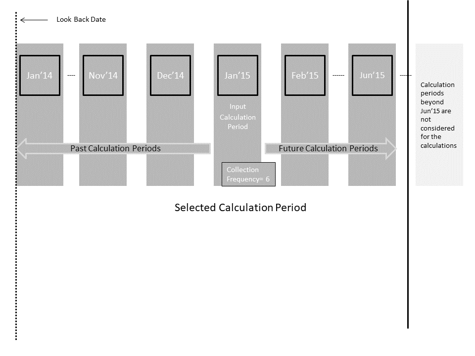

The system selects the calculation periods as mentioned in the image below:
First, the system identifies that the input calculation period Jan'15 consists of three calculation period segments:
11-Jan-2014 - 10-Jan-2015 / Group Account ORCL PART TIME
As part of this calculation period segment, even though the advance collection setting is 12 Months the system identifies that this is the last calculation period and hence no future calculation periods are selected. This is because the contract period ends in Jan'15 calculation period. -
11-Jan-2015 - 14-Jan-2015 / Group Account ORCL PART TIME
As part of this calculation period segment, even though the advance collection setting is 12 Months the system identifies that this the last calculation period and hence no future calculation periods are selected. This is because the policy enrollment products ends in Jan'15 calculation period. -
11-Jan-2015 - 10-Jan-2016 / Group Account ORCL FULL TIME
As part of this calculation period segment, system sees that the collection setting is 6 and hence the periods beyond Jun'15 are not selected.
All the calculation period segments which belong to calculation periods before Jan'15 are discarded since they do not require recalculation. So only calculation period segments within calculation periods Jan'15 to Jun'15 are considered.

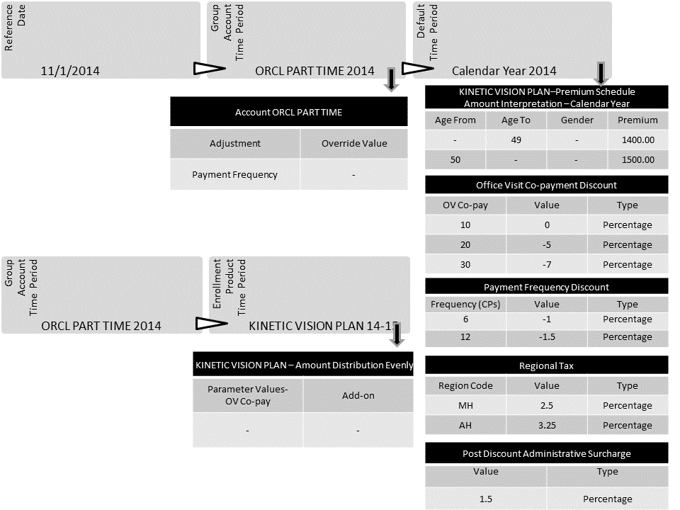

An Office Visit Co-payment Discount is configured for enrollment product KINETIC VISION PLAN. The Office Visit Co-payment Discount is based on OV Copay parameter based schedule dimension. An OV Co-pay parameter value of 30 is defined on the policy enrollment product in this scenario. Thus the adjustment rule with the dimension value 30 gets selected.
Office Visit Co-payment Discount adjustment = -7 % on a input amount of 1400.00

A Payment Frequency Discount applies for product KINETIC VISION PLAN in group account ORCL PART TIME. The discount depends on the Advance Collection setting on the policy. The system evaluates the following adjustment rules:
Payment Frequency | Adjustment | Type |
6 |
-1 |
12 |
-1.5 |
By using the dynamic logic condition the rule with the dimension value of 12 gets selected and the adjustment value of -1.5%, gets applied.

The image below specifies the configuration that is applicable for the last segment within the calculation period Jan'15: Contract Period 2 / Account ORCL FULL TIME / KINETIC BASIC PLAN
