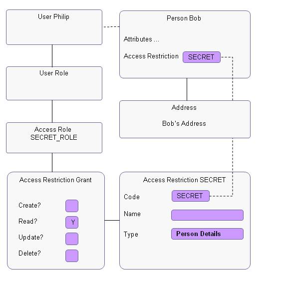

The following diagram provides an overview of the end-to-end chain that gives a user access to a record of an Policies entity that is protected with an access restriction. The diagram is not a data model, but an example of the relations between types of records and objects.
The diagram shows the following:
The person record of Bob has access restriction SECRET attached. This means that this record is only accessible for users that have been granted access to this access restriction.
Access restriction SECRET is granted to access role SECRET_ROLE.
Access Role SECRET_ROLE is granted to user Philip, so Philip has access to records labeled with access restriction SECRET and thus can access the person record of Bob. Because only the Read? indicator is checked, Philip cannot change or remove the person record of Bob.
