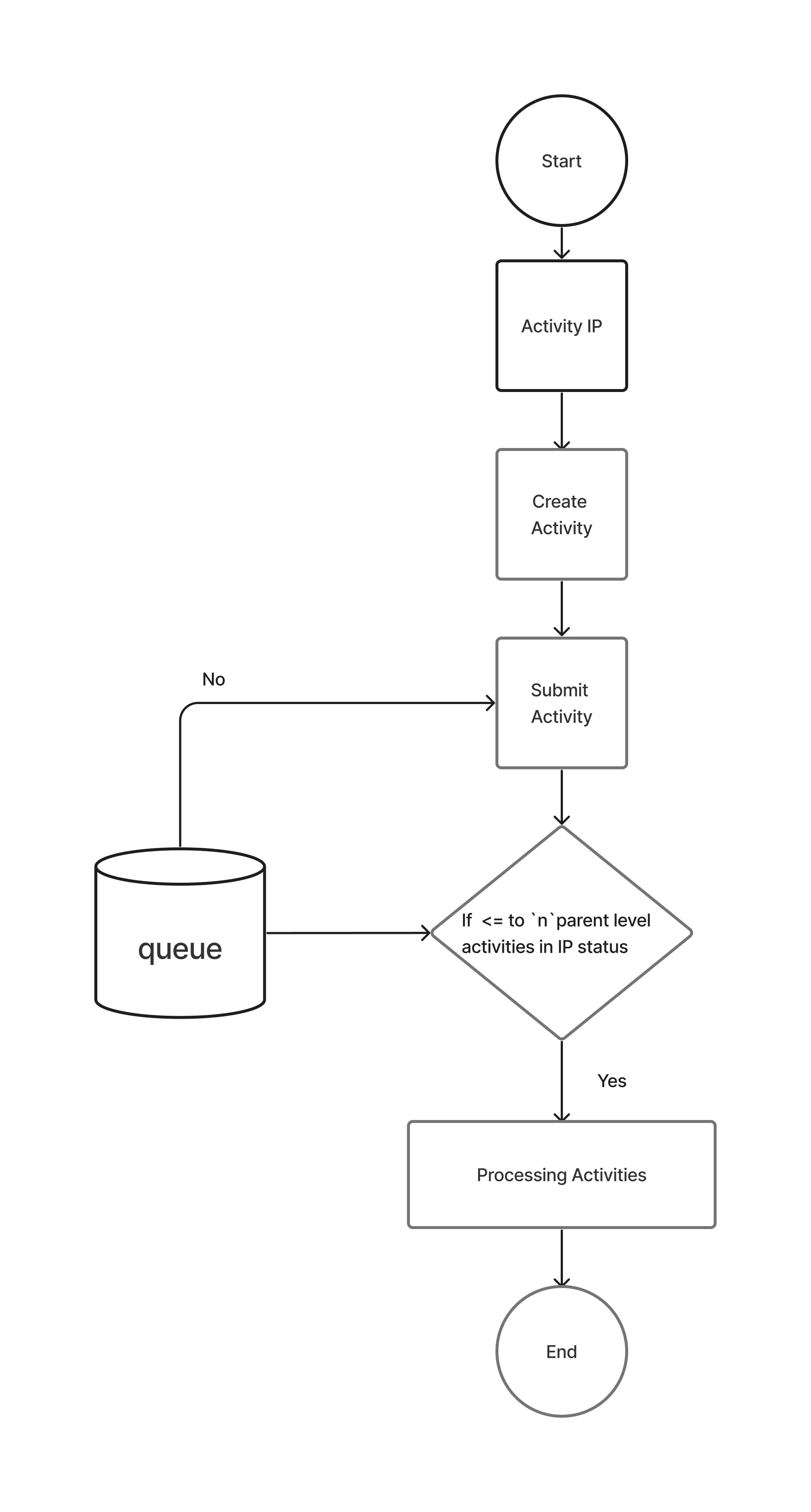

All global activities run in parallel. For example, multiple policy in operations that submit and run policies in parallel, each policy creates a PROCESS_POLICY activity. The severe contention in coherence results in an unresponsive server. The throttling process allows multiple parent-level activities to run in parallel, leading to a stable application. The following properties help with this:

thrttling

  • ohi.processing.throttle.activities.task.priority.{0}.{1} This property sets priority of the task in a queue according to an activity type and level. The first placeholder is the activity type code and the second placeholder is the activity level.
This property decides the priority for processing an activity. For example, setting the priority of PROCESS_POLICY activity higher than CALCULATE_PREMIUM activity results in PROCESS_POLICY to process earlier than the CALCULATE_PREMIUM activity. Following are the properties to set priority on the two activities:
  • ohi.processing.throttle.activities.task.priority.CALCULATE_PREMIUM.GL=4
  • ohi.processing.throttle.activities.task.priority.PROCESS_POLICY.GL=2
The priority ranges from zero to nine with zero being the highest and nine being the lowest. By default, all activities or tasks have zero set as their priority, which is the highest unless otherwise defined.
  • ohi.processing.throttle.activities.task.dequeue.delay.{0}.{1} This property sets the time in seconds to delay an activity for a requeue. The first placeholder is the activity type code and the second placeholder is the activity level.
This property defines the delay with which a task re-queuesfor processing. By default, the delay is three seconds which this property can override.
Let us assume, calculate premium activity takes five minutes on an average to complete. Also, twenty calculate premium run in parallel for different group clients with a default throttling size of eight. In this case, only eight calculate premium activities process in parallel and the other twelve remain in queue. The remaining twelve queued activities dequeue themselves every three seconds to check if there is room to process newer activities. Increasing the delay time reduces these frequent checks and thereby reduces the overhead.
Ensure to not change the delay of these properties. The following is a way to delay the dequeue process by ten seconds for the calculate premium activity:
  • ohi.processing.throttle.activities.task.dequeue.delay.CALCULATE_PREMIUM.GL=10
These properties are configurable through an API or via the properties file.
