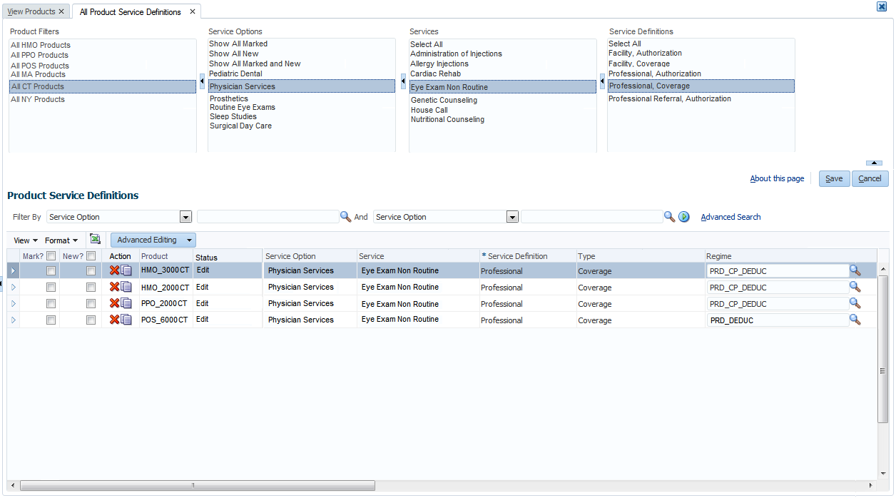

The page is divided into two areas:
An area to provide search dimensions used to limit the number of displayed product service definitions
A product service definitions area; used to configure the product service definitions contained in the products
Because the application can contain a very large number of product service definitions, the user is supposed to provide enough filter criteria to limit the number of queried product service definitions to a maintainable set.
Results are not paginated by a configurable number of rows. If a product filter is used that does not provide a sufficient amount of criteria, a very large result set may be returned affecting page performance. |
Product Service Definition Filters
From left to right the following filters are displayed:
Product Filters; limits the results to all products in the selected filter
Service Options; limits the results to all product service definitions that underlie the selected service option or to one of the "Show All" options
Show All Marked; displays all product service definitions that have the "Marked?" indicator set to true
Show All New; displays all product service definitions that have the "New?" indicator set to true
Show All Marked and New; displays all product service definitions that have the "Marked?" and "New?" indicators set to true.
Services; limits the results to all product service definitions that underlie the selected service. The "Select All" option encompasses all services displayed in the filter
Service Definitions; limits the results to all product service definitions defined for the selected service definition. The "Select All" option encompasses all service definitions displayed in the filter
The filter functionality is used in combination with the quick and advanced search. One value must be selected in each of the filters, in addition extra conditions can be entered in the quick or advanced search. The standard "search" icon will start a search using the criteria entered in the filter and the search.
Selecting an option in one of the filters automatically refreshes the options in the other filters so that it is only possible to create logical combinations. For example, if the "Show All Marked" option is selected in the service options filter, both the services and service definitions filters only display the "Select All" option.
Product Service Definitions
This part of the page is for a large part identical to the Setup Product page. All fields that are displayed in the setup product page are also displayed in this page, but with a few differences.
The "+" icon, used to create new product service definitions, is not used in the page, this can only be done with the "Add Service Definitions to Product" advanced editing feature
A "Mark?" field replaces the standard select row check-box. It serves the same function with one difference, the value in the "Mark?" field can be stored. This allows the user to create a custom set of product service definitions.
A "New? field, product service definitions that are created in this page using the the "Copy Selected Rows" feature will have this field checked. The user can manually check or un-check the "New?" field. The value in the "New?" field can be stored.
A field that indicates of which product the product service definition is part of.
A field that indicates the status of the product of which the product service definition is part of.
The service definition field is view only in this page.
Product service definitions created with this page have the "Mark?" field checked by default. Copied records will have the "Mark?" and "New" fields checked.
