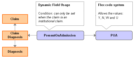

Scenario 2
Whenever a diagnosis is specified on an incoming institutional (hospital) claim, the user wants to know whether or not the diagnosis was present on admission (or whether the diagnosis was made after admission). This piece of information is an attribute of a diagnosis within the context of a particular claim, that is, the same diagnosis code can be present on admission on one claim, while not present on admission on another claim. For this reason the table that connects a claim with a diagnosis has to be extended with the indicator.
A 'present on admission' (POA) indicator is only applicable to institutional claim diagnoses and not for other types of claims, such as dental claims or professional claims. The user wants to ensure this through the correct setup.
The user sets up a flex code system named 'POA' that allows the following values:
N, meaning 'not present',
Y, meaning 'present',
U, meaning 'unknown',
W, meaning 'clinically undetermined'.
Specifics on how to set up a flex code system are detailed in Code definitions. The user creates a new dynamic field usage for the 'Claim diagnosis' table, that is, the table that connects a diagnosis with a claim.
The dynamic field usage is set up as follows:
Name - PresentOnAdmission
Display name - 'Present on admission?'
Type - Code
Flex code system - POA
Condition - INST
Note that any fields that are not mentioned are left blank or unchecked. The condition 'INST' is a dynamic logic condition that takes the 'claim' to which the 'claim diagnosis' is attached and ensures that it is an institutional claim. This way, the user ensures that only institutional claims have a POA indicator on their attached diagnoses.
