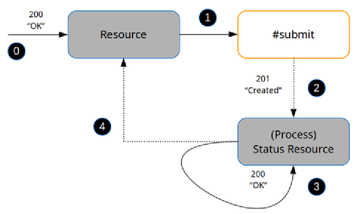

From a high level this use case can be visualized by the following diagram.
This shows an initial stage of an Authorization resource that was returned from some prior interaction at 0.
The server has embedded the link relation for authorization:submit, with which a consumer of the API can interact with at 1.
The server acknowledges this submission with a HTTP 201 (Created) message and sets a HTTP Location header to the Status resource at 2.
The Status resource can subsequently be refreshed (i.e. polled for) to track progress at 3 by a consumer of the API. A consumer can interrogate the Status resource’s mandatory "completed" attribute to find out whether it is (still) useful to refresh the Status resource.
Note that the Status resource will have a link relation of rel="related" to identify the related resource that was affected by a completed process - see 4.
In case of processing errors - i.e. "progress" attribute failed - the Status resource contains an error property, which provides the detail of the issue(s).
