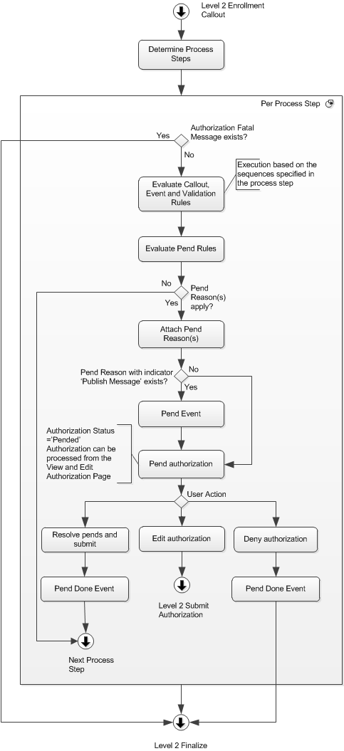

The processing flow is shown in the image below:

The subsequent sections describe the processing details of each type of Rule Step. Once all the Rule Steps are executed successfully the system marks the process step as complete and moves to the next configured process step. The system moves to the finalize step after the last process step is executed.
Also, the system may move to the finalize step without executing the next configured process steps if there is a message of severity 'Fatal' on the authorization. However, presence of an authorization message of severity 'Fatal' does not stop the subsequent Rule Steps from getting executed within a process step.

During processing of a process step - the callout, event and validation rules are evaluated, based on the configured execution order (sequence) and then all the pend rules are evaluated. A rule step is not evaluated when the indicator enabled on the rule is set to 'No'.
The execution of a rule must be completed successfully (that is without a technical error) before the next rule (this can be a callout rule, an event rule, a validation rule or the pend rule(s)) is executed.

Pend Rule
In certain circumstances it might be necessary to pend an authorization for manual intervention, for example when a very high value is requested or if the person or object does not have an enrollment product for all the procedures for which the authorization is requested.
The system evaluates all the configured pend rules for a process step. The pend rule describes the circumstance in which an authorization pends. When the specified fixed criteria on the pend rule are satisfied and the dynamic logic condition (if specified) evaluates to true, the pend is said to be applicable. The pend rule is not evaluated if the suppressed when fatal indicator is set to 'Yes' and a fatal authorization message exists.
If the pend rule applies, the pend reason is attached to the authorization. Exceptions to this behavior are
  1. When the reattach indicator on the pend reason is set to 'No', then the system looks at the authorization pend history and checks if the authorization has ever been pended before for the same pend reason (irrespective of the process step) and has been resolved by the user. If such a history exists then the pend reason is not attached to the authorization.
  2. When the pend reason already exists for the current process step from earlier processing iterations, then the same pend reason is not attached again.
The system always keeps pend reasons that are not resolved during earlier processing iterations even if the pend rule does not apply during the reevaluation of the process step.
When one or more pend reasons exist for the authorization for the current process step, the system checks if any of these pend reasons are required to be published to an external system (publish message indicator set to 'Yes'). If so, the system communicates the pend reasons with a publish message indicator set to 'Yes' in the pend event message. The pend event message is sent out through Outbound Restful Service Invocation. The system then sets the status of the authorization to 'Pended' and adds a status history record and pend history records for all pend reasons that were raised in the current process step.
The processing gets suspended so that a user can manually intervene in the processing of the authorization.
User actions and processing
In the View and edit authorizations page a user can select one of the following actions (links) when authorization is pended.
Resolve pends and submit - This action results in the removal of the authorization pend reasons related to the process step and the authorization pend history records get updated as resolved. The authorization status is set to 'In Process'. If the process step where the authorization got pended is the last step, then the processing moves to the finalize step otherwise the system evaluates the next process step.
Deny authorization- This action results in the removal of all the authorization pend reasons. The authorization pend history records get updated as resolved. The processing moves to the finalize step.
Edit authorization - The authorization is brought to the status 'Change'. If the authorization is set back to the 'Change' status in the user interface page, the pend reasons that are attached to the authorization remain on the authorization (unresolved) and new pend history records are created for all attached pend reasons. If the authorization is set back to the 'Change' status through the integration point, all authorization pend reasons are removed; they are not marked as resolved in the authorization pend history.
When the user submits or denies an authorization, the system sends out a 'Pend Done' event message to the external system through Outbound Restful Service Invocation, if any of the pend reasons were published to an external system (publish message indicator set to 'Yes') so that the external system can take appropriate actions.
