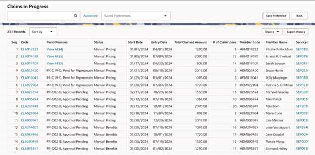

Components
Pages using the Report Page template have the following components.
Entity Name and Results Count
Non-configurable, default functionality.
The plural form of the entity name is displayed above the data grid, with the total count shown next to it.
If a saved search preference exists, its details are displayed.
The count is only displayed after a search is performed.
If no results match the search criteria, a message indicating that no rows were found is displayed by the results component.

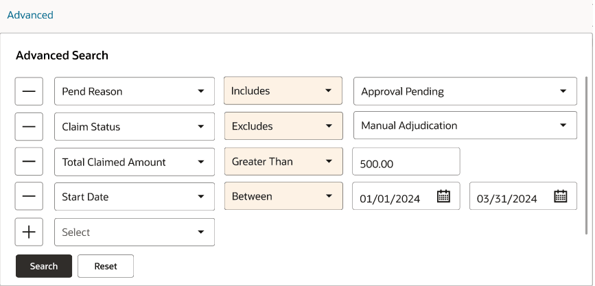

Advanced Search
Mandatory component.
Displayed as a hyperlink that displays the advanced search dialog.
Enables search on a combination of attributes.
Advanced Search allows searching based on specific or multiple attributes using various operators like Equal To, Not Equal To, Like, Between, and more.
Date attributes support
BetweenandNot Betweenfor date ranges, with flexible date inputs. -
String and Text attributes support operators such as Equal To, Not Equal To, and Like, while ENUM, LOV, and refType attributes use Equal To, Not Equal To, Includes, and Excludes.
For more details, see the Advanced Search component.
Advanced Search with Operators
An Advanced Search allows you to search based on specific or multiple attributes, using various operators:
An Advanced search enables the search on specific attributes or on multiple attributes with a combination of operators.

The following image illustrates how the Advanced Search can be configured.
Example
"advancedSearch": {
"properties": [
"name": "agent_code",
"sequence": 3,
"refType": {
"type": "agents"
"refTypeMapping": [
"type": "agents",
"properties": [
"name": "code",
"viewColName": "agent_code"
"name": "name",
"viewColName": "agent_name"

Data Grid
Used to display the search results in the form of a data grid.
If no results match the search criteria, the results component displays the message, No rows were found.
Data Transfer History displays the history of previous data transfers for seven days.
The latest saved search preference is loaded if available.
The Data Grid component consists of the following sub-components.
Actions (Data Grid)
Data Transfer: Used to transfer the report data to a specified format.
Data Transfer History: Displays the history of previous data transfers.
Rows: Can be configured with the following component.
Columns: Each property defined in this section forms a column in the data grid.
