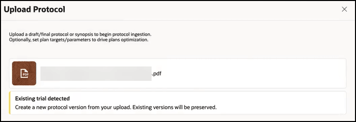

  5. When the ingestion process completes, if the new upload contains the same planning-specific elements and key study information, such as Study Type, Protocol ID, Phase, Therapeutic Area(s), Indication(s), and Product(s), an Existing trial detected message appears in the Upload Protocol panel. For example:
    Upload Protocol panel - Shows the Existing trial detected message
