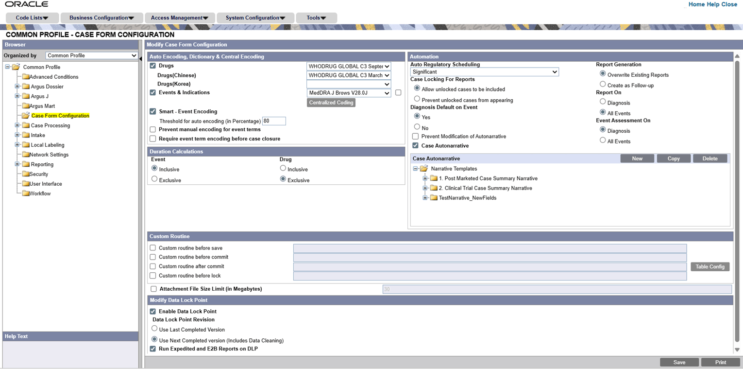

Configuring Case Form (System Management)
This screen enables you to configure Common Profile Switches that affect the behavior of the Argus application.
Tip:
The Common Profile folder appears in a tree-view on the left panel. The components are categorized as folders. Each folder contains all the field labels associated with that section.
To view the list of field names associated with the Case Form Configuration section, click the Case Form Configuration folder in the left panel. The field names associated with Case Form Configuration appears in the right panel.
The Case Form Configuration dialog helps you customize the case processing activities in order to meet the company's requirements. The Administrator can configure the following items by using the Case Form Configuration dialog shown in the following illustration.
Case Form Configuration screen
Coding Web Service
The Case Processing Dictionary Browser common profile switches are segregated by enterprises to allow different configurations for different enterprises. However, the URL and other configuration for WHO Drug and MedDRA web services remain in configuration XML on the Web Servers as per existing design and hence remain common across all enterprises.
In a multi-tenant installation, if the provider chooses to operate using Coding via web service, they should use the same web service across all enterprises.
Auto Encoding, Dictionary and Central Encoding
To enable the use of standardized medical terminology throughout the adverse event reporting process, dictionaries can be used to encode certain terms in the Case Form.
The dictionaries that will be used to encode drugs, Events & Indications, and events can be specified in the Autoencoding section of the Case Form Configuration dialog.
Field Descriptions
The following table lists and describes the fields in this section.
Field or Control Name Description

Automation
The Automation section enables the user to generate an Auto narrative based on one of the templates configured by the method described in this topic.
Field Descriptions
The following table lists and describes the fields in the Automation dialog box.
Auto Regulatory Scheduling
This enables the user to configure the manner in which Oracle Argus Safety handles the Auto-scheduling of Regulatory Reports.

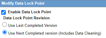

Modify Data Lock Point
This section is displayed only if the DLP_SETUP switch is set to ON in the database schema in the CMN_Profile_Global table.
Enable Data Lock Point
Enables you to activate a data lock point by selecting this checkbox. If this checkbox is not selected, the Modify Data Lock Point section displays only this field as editable.
Use Last Completed Version
Enables you to use the last completed version.
Use Next Completed Version (Includes Data Cleaning)
Enables you to use the next completed version that includes data cleaning.
Run Expedited and E2B Reports on DLP Enables you to execute expedited and E2B reports on DLP database and these reports are scheduled on a previous aware date.
