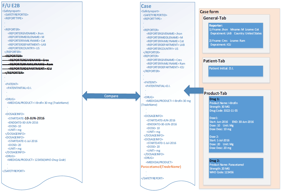

Comparison and Data Evaluation/Update for an Incoming Follow-up Report
As per the current implementation, the application provides the user with the following difference views for comparing the Incoming ICSR file in the ICSR format:
- The newly imported ICSR message.
- The ICSR message that was generated using the current case data against the ICSR profile for the importing agency.
- The ICSR file that was last imported to the case.
Support Deletion of Unwanted Data after Follow-up
As per the current comparison and data update logic, if two records are matched based on the key matching, the matching record is updated. In case there is no match found for the existing case record, a new entry is created for the newly incoming record. This leads to stale data in the case.
The ICSR comparison logic will support record level deletion of un-matching case data. Additionally, the deletion logic shall be configurable at the record level.
Flexibility in Primary Key Identification for Follow-up Records
As previously stated, the current comparison logic of incoming ICSR is driven based on the internal Metadata stored in an internal table, with limited flexibility for comparison key configuration. This logic will be made generic enough so that users can update the OOTB keys as per their use case.

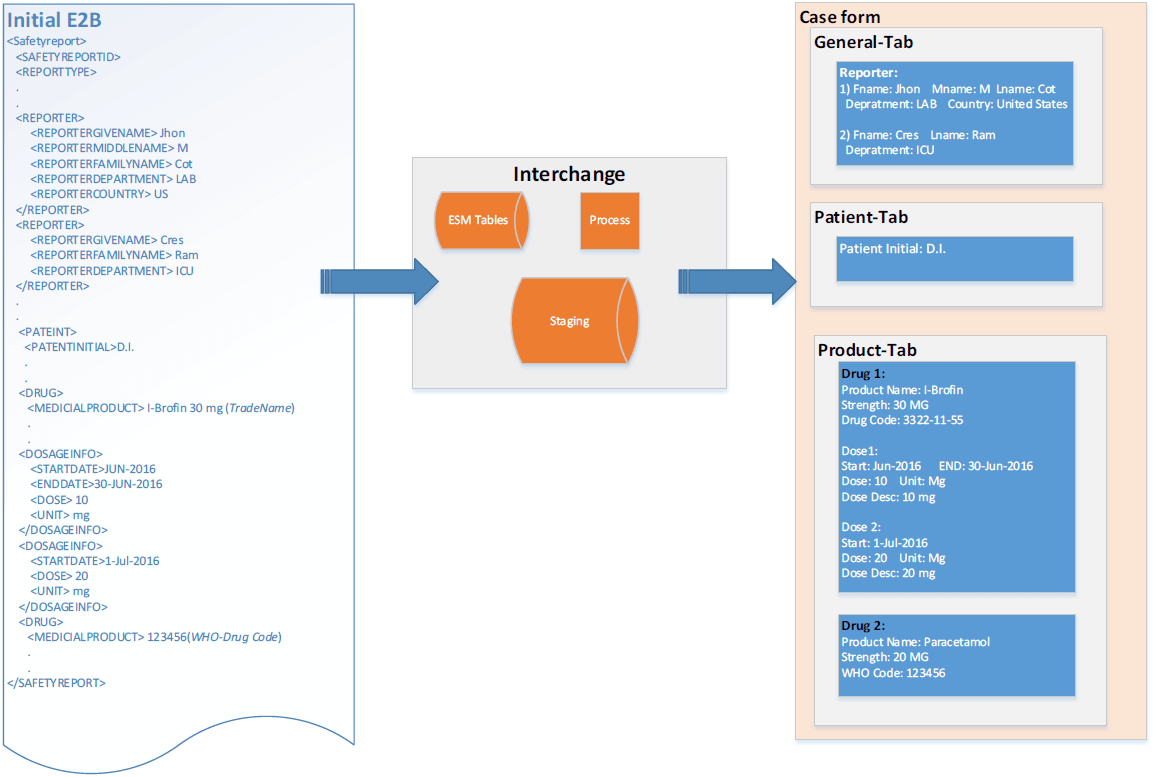

Use Case:
Initial E2B Initial Case
Follow-up E2B Accept as Follow-up
