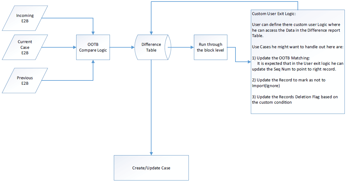

Custom Comparison
As part of the newly enhanced upon ICSR import Framework, a customization capability has been introduced in the Difference report building logic. As a result, a user can define their own custom logic over the OOTB difference report to control the comparison. The following flow chart depicts the functional flow for the Custom Comparison:Custom comparison
Since this comparison is a customizable logic, there can be several use cases.
The following is an example that describes some of the sample logics at a high level:
