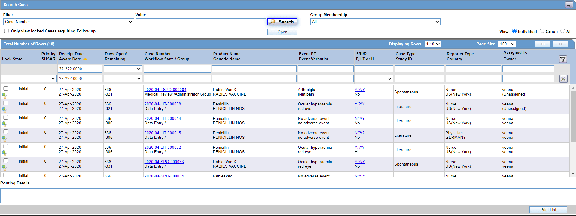

The Worklist > New and Worklist > Open also display a ! status beside Priority, denoting that the time remaining has exceeded the allocated time.

  • The Days Remaining Calculation in Worklist common profile switch enables you to select either of the following options:
    • Use earliest due date of reports pending submissions (default)
      When... ...populate Due Soon date based on:
      Auto-scheduling is done for the reports and the case contains scheduled reports.
      Earliest due date of the report.
      Auto-scheduling is done for the reports but the case does not contains any scheduled reports.
      Latest aware date and duration as specified in the Due Soon Duration (in Days) for Worklist Calculation common profile switch.
      Neither auto-scheduling is done for the reports nor likely to schedule a report.
      Auto-scheduling is not done for the reports but the reports are likely to be scheduled.
      Earliest due date of the possible reports.
    • Use latest aware date
      Auto-scheduling is done for the reports, and may or may not contain any scheduled reports.
