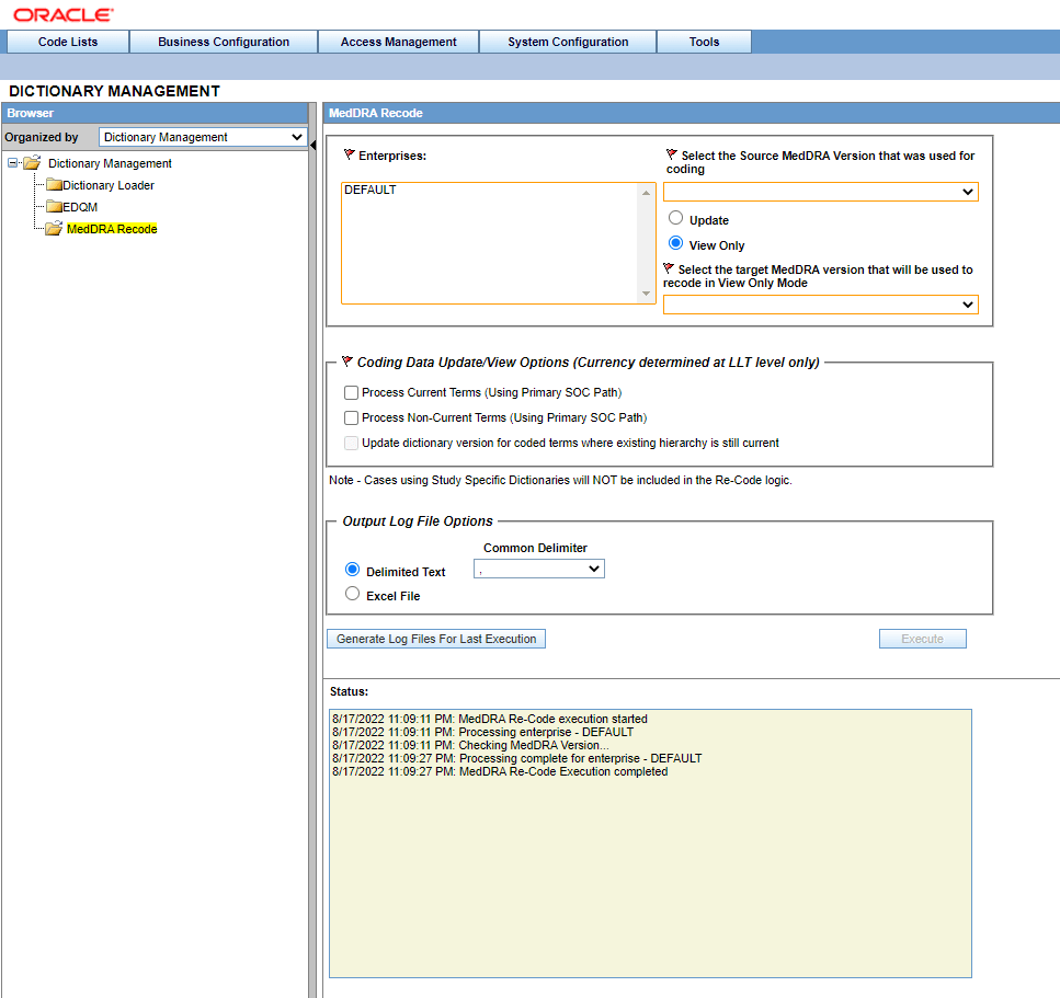

To recode the MedDRA terms:
- From Argus Console, go to Tools, click Dictionary Management and select MedDRA Recode.
- Select the enterprise. Multiple enteprises can be selected using the CTRL + click options.
- In the Select the Source MedDRA Version that was used for coding field, select the version that is to be recoded.
- Select:
- Update to recode the Argus events encoded in the selected MedDRA version to the MedDRA version selected in the system configuration in the Common Profile Switch.
- View Only to generate logs that can be used to evaluate the cases and fields that are affected by the recode. When this option is selected, the Select the target MedDRA version that will be used to recode in View Only Mode is displayed to allow you to select the target version for which you want to see the logs.
- Select to code either the current or non-current terms in the Coding Data Update/View Options (Currency determined at LLT level only) section.
- Click Execute.
The logs can be generated only for the last run of the recode.
For more information about the MedDRA Recode window, see MedDRA Recode field descriptions.
