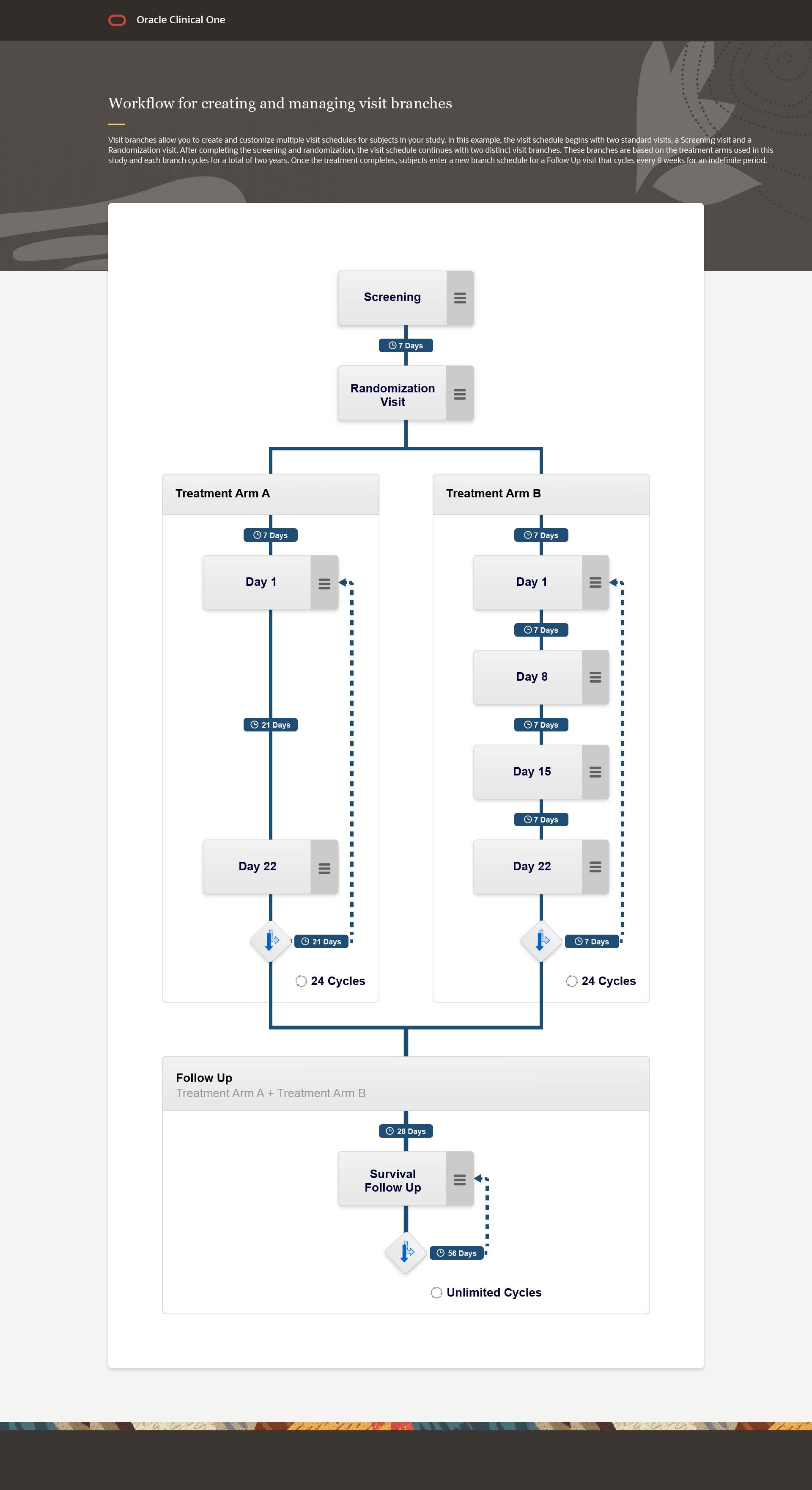

To help understand the workflow for creating branches, let's take a simple example. In this example, you have already created two scheduled visits that apply to all subjects, a screening visit followed by a randomization visit, for an oncology study. After the randomization visit, you want subjects to be scheduled using branches based on the treatment arm to which they are assigned. For simplicity, we'll call these Treatment Arm A and Treatment Arm B. The branch visits will cycle every 28 days for 24 cycles (over a period of two years). Once the treatment completes, you want all subjects to be scheduled for a series of follow up visits. The study ends with a study completion visit for all subjects.

A visual representation of visit branches defined for an oncology study
Figure 4-1 Visit branches in an oncology study
![Visit branches are new visit schedules Visit branches are new visit schedules](img/workflow_for_visit_branches.jpg)
