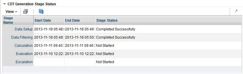

CDT Generation Stage Status
The CDT Generation Stage Status table displays the status of each of the CDT stages.
Click the Refresh icon to update the fields and see the latest status for each stage.
In cases where the status is either Failed or Stopped/Paused, or the run never completes, you should consult the database logs in RSE_LOG_MSG as well as the WebLogic console logs in your WebLogic domain in order to troubleshoot the problem.
You can use the status information to monitor the progress of each stage. It contains the following fields, which can be arranged and viewed, but not modified.
Table 2-1 CDT Generation Stage Status Fields
| Field Name | Description |
Stage Name |
A row exists in the table for each CDT stage that provides detailed status information. The five stages are Setup, Data Filtering, Calculation, Evaluation, and Escalation. |
Start Date |
The date and time when a run for the stage most recently started. |
End Date |
The date and time when a run for the stage most recently ended. |
Stage Status |
The current status of the stage: Not Started, Not Started (Scheduled for Later), Processing, Completed Successfully, Completed with Errors, Stopped/Paused, Cancelled, or Failed. |
The following provides an explanation of the different values for the status of a stage.
Table 2-2 Status Explanations
| Stage Status | Description |
Not Started |
This indicates that the stage has not yet been initiated. This can occur when you first begin to create a CDT or when you update an existing version. |
Not Started (Scheduled for Later) |
The stage is scheduled to start after the previous stage is complete. |
Processing |
This indicates that the stage is currently being processed. |
Stopped/Paused |
This indicates either that the stage has been stopped by the application or that the user has chosen to stop the process (for example, to make a change to an option). In the latter case, once any background processing has stopped, the user can re-run the stopped stage. |
Completed Successfully |
This indicates that the stage has been successfully processed. |
Completed with Errors |
This indicates that the stage was able to complete the processing of all requested CDTs, but one or more CDTs encountered errors during the run and were not able to complete successfully. This most commonly occurs when the data used for a CDT is not available or is too sparse to produce a result. |
Failed |
This indicates that a problem occurred during the processing. If the failure occurred during the Calculation stage, and only a few CDT results did not produce a CDT score, then the user can continue without those results since pruning will remove them. If the failure occurred during any of the other stages, the user must re-run the stage. |
Cancelled |
This indicates that the database has cancelled the execution of the stage either because of missing data or an exception. The user should review the RSE_LOG_MSG log to determine the problem. |

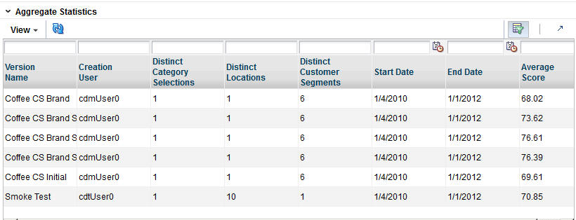

Aggregate Statistics
The Aggregate Statistics table displays statistical details about the existing CDT versions.
Click the Refresh icon to update the fields and see the latest information in this table.
Each existing version has a row in the table. The table contains the following fields, which can be arranged and viewed, but not modified.
Table 2-3 Aggregate Statistics Fields
Version Name |
User-created name that identifies this CDT version. The name must be unique to the user. |
Creation User |
The login name of the person who created this version. |
Distinct Category Selections |
The number of categories associated with this version. |
Distinct Locations |
The number of locations associated with this version. |
Distinct Customer Segments |
The number of customer segments associated with this version. |
Start Date |
The beginning date associated with the CDTs in this version. |
End Date |
The end date associated with the CDTs in this version. |
Average Score |
The average of the CDT scores for a version. A CDT score ranges from 0 to 100. A higher value indicates a better score. |

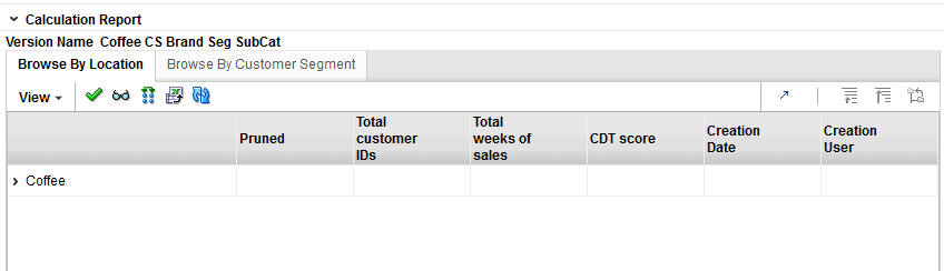

Calculation Report
The Calculation Report displays the CDT results for the indicated version from the last successful run, if one has occurred.
Here you can review information by Location or by Customer Segment. You can also set a version as complete, view and edit a CDT, or compare two CDTs.
The Calculation Report contains the following fields:
Table 2-4 Calculation Report Fields
Partition |
A partition is the combination of category, segment, and location. The column identifies the names of all nodes in the tree structure in the table. The node type may be either category, location, or customer segment. |
Pruned |
The number of CDTs removed from the list of usable CDTs. CDTs are removed that do not meet the filtering thresholds. During the Escalation stage, the escalation process makes adjustments for the CDTs that are removed. |
Total Customer IDs |
The number of customers used in the calculation of the CDT. |
Total Weeks of Sales |
The total number of weeks of sales used in the calculation of the CDT. This provides an indication of the amount of sales data used in the calculation. All the CDTs in a given version should have a similar value; if this is not the case, the results should be evaluated. |
CDT Score |
A confidence score assigned to help in assessing the quality of the CDT. A CDT score ranges from 0 to 100. A higher value indicates a better score. |
Creation Date |
The date when the version whose data is displayed was created. |
Creation User |
The login name of the user who created the version. |

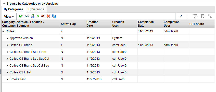

Set Version as Complete
Each partition must have an active CDT. The active CDT is used by other applications that require a CDT.
All CDTs within a version are activated when you click Set Version as Complete.
If a CDT exists in more than one version, then the most recently activated version takes precedence.
If a version contains multiple categories and is Complete and then a different version with a partial overlap of categories is later marked as Complete, only the overlapping categories are replaced in the new version.
If a version is overwritten, then the CDTs in that version are no longer active.
When a CDT is at risk of going from active to inactive, you will see a warning message.
To determine whether or not a CDT is active, go to the Manage CDTs tab. The Browse by Categories or by Versions table displays a flag that indicates whether or not a CDT is active.

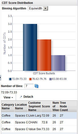

CDT Score Distribution Histogram
The CDT Score Distribution histogram displays, for the current calculation and the current user, the range of CDT scores and their frequencies. CDT scores range from 0 to 100; a higher number indicates a better score. You can use the information in this histogram to assess the quality of your CDTs.
For detailed information about using the histograms, see Getting Started..
Below the histogram you see a table that provides details about the histogram. This information can help you assess the quality of a CDT. Click on a specific bin in the histogram to populate the table with information about that bin. You see a list of all the specific partitions for the bin, along with the score for each, the number of weeks of data used to calculate the score, and the number of tree nodes for each partition for the selected bin.
Table 2-5 CDT Score Distribution Fields
Category Name |
The category name of the partition for the specific CDT score. |
Location Name |
The location name of the partition for the specific CDT score. |
Customer Segment Name |
The customer segment name of the partition for the specific CDT score. |
Score |
The CDT score for the defined partition. A CDT score ranges from 0 to 100. A higher value indicates a better score. |
Number of Weeks |
The number of weeks of data used to calculate the CDT score. |
Tree Node Count |
The number of tree nodes present in the CDT tree structure used to calculate the CDT score. |

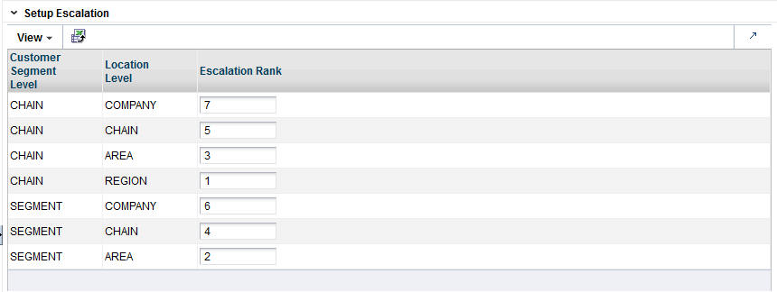

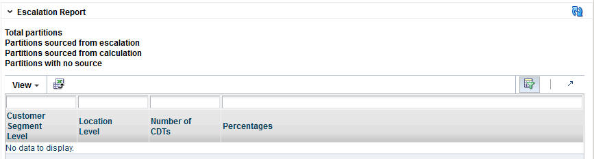

Escalation |
Set the escalation path for the CDT. Use the Escalation Report to evaluate the results of the escalation. |

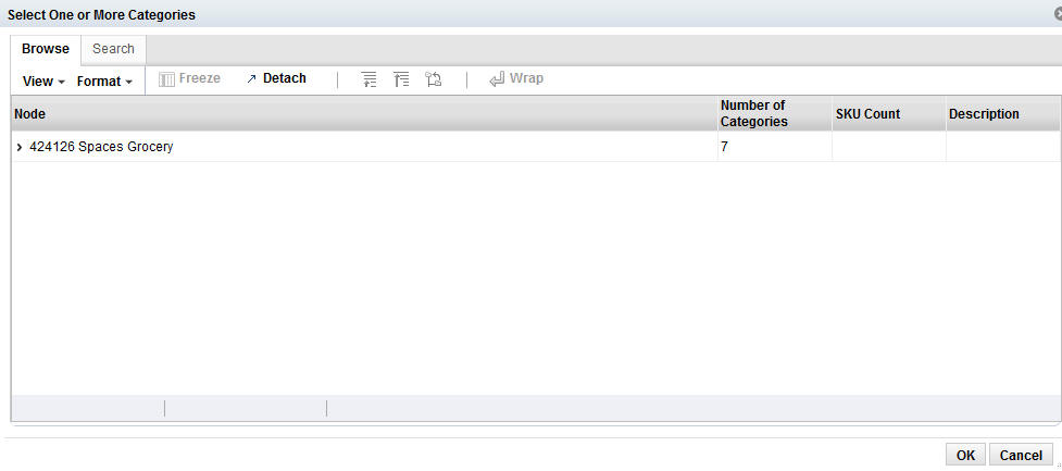

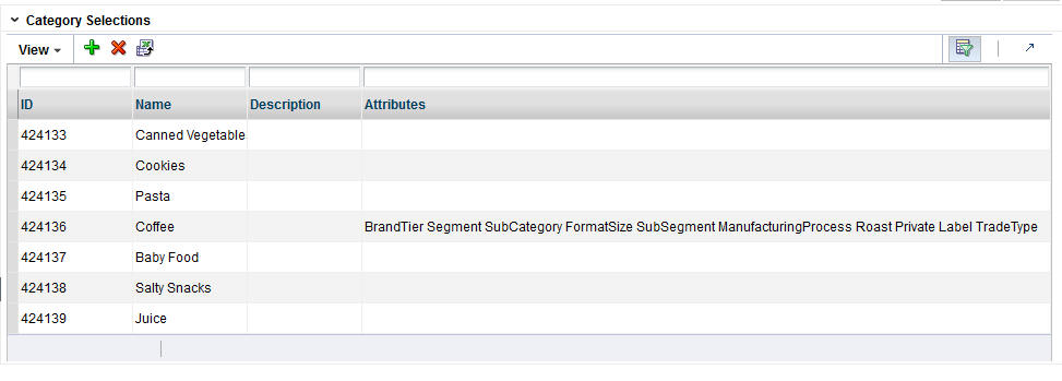

Category Selections
Use this table to add categories you want to include in the CDT calculation or delete categories that you want to remove from the CDT calculation.
To display a list of available nodes and the categories included in those nodes, click the Add icon. You see the Select One or More Categories dialog box, which contains two tabs, Browse and Search. You can use either tab to find the categories you are looking for.
The Browse tab displays a table with the following fields:
Table 2-7 Category Selections: Browse
Partition |
The node tree structure can be expanded in order to view its categories. |
Number of Categories |
The number of categories within the node that has been selected. The number can help you understand the amount of processing required for the calculation. |
SKU Count |
The number of SKUs in a category. A category with too few SKUs may not produce good CDTs. |
Description |
A description that provides additional information about the category. |
Select the category or categories within the node that you want to be part of CDT and click OK.
The Search tab displays a table with the following fields:
Table 2-8 Category Selections: Search
| Field Name | Field Description |
ID |
An external code used to identify the category in other systems such as CMPO. |
Name |
The category name. |
Short Description |
Level Description |
A description of the level of the merchandise hierarchy that the node belongs to. |
Select the category or categories within the node that you want to be part of the CDT and click OK.
Your selections are displayed in the Category Selections table.

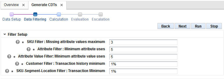

Data Filtering
The Data Filtering stage applies to all the categories and time intervals that you select in the Data Setup stage.
Process
Here is the high-level process for setting up and running data filtering.

Filter Setup
You configure the following filters in order to filter out data you consider unacceptable for the calculation of the CDT. Note that the two attribute filters listed in Table 2-10 are stored and used during the Calculation stage. You also set additional data filtering parameters in the Calculation stage.
Table 2-10 Data Filters
| Data Filter Name | Data Filter Description |
SKU Filter: Missing attribute values maximum |
Each SKU is defined by its attribute values. If a certain absolute value for the attribute values is not defined, then the product definition is not accurate. A SKU with too many missing attribute values should be filtered out. The default value is 25 for the total attribute values (that is, a SKU with greater than 25 missing attribute values is not included in the calculation of the CDT). |
Attribute Filter: Minimum attribute uses |
An attribute that is used by only a few SKUs should be filtered out. The default value is an absolute value of 5 for the total SKUs in the category (that is, the data for an attribute that is used by fewer than five of the SKUs is not included in the calculation of the CDT). This filter does not remove t-log level data but instead removes the attribute and attribute values from the CDT creation process. |
Attribute Value Filter: Minimum attribute value uses |
An attribute value that is used by only a few SKUs should be filtered out. The default value is an absolute value of 5 for the SKUs in a category (that is, the data for an attribute value that is used by fewer than five of the SKUs is not included in the calculation of the CDT). This filter does not remove t-log level data but instead removes the attribute and attribute values from the CDT creation process. |
Customer Filter: Transaction history minimum |
Customers with short transaction histories are considered outliers. You assign a percentage value that is applied to the median number of transactions for all customers. Such customers are filtered out. The default value is 10% (that is, a customer who has fewer than 10% of the median number of transactions for all customers is not included in the calculation of the CDT). |
SKU-Segment-Location Filter: Transaction minimum |
SKUs that have few transactions for a given location-segment partition are considered outliers. You assign a percentage value that is applied to the median number of transactions for the SKUs in a specific partition. Such transactions are filtered out. The default value is 10% (that is, a SKU that is involved in fewer than 10% of the median number of transactions for a specific partition is not included in the calculation of the CDT). |
Once you have configured the filters, click Run to start the filtering process.

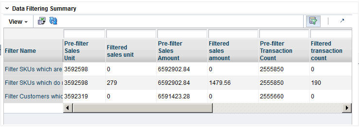

Data Filtering Summary
The following information is provided after the filtering is complete and quantifies the amount of data filtered out for the three indicated filters for sales units, sales amounts, transaction counts, SKU counts, and customer counts. Use this information to assess the effects of the pruning.
Table 2-11 Filter Data Summary Fields
Filter Name |
The following filter names are listed: Filter SKUs that are missing too many attribute values. This maps to the SKU Filter: Missing attribute values maximum in the Filter Setup. Filter SKUs that do not have enough sale transaction history. This maps to the Customer Filter: Transaction history minimum in the Filter Setup. Filter Customers that do not have typical transaction history. this maps to the SKU-Segment-Location Filter: Transaction minimum in the Filter Setup. |
Pre-filter Sales Unit |
Amount prior to the application of the filter. |
Filtered Sales Unit |
Amount remaining after the application of the filter. |
Pre-filter Sales Amount |
Filtered Sales Amount |
Pre-filter Transaction Count |
Filtered Transaction Count |
Pre-filter SKU Count |
Filtered SKU Count |
Pre-filter Customer Count |
Filtered Customer Count |

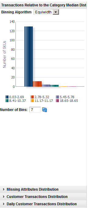

Data Filtering Histograms
The following histograms illustrate the effects of filtering. You can use the information displayed in the histograms to adjust the configuration of the filters in order to eliminate outlier data. If you modify the filters, you must re-run the stage.
Table 2-12 Filter Histograms
| Histogram Name | Description |
Transactions Relative to the Category Median Distribution |
Displays the number of transactions relative to the category median for a SKU's category. |
Missing Attribute Distribution |
Displays the number of attributes that have missing values per number of SKUs. |
Customer Transaction Distribution |
Displays the number of transactions in historical data per number of customers. |
Daily Customer Transaction Distribution |
Displays the relative number of transactions per day per number of customers. |
Figure 2-11 CDT Transactions Relative Histogram
Description of "Figure 2-11 CDT Transactions Relative Histogram"
Once you are satisfied with the pruning results, click Next to go to the Calculation stage.

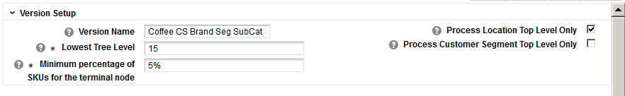

Version Setup
At the top of this stage you see three text boxes and two check boxes that you use to configure the levels at which the calculation occurs.
Table 2-13 Calculation Stage: Fields
Version Name |
Assign a name to each version of a CDT calculation. This allows you to create and save more than one version of a CDT. The version name you assign here is used in the Calculation Report, Aggregate Statistics table, and in the Manage CDTs tab. Version names can be re-used; however, if the version name in question has active CDTs, then you will see a warning that the active CDTS will be removed from the version if you do re-use the version name. |
Lowest Tree Level |
Use this option to define the maximum number of levels of CDTs to be calculated. The default value is 15. The number of levels in a CDT can at most be equal to the number of attributes used by the SKUs in the category plus 1. (The number 1 is used for the top level of the tree.) When determining the maximum number of levels, you should consider how many attributes should be represented in the tree. (For example, if you only want to see the top six attributes in the CDT, then set the lowest level to 7.) |
Minimum Percentage of SKUs for the Terminal Node |
Use this option to make sure the terminal nodes have a sufficient number of SKUs. For example, if the current CDT partition contains 100 SKUs, then any one node in the tree containing fewer than 5 SKUs will be considered a terminal node and the tree will not expand further along that branch of the tree. |
Process Location Top Level Only |
Check this option if you want CDTs to be calculated for the Location Chain only. You can select this option in order to decrease the amount of time it takes the system to perform the calculation. |
Process Customer Segment Top Level Only |
Check this option if you want CDTs to be calculated for the Customer Segment Chain only. You can select this option in order to decrease the amount of time it takes the system to perform the calculation. |

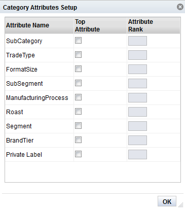

Category Attributes Setup
The application determines a specific ranking order for the category attributes. You can optionally change this order and create your own ranking of the attributes for a category by ordering the attributes from most important to least important. The Category Attributes Setup table lists the categories you are calculating CDTs for. Use this list to select a category to edit.
Click the Edit icon to access this functionality. You can adjust the ranking for all the attributes or a subset of the attributes.
The Category Attributes Setup dialog box contains the following fields. For each attribute you want to rank, select the Top Attribute check box and enter a value for the Attribute Rank. Click OK.
Table 2-14 Category Attributes Setup Dialog Box
| Field | Description |
Attribute Name |
Identifies the attribute. |
Top Attribute |
Check to enable ranking. This indicates that this attribute must be one of the first attributes in the resulting tree. This box is checked automatically for functional fit attributes and cannot be deselected. A functional fit attribute is one for which a customer cannot choose a different product with a different attribute value. For example, windshield wiper blades must be selected according to the car manufacturer's requirements. The numerical rank is optional. If you do not enter rank values, then the system will determine the order of all the top attributes first and then put any remaining attributes below the top attributes in the tree. |
Attribute Rank |
Enter a value for each attribute, starting with the value 1, to indicate the relative rank of the attribute. A value can be entered only if the attribute has been identified as a top attribute. You do not have to specify the rank if Top Attribute is checked. If multiple attributes are checked, then the system rank orders them. |

Calculation Report
The Calculation Report displays the CDT results for the indicated version from the last successful run (if one has occurred). Here you can review information by Location or by Customer Segment. You can also set a version as active, view and edit a CDT, or compare two CDTs.
Table 2-15 Calculation Report Fields
Partition |
Pruned |
CDT Score |
Creation Date |
Creation User |
The CDT Score Distribution histogram displays, for the current calculation, the range of CDT scores and their frequencies. CDT scores range from 0 to 100; a higher number indicates a better score. You can use the information in this histogram to assess the quality of your CDTs.
Below the histogram you see a table that provides details about the histogram. This information can help you assess the quality of a CDT. Click on a specific bin in the histogram to populate the table with information about that bin. You see a list of all the specific category name/location name/customer segment name partitions for the bin, along with the score for each, the number of weeks of data used to calculate the score, and the number of tree nodes for each partition.
Table 2-16 CDT Score Distribution Fields
Category Name |
Location Name |
Score |
Number of Weeks |
Tree Node Count |
The number of tree nodes used to calculate the CDT score. |
When you have finished with the calculation process, click Next to go to the Evaluation stage.

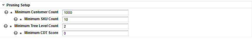

Pruning Setup
You can make changes by pruning the CDT based on the customer count, the SKU count, the tree-level count, and the minimum CDT score. To do this, enter a minimum value for each pruning filter.
Once you have completed setting up the filters, click Run to begin the processing. After you review the pruning results, you can change the values for the filters if you find it necessary. Once you make changes, you must run the stage again in order to see the results of your changes.
Table 2-17 Pruning Setup: Filters
| Filter Name | Filter Description |
Minimum Customer Count |
The minimum number of customers to be used in the CDT calculation. The default is 1000. |
Minimum SKU Count |
The minimum number of SKUs to be used in the CDT calculation. The default is 10. |
Minimum Tree Level Count |
The minimum number of levels to be used in the CDT calculation. The default is 2. |
Minimum CDT Score |
The minimum measure of the quality of a CDT to be used in the CDT calculation. The default is 25. |

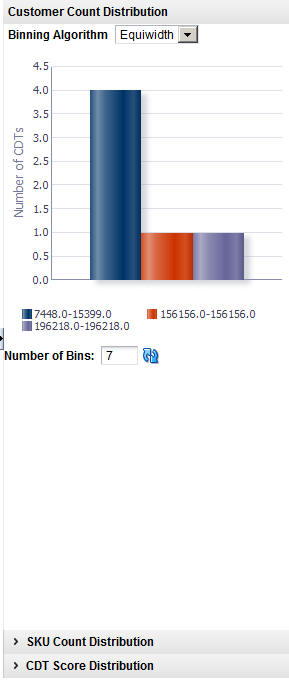

Customer Count Distribution |
Displays the number of CDTs for a specific customer count. |
SKU Count Distribution |
Displays the number of CDTs for a specific SKU count. |
CDT Score Distribution |
Displays the CDT score distribution. |
Figure 2-18 CDT Customer Count Distribution
Description of "Figure 2-18 CDT Customer Count Distribution"
When you have completed the evaluation of the results, click Next to go to the Escalation stage.
Escalation
The Escalation stage is used to fill in the holes for partitions whose CDTs were removed during pruning by setting up a search path through the segment hierarchy and the location hierarchy.
Process
Here is the high-level process for setting up an escalation.
Enter a series of numbers to indicate the escalation rank, which determines the order in which the escalation occurs.
Click Run to start the escalation process.
Review the escalation results in the Escalation Report.
After reviewing the results, if necessary, make changes to the escalation ranks and rerun the stage.
When you are satisfied with the results, you can complete the version and make the version active so that it is available for other applications to use.
Setup Escalation
Escalation occurs along the segment hierarchy and the location hierarchy. Here is an example of an escalation path:
The following fields are required to set up the escalation.
Table 2-21 Setup Escalation
Customer Segment Level |
Identifies the customer segment level in the escalation. |
Location Level |
Identifies the location level in the escalation. |
Escalation Rank |
Used to assign the ranks for the escalation, which determines the order in which the escalation occurs. |
Here is an example of an escalation path.
Table 2-22 Example of Escalation Path
| Segment Level | Location Level | Escalation Rank |
Segment chain |
Location chain |
8 |
Segment chain |
Region |
7 |
Segment chain |
Location area |
6 |
Segment chain |
Store cluster |
5 |
Segments |
Location chain |
4 |
Segments |
Region |
3 |
Segments |
Location area |
2 |
Segments |
Store cluster |
1 |
You fill in the order of numbers. Every row must have an ordering number, and no ordering number can be reused.
The escalation path is specific to the user and the current version that the user is working on.
The default ordering is to go up the location hierarchy first, and then up the segment hierarchy, as shown in the example above. The reason is that the segment hierarchy has only two levels, and so its top level is very general.
Escalation Report
The Escalation Report breaks down the numbers to provide counts for the number of partitions filled with higher-level CDTs and the number of partitions that have not been changed by escalation. In addition, the fraction of CDTs for each partition is displayed.
Table 2-23 Escalation Report
Total Partitions |
The number of partitions in the version. |
Partitions Sourced from Escalation |
The number of partitions removed during escalation. |
Partitions sourced from Calculation |
The number of partitions removed during calculation. |
Partitions with No Source |
A partition that does not have CDTs assigned to it because all CDTs related to the partition have been pruned. |
Identifies the customer segment level. |
Location Level |
Identifies the location level. |
Number of CDTs |
The number of partitions that are trying to have a CDT assigned. This is generally the number of customer segments by the number of locations. |
Percentages |
The percentage of partitions that have been assigned a CDT from a given escalation level. |

Manage CDTs Tab
The Manage CDTs tab is used to control which version of a CDT is active or approved. You can also access the functionality to edit a CDT or compare two CDTs.
You can find the CDT you are interested in by:
Browsing by categories or versions
Searching by version name or user name.

Browse by Category or Version
You can browse by category or version. The following information is displayed:
Table 2-24 Browsing by Category or Version
Version...Customer Segment |
Partition |
Active Flag |
Y = Version is active. N = version is not active. |
Creation Date |
Date on which version was created. |
Creation User |
User who created the version. |
Activation Date |
Date on which the version was made active. |
Activation User |
User who made the version active. |
CDT Score |

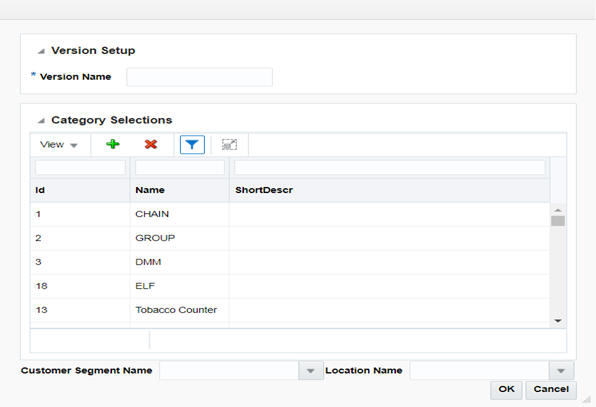

Create CDT
You can create a new CDT in two ways: by modifying an existing CDT or by defining a new CDT.
Click the Create CDT icon, shown in Figure 2-22.
If you want to create a new CDT based on an existing one, select the version you want to use as a template from the list of Category Selections. If you want to create a new CDT, skip this step.
Enter the Version Name for the new CDT.
Select the Product Category, Customer Segment Name, and Location Name.
Click OK. You see the CDT Editor.
You can use the CDT editor, described in "Using the CDT Editor", to edit the new CDT and add a child, make changes to a branch, or change the assigned names.
When you have finished creating and editing the new CDT, click Save CDT.
To approve the new CDT, click Approve CDT.
