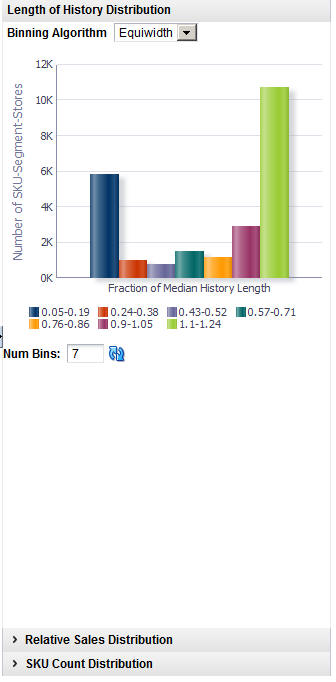

Data Filtering Histograms
The following histograms illustrate the effects of filtering. You can use the information displayed in the histograms to adjust the configuration of the filters in order to eliminate outlier data. If you modify the filters, you must re-run the stage.
For information about adjusting the display of the histograms, see the Getting Started.
Table 3-10 Data Filtering Histograms
Histogram Name | Description |
Length of History Distribution |
Displays the percentage of median history length relative to the number of SKU-segment-stores. |
Relative Sales Distribution |
Displays the percentage of median category sales relative to the number of SKU-segment-stores. |
SKU Count Distribution |
Displays the percentage of the median category SKU count relative to the number of segment-stores. |
Figure 3-9 DT Length of History Distribution Histogram
Description of "Figure 3-9 DT Length of History Distribution Histogram"

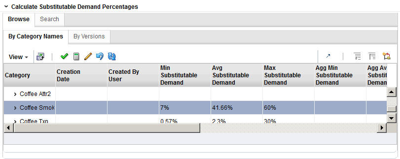

Calculate Substitutable Demand Percentages
You can vary the value for the maximum substitutable demand percentage and see the impact on selected categories or versions.
Figure 3-20 DT Calculate Substitutable Demand Percentages
Description of "Figure 3-20 DT Calculate Substitutable Demand Percentages"

Once you make a selection, click the Edit icon and enter an override value between 0% and 100% for the Maximum Substitutable Demand Percent. Click the Calculate icon to initiate the calculation. To revert the calculation, click the Revert icon.
Once you have determined the substitutable demand value you want, you can click the Complete icon to make the version active.
