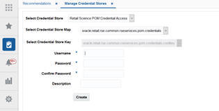

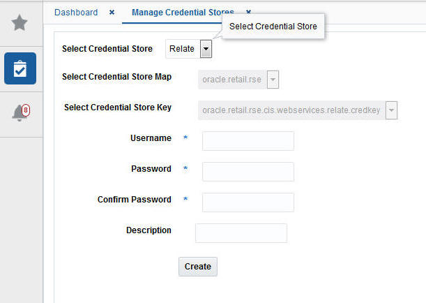

Credential Store
You can use the Manage Credential Stores screen, shown in Figure 17-1, to maintain ORCE credentials in the application.
Enter the following information into Manage Credential Stores:
Table 17-4 Manage Credential Stores Information
Field | Description |
Username |
Credential username created by ORCE to enable integration |
Password |
Credential password (at least one character) created by ORCE to enable integration |
Confirm Password |
Confirm password |
Description |
Credential store used for Customer Segment integration with Oracle Customer Engagement |

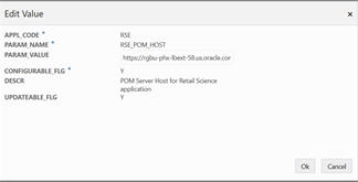

To ensure AIF application to Retail Insights integration configuration is correct, verify RSE_CONFIG configuration for POM Server details.Select Control & Tactical Center > Strategy & Policy ManagementFilter APPL_CODE as "RSE" and PARAM_NAME as "RSE_POM_HOST". Determine if the value set as part of the deployment is correct. If the host is not correct, update the entries.
Figure 17-2 Edit Value
POM Server Credentials
Select Control & Tactical Center > Manage Credential Store to provide POM ReST endpoints credentials for Basic Authentication. All the POM ReST endpoints use Basic Authentication, with the same credentials as those used to log into the POM application. See Figure 17-3 to provide credentials.
Figure 17-3 POM Server Credentials
Once the configuration is complete, AIF applications will start triggering jobs for Retail Insights.
