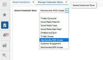

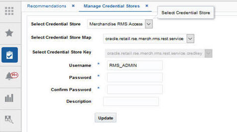

Figure 14-1 and Figure 14-2 show adding a username and password for the credential store.
Figure 14-1 Selecting the Credential Store
Description of Figure 14-1 follows
Description of "Figure 14-1 Selecting the Credential Store"
Figure 14-2 Adding the Username and Password for the Credential Store
Description of Figure 14-2 follows
Description of "Figure 14-2 Adding the Username and Password for the Credential Store"
