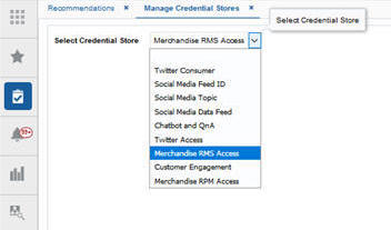

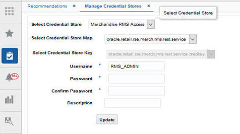

Figure 16-1 and Figure 16-2 show adding a username and password for the credential store.
Figure 16-1 Selecting the Credential Store
Description of "Figure 16-1 Selecting the Credential Store"
Figure 16-2 Adding the Username and Password for the Credential Store
Description of "Figure 16-2 Adding the Username and Password for the Credential Store"
