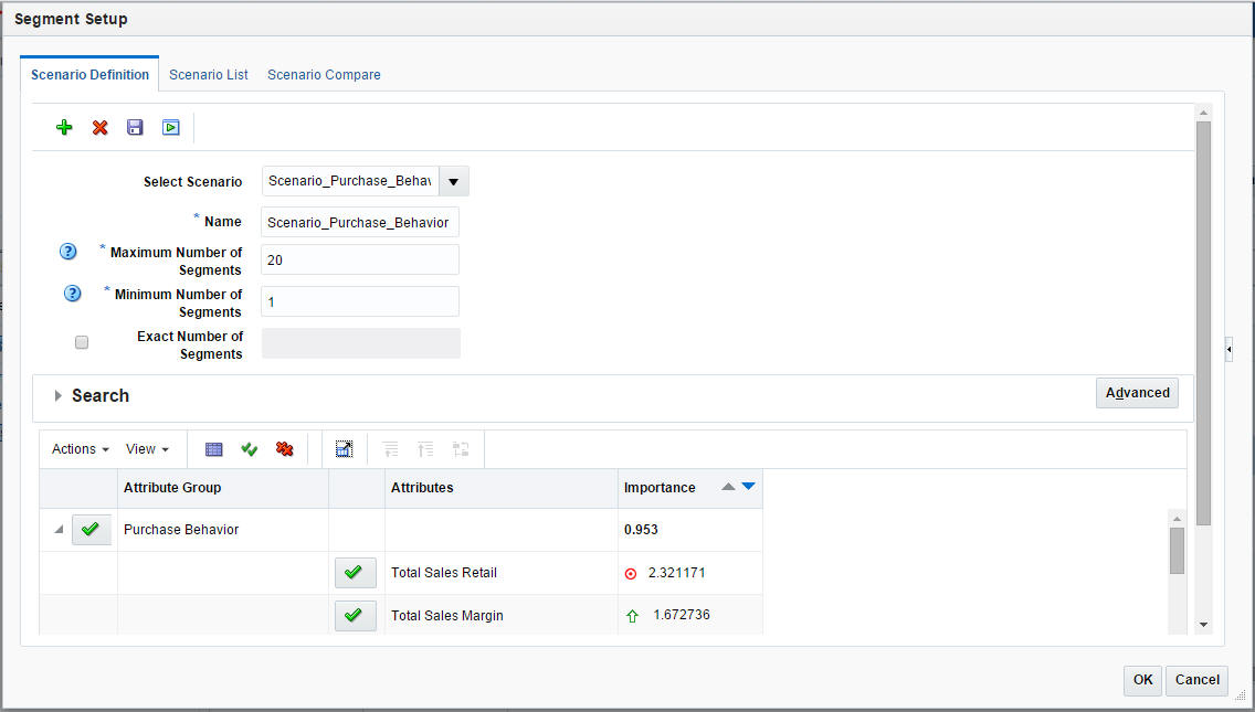

Scenario Definition Tab
This section describes the Scenario Definition tab.
The following information defines a scenario.
Table 5-16 Scenario Definition
| Field Name | Description |
Select Scenario |
Select an existing scenario if you want to modify it. |
Name |
A unique name that identifies the scenario being defined. |
Max. # of Segments |
Set the maximum number for the total number of segments that can be generated. The application determines the optimal number of segments during the generation process. |
Min. # of Segments |
Set the minimum number for the total number of segments that can be generated. The application determines the optimal number of segments during the generation process. |
Exact # of Segments |
Indicates that the exact number of segments should be generated. The application does not determine the optimal number of segments. |
Attributes
The Attributes table is used to define which attributes are included in the segment criteria. You can
search by attribute, attribute value, or attribute importance
select and deselect attributes
The following information defines the attributes that are participating or non-participating.
Table 5-17 Attributes
Participating |
A check in this column indicates that the attribute participates in the segment criteria. |
Attribute Group |
A logical grouping of attributes such as demographics or purchase behavior. |
Attributes |
Attributes that are potential candidates for generating segments. |
Importance |
System-generated attribute importance index that indicates the significance of each attribute. |
The Attributes toolbar includes the following functionality:
Table 5-18 Attribute Toolbar
| Function | Description |
Action menu |
Resets the attribute selection to the default selection that system identified using attribute importance thresholds. |
Include or exclude attributes |
Any attribute beyond a certain threshold is not included in the segmentation process. |

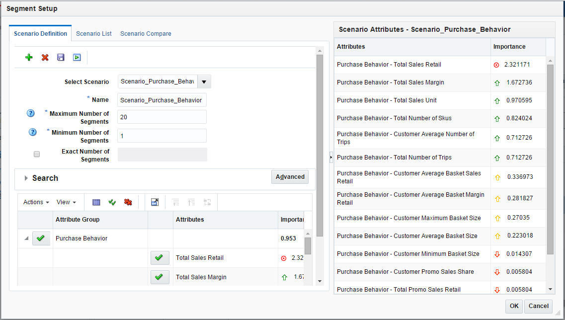

Contextual Area
The contextual business intelligence lists a set of attributes that the current scenario includes as the participating attributes for the segmentation process.
Figure 5-19 Scenario Definition: Contextual Area
Description of "Figure 5-19 Scenario Definition: Contextual Area"
