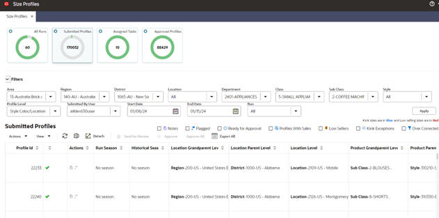

You can see the submitted profiles across all runs in the Submitted Profiles screen, shown in **INTERNAL XREF ERROR**. You can send profiles for review to your own user or another user. You can approve selected profiles or bulk approve all profiles. The approved profiles will get exported out once the nightly export process runs.
The Filters section is similar to the filters in the Run Output screen. You can use it to filter the size profiles based on product and location hierarchies. Using the profile level filter, you can view either the profiles at lowest level (style-color/location) or the profiles at higher levels. Using the user filter, you can filter the profiles based on the user who submitted the. Using the date filters, you can filter the profiles based on the date that they were submitted. Using the run filter, you can limit the profiles to a certain run. You can also use the check-box filters above the table to further filter profiles by ready for approval status, as well as having notes or flags. Lastly, you can filter profiles to show/hide the profiles that had any sales during the historical period, are low sellers, have kink exception, or have over-correction alert.
