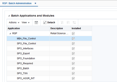

Using the Batch Administration functionality, shown in Figure 22-1, the user can enable and disable application-specific batch processes as a whole or enable and disable individual batch processes at the job level. Any modifications made will become effective with the next scheduler day load (except batch throttling configurations). The execution of application batch processes can be controlled by selecting or deselecting the check box.
To access Batch Administration, from the Tasks list, select Batch Administration.
Figure 22-1 Batch Administration

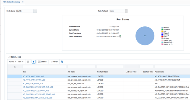

Using Batch Monitoring, shown in Figure 22-2, the user can monitor the current status of different batch processes at cycle level including nightly, ad hoc, and hourly. This screen displays a pie chart section that provides a summary view of the current cycle execution. A job can have 12 different job statuses: Loaded, Pending, Completed, Error, Held, Skipped, Running, Long Running, Disabled, System Held, Skipped on Error, and Waiting.
To access Batch Monitoring, from the Tasks List, select Batch Monitoring.
Monitoring a Batch Cycle
To create a new scheduler day.
  1. Access Batch Monitoring.
  2. Select the schedule tile for the application for which you want to create a new scheduler day.
  3. Click Create Schedule. A popup window appears with the following: Do you want to create a new <application name> schedule for <POM business data>?
  4. Click Yes to confirm. A new scheduler day will be created.
  5. From the Monitoring Cycle list box, select the Nightly/Ad hoc/Hourly cycle. Note that the individual nightly batch job with its run status is loaded.
  6. A pie chart displays the summary view of the current cycle execution.

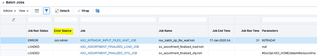

  • 'The Error Source column lists the source of error. If the source is POAM, it is generally a connection issue.
If the source of the error is Job Admin, it can be either a connection failure or an actual job failure. This can be determined by examining the logs for JOS JOB ADMIN.
JOS JOB ADMIN
  1. .Log into JOS JOB ADMIN using a valid user name and password.
  2. Navigate to System Logs.
  3. Against the job name, there is a link to download the log. Also, clicking on the job name brings up a screen that also has a link to download the logs.
