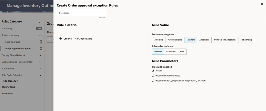

Business Rules for Auto-Approval
The user can set up order approval exception rules within Rules & Strategies. This rule is under the post-processing category and allows for selecting different type of orders and specify inbound/outbound/all for disabling auto-approval using different criteria such as product and location hierarchy, and supplier.

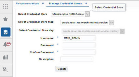

Additional configuration parameters must be set to integrate IPO with MFCS. The configuration parameters that must be set for integration of replenishment policies and rebalancing transfers are listed in Table 15-2 and Table 15-3, respectively.
In addition, the MFCS username and password must be added under the credential store for Merchandise MFCS Access. You can modify these values using the UI screen for Data Management -> Manage Credential Store, as shown in Figure 15-1 and Figure 15-2. Data Management screen is available under the task menu in the main dashboard.
The export process can be done from the UI by approving recommended replenishment policies, purchase orders, transfers, and allocations. The nightly job for export pushes the auto-approved recommendations to MFCS.

Figure 15-1 and Figure 15-2 show adding a username and password for the credential store.
Figure 15-1 Selecting the Credential Store
Description of "Figure 15-1 Selecting the Credential Store"
Figure 15-2 Adding the Username and Password for the Credential Store
Description of "Figure 15-2 Adding the Username and Password for the Credential Store"
