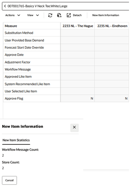

The workflow in the New Item Setup workspace workspace starts by selecting the New Items. An item is defined as new if it has a forecast startdate override that is in the future, that is, past the system today. The date can be loaded in the measure if available. If not, the date can be entered manually. Once you identified the New Item and the forecast startdate override is populated, you can select the substitution method. Depending on your selection, you may need to enter additional information. The workflow message measure will guide you through the process. For instance, if you choose User Input, you need to provide the User Provided Base Demand. If you do not provide the User Provided Base Demand, the workflow message warns you and displays Base Demand Not Input By User. You have successfully set up a New Item for forecasting when the workflow message is cleared and the Approval flag is selected. You finish by clicking the Approve button.
Another helpful tool in the process of setting up New Items is the Workflow Message Count measure. It displays the number of item/store combinations that have been flagged as new, but have not yet been successfully set up. When setting up the New Items was successful, the measure will display a count of zero.
If you access the top filters, you can range down the products and locations you include in the workspace scope. These settings are applicable also to the view in the bottom drawer. Through the top filters, you can also specify the product and location levels.
Figure 12-31 New Item Setup
This image shows the new item setup.

You can find more details when accessing the views in the bottom drawer, by clicking New Item Information in the main grid.
There are two tabs:
  • New Item Statistics
  • New Item Forecast
New Item Statistics
The measures in the New Item Statistics view are supporting the New Item setup process that happens mainly on the main screen. There is no need for a cycle set. The information shown in this view is relevant to the item selected in the grid, and for all stores.
The New Item Statistics view contains the following measures:
  • Workflow Message Count: This measure displays the count of the Workflow Message measure in the Select and Approve view. The workflow messages are guiding you in the New Item setup process. If the count is zero, you have set up correctly all New Items. The count corresponds to the number of New Item/store combinations that you still have to finish setting up.
  • Store Count: This measure displays the number of stores that a New Items has been set up for.
