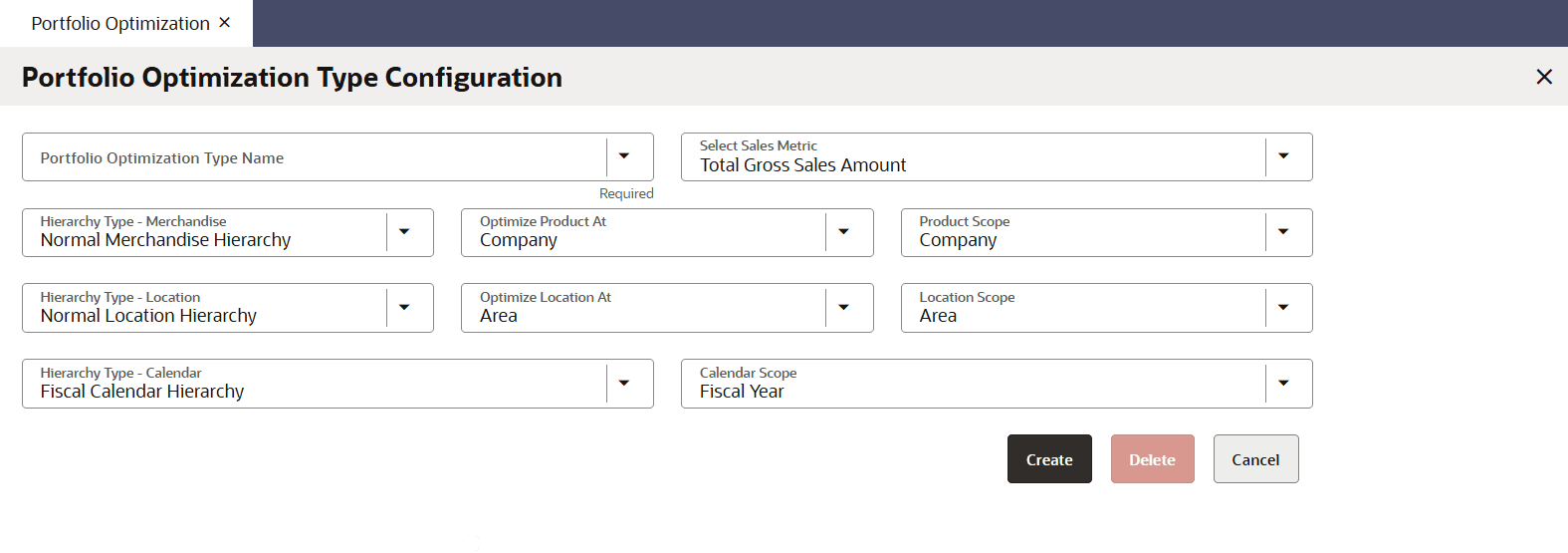

  1. Click the Gear icon on the Portfolio Optimization page.
  2. Enter the details for the following parameters:
    Configuration Options Description
    Portfolio Optimization Type Name
    Enter the name for the Portfolio Optimization Type in the text box.
    This label will be displayed in the future process step to identify the configuration type.
    Select Sales Metric Choose the metric option for optimization. Select either the Gross Sales Amount or Net Sales Amount metric as the basis for optimization.
    Hierarchy Type - Merchandise Select the product hierarchy using the drop-down menu. Depending on the implementation, multiple options may be available.
    Hierarchy Type - Merchandise Optimize Product At Select the product level to be optimized using the drop-down menu. The list of product hierarchy levels is displayed, based on the selected hierarchy type.
    Hierarchy Type - Merchandise Product Scope Select the level to define the scope of the optimization. Based on the product level selected for Optimize Product At, the list of parent levels of selected product hierarchy is displayed.
    Hierarchy Type - Location Select the location hierarchy using the drop-down menu. Depending on the implementation, multiple options may be available.
    Hierarchy Type - Location Optimize Location At Select the location level to be optimized using the drop- down menu. The list of location hierarchy levels, based on the selected hierarchy type, is displayed.
    Hierarchy Type - Location Location Scope Select the level to define the scope of the optimization. Based on the location level selected for Optimize Location At, the list of parent levels of selected location hierarchy is displayed.
    Hierarchy Type - Calendar Select the Calendar hierarchy using the drop-down menu. Depending on the implementation, multiple options may be available.
    Calendar Scope
    Select the calendar level to define the scope of the optimization.
    For example, the user wants to review the portfolio optimization recommendation for department level. For the Product Optimize At level, the user sets the value to Department, and, then the user selects the Product Scope from the Parent level of Department, that is, Division or Company, depending on the business.
    For the calendar hierarchy, the user can select either Fiscal Year or Fiscal Quarter as the scope for generating the results.
    For MFP data optimization, select the Planning Channel level for Location Hierarchy to align with the hierarchy levels. Select Alternate Hierarchy for the Location Type drop down. The system will reflect Planning Channel for the Scope & Optimize At level.
    Figure 14-3 Portfolio Optimization Type Configuration
