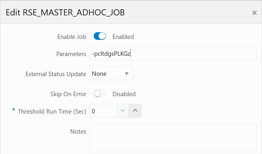

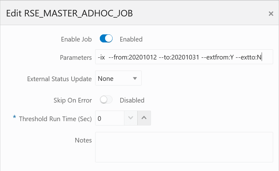

Edit Job Parameters in POM
Each letter in the string refers to a specific program or step in the execution flow, which will be covered in more detail in the sections of this chapter. When multiple parameters are used, such as when start/end dates are provided, the format of those parameters uses double-hyphens and colons as shown here:
Example Parameters

  • --from Start date of the data processing timeframe. Must be provided in YYYYMMDD format with no spaces. For example, --from:20170101. Must be accompanied by the end date and optionally by the extfrom flag
  • --to End date of the data processing timeframe. Must be provided in YYYYMMDD format with no spaces. For example, --to:20170201. Must be accompanied by the end date and optionally by the extto flag
  • --extfrom Optional flag to indicate if the start date must be extended to the start of the week. Accepts Y or N (default). For example, --extfrom:Y, with no spaces
  • --extto Optional flag to indicate if the end date must be extended to the end of the week. Accepts Y or N (default). For example, --extto:Y, with no spaces

Options -A and -R will enable processing of appropriate steps. The A flag indicates to run all steps except the letters following it, while the R flag indicates to resume from the letter following it. Any switch provided more than once, or after a -A or -R will toggle the switch On/Off. This will enable excluding a small number of steps from processing, without requiring specifying all other switches.
Examples:
  • -Act will result in running all steps except -c and -t
  • -Rc -t will result in running all steps starting with c, but excluding step t
  • -pldgxwa will result in extracting the product, location, calendar, customer segment, and sales data from the data warehouse and populating all the core AIF aggregates for sales (this is a common set of load steps for first-time runs)
Additional optional flags may be specified after the sequence of steps is provided, as listed below. Date ranges will apply to any step that extracts historical data, such as sales and inventory loads. If no date range is provided, then the job will attempt to determine the range of dates in the data warehouse and extract that entire range. If a step has already extracted data from the data warehouse once, then you must specify dates on additional runs of that step to ensure only that date range is re-extracted.
  • --alt_prod_hier Run only the alternate (flex) product hierarchy load steps
  • --alt_loc_hier Run only the alternate (flex) location hierarchy load steps
  • --alt_hier_setup Run only the alternate (flex) hierarchy setup steps
  • --prioritizefiles Specifies that data files should be prioritized as the source for a load instead of RI, where it is possible to get data from either source
  • --from Start date of the data processing timeframe. Must be provided in YYYYMMDD format with no spaces. For example --from:20170101. Must be accompanied by the end date and optionally by the extfrom flag
  • --extfrom Optional flag to indicate whether the start date must be extended to the start of the week. Accepts Y or N (default). For example, --extfrom:Y, with no spaces
  • --extto Optional flag to indicate whether the end date must be extended to the end of the week. Accepts Y or N (default). For example, --extto:Y, with no spaces
