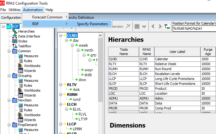

Set Up Common Configuration Details

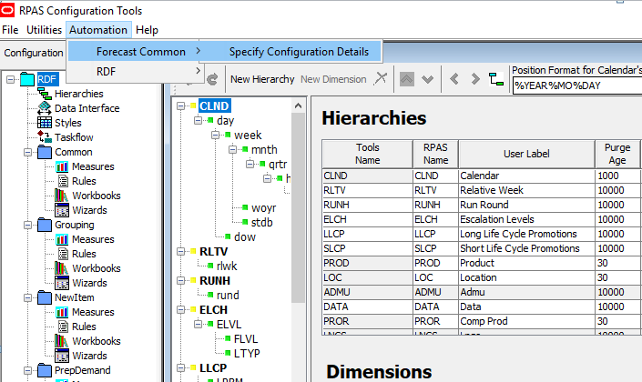

From the Configuration Tools toolbar, select the Automation menu and then from the Forecast Common option, select Specify Configuration Details.
Figure 3-1 Configuration Tools: Forecast Common
Figure 3-2 Select Common Input

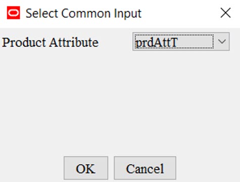

In this step we specify the common input to both New Item and RDFCS.
The product attribute measure to be used in the RDFCS and New Item solutions has to be specified in the Common Plug-in. The product attribute measure stores the attribute position name and not the attribute label.

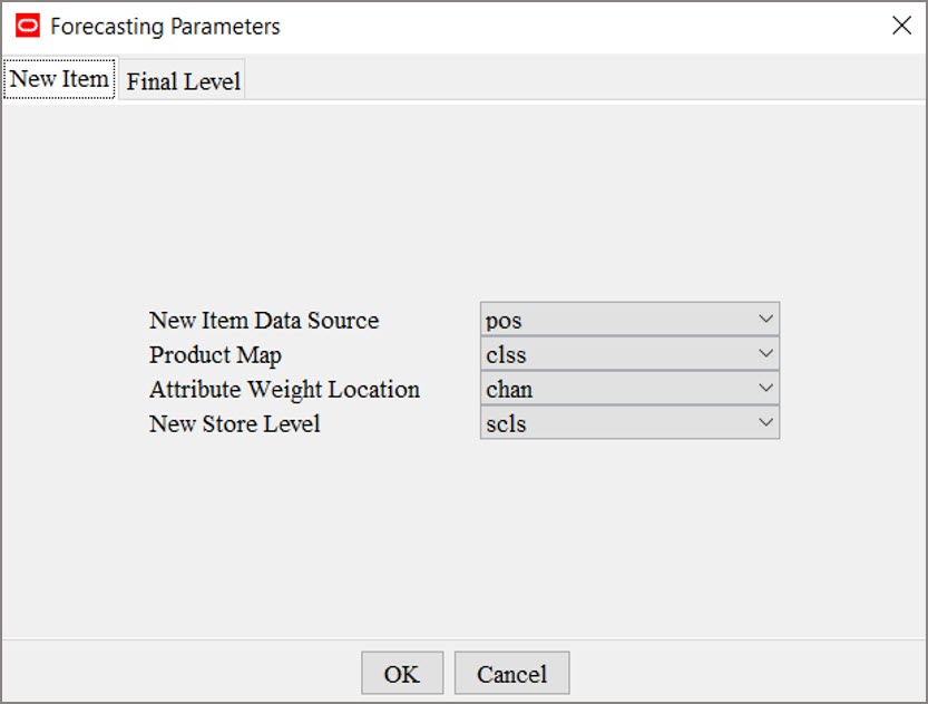

From the Configuration Tools toolbar, select the Automation menu and then, from the RDFCS option, select Specify Parameters.
Figure 3-3 Configuration Tools: New Item
From the Like Item Parameters utility, specify the properties for the New Item plug-in. Refer to Editing New Item Parameters for details.
Figure 3-4 Like Item Parameters
Click OK once editing is finished.
Table 3-3 lists the New Item parameters available for editing.
Table 3-3 New Item Parameters
| Parameter | Description |
New Item Data Source |
Sales data used to generate forecast for New item/store. |
Product Map |
This field specifies the range of the like item available to a new item. If the field is populated with clss, it means that only existing items under the same class as the new item are available as like item candidate. The Similarity Score calculation should only be performed between the new item and existing items with in the class. |
Attribute Weight Location |
Allows you to specify which location level that the attribute weight used in similarity score calculation will be based on. The attribute weight measure intersection is to be on product Map/attribute-weight-loc/patt. In GA, it is clss/chan/patt. |
New Store Level |
This field specifies the product level on which like store is assigned to new store. If the field is selected as scls, it means that the like store assignment can be different per subclass. |

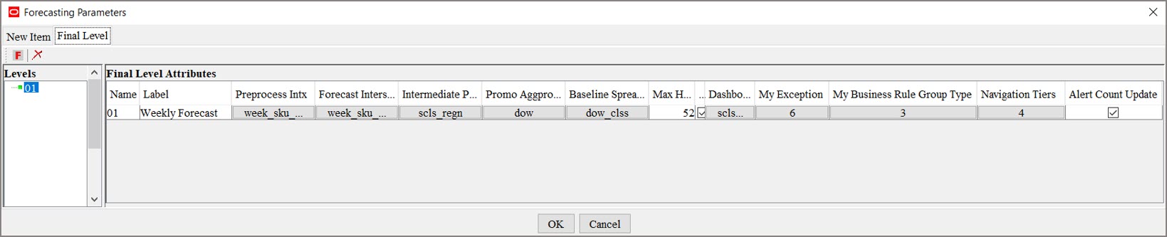

1. Select the final level tab to configure the various parameters for Final Levels.
Configure a final forecast level:
From the Forecasting Parameters utility, click the F icon. A new final level is added, and it is assigned the next available level number. Specify the properties for the final level. See Editing Forecast Level Parameters for details.
To remove a final level, select the forecast level and then click the X icon. Deleting a final level removes all of its associated parameters.
Figure 3-6 Final Forecast Level

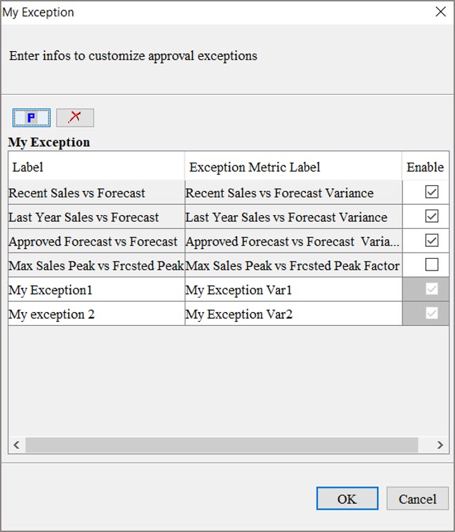

My Exception |
This parameter provides a mechanism for the implementor to configure custom approval exceptions and enable/disable GA provided approval exceptions. These exceptions will be used during the batch for Forecast approvals and is also seen in the dashboard exception profile as a separate tile. The implementor can enter the labels for the exception and the secondary measure such as variance measure. Note that the implementor is responsible to configure the rule/rule group (based on the exception definition) to populate the boolean measure (and variance measure) for the My Exception. |
Configure My Exception
This parameter provides a mechanism for the implementor to configure custom approval exceptions and enable or disable GA provided approval exceptions. These exceptions are used during the batch for Forecast approvals and are also seen in the dashboard exception profile as a separate tile. The implementor can enter the labels for the exception and the secondary measure such as variance measure.
Note that the implementor is responsible to configure the rule or rule group (based on the exception definition) to populate the boolean measure (and variance measure) for My Exception.
To add or remove custom exception, perform the following steps.
Click within a cell of the My Exception table to open a dialog as shown in Figure 3-7. The dialog displays a table with the columns:
Label - Displays the exception label name (read only)
Exception Metric Label - Displays the exception metric label name (read only)
Enable - Allows you to enable or disable GA provided exceptions
Click P to create additional rows for custom approval exceptions. implementors can enter labels and exception metric labels in the new custom exception. Click X to delete the custom exception.
Figure 3-7 Add New Custom Exceptions

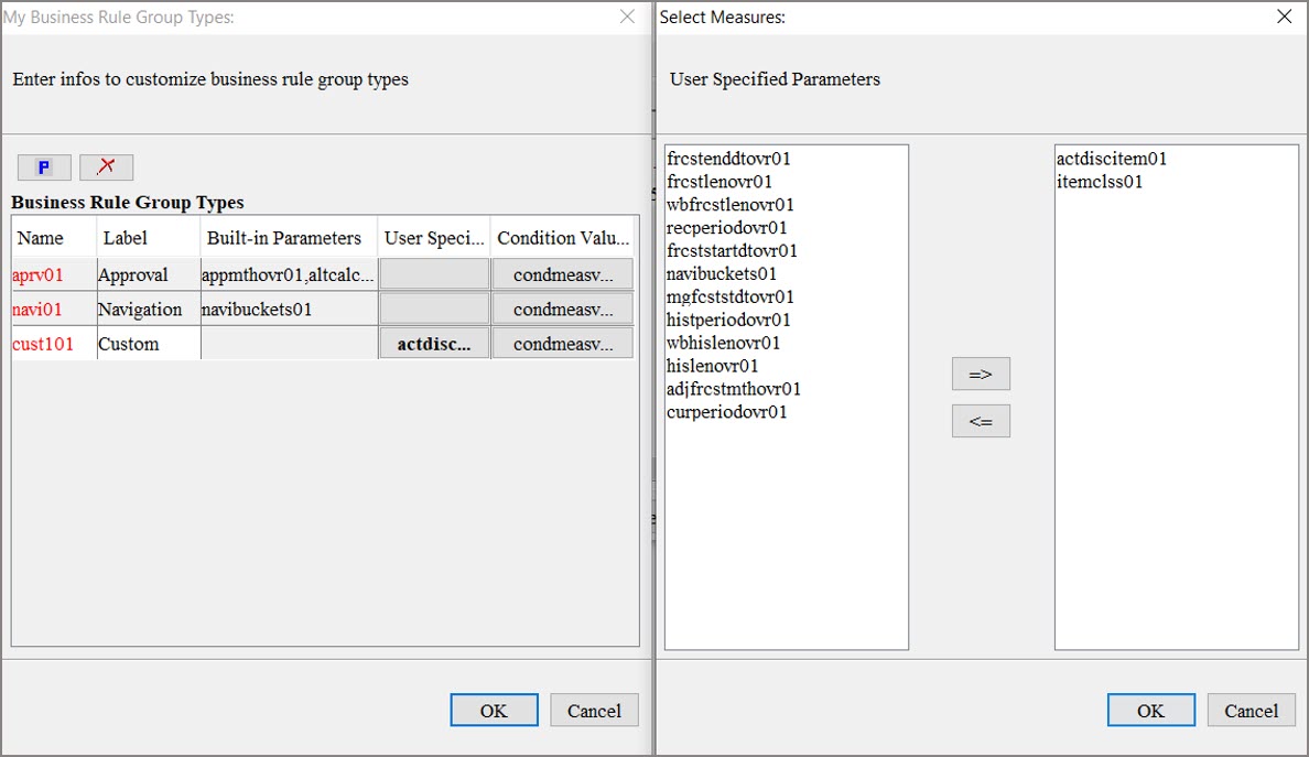

Configure My Business Rule Group Type
Click within a My Business Rule Group Type cell to configure the business rule group types. Business Rule Group Type is a RDFCS internal dimension that is part of the Final Level Hierarchy. The Final Level hierarchy file is generated by an RDFCS plug-in. There are two dimensions: rulegroup-type and final level.The dimension, rulegroup-type rolls up to the final level dimension. There are two GA rulegroup types per final level, Approve and Navigation.
You can specify additional custom rulegroup types using the RDFCS plug-in. Each final level can have its own custom rulegroup type. The Final Level hierarchy data file is generated at domain build/patch time.
The business rule group type table is created with two default rows. The Name and Build-in Parameters are read only. Aprv01 is for approval. It is a rule group type designed for approval process.
The built-in Parameters are:
Approve method at final
Alert window at final
Alert error threshold at final
The rule group type, navi01, is designed for tiered navigation in Forecast Review workbook.
Click P to add more custom rule group types. The name need to be unique across all final levels and thus it is good practice to append level number at the end. Click X to remove custom rule group types.
User specified Parameters per rule group type can be specified by an implementor if additional parameters need to be included. The parameters are associated with business rule group type so that the values for a certain sku/store can be assigned to a set of value for a business rule which the sku/store belongs.
Click within the cell of user specified parameters to open the
dialog that allows you to add or remove parameters. The Select Measures
box in Figure 3-8 displays all GA parameter measures. Most of these measures
are forecasting parameter at final. Any custom measures with intersection
= forecast intersection without the clnd dimension
and have a valid db will be available for
selection too. For each selected measure, a measure at business rule
is created and added to the parameter for <rule group type> worksheet
for user input.
Figure 3-8 Select User Specified Parameters

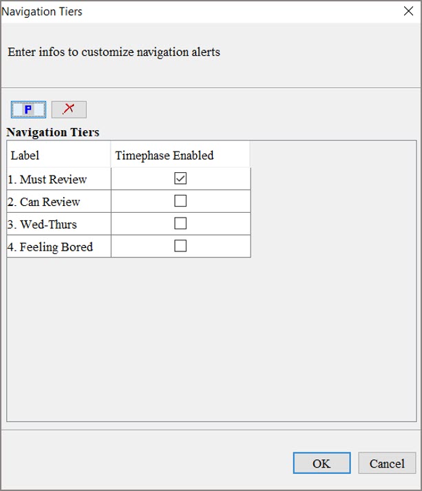

Configure Navigation Tiers
Navigation in the Forecast Review workbook is now tiered. You can decide how many tiers and what is the rule to associate a sku/stores to a tier. There is a corresponding workbook alert associated with each tier. By switching between workbook alerts, you can jump between sku/stores with a different priority to be approved.
Click within the navigation-tier cell to display the dialog that allows you to add or delete a tier.
Click P to add more tiers. implementors can enter the label of the tier and indicate if a time-phase workbook alert is enabled or disabled.
Click X to remove tiers.
For each tier, a workbook alert at prod/loc is created in the Forecast Review workbook. If time-phased is enabled, an additional workbook alert at prod/loc/clnd is created in the Forecast Review workbook.
Figure 3-10 Select Navigation Tiers

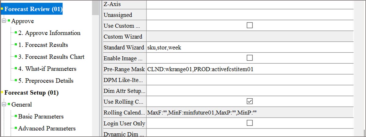

RPAS Rolling Calendar
RDFCS has enabled an RPAS Rolling Calendar feature for Forecast Review workbook templates. Refer to the Oracle Retail Predictive Application Server Cloud Edition Configuration Tools User Guide for more details.
In essence this allows us to define a calendar window based on RPAS_TODAY. The main use case for this feature is for auto workbook builds, where in the calendar window advances based on RPAS_TODAY.
Figure 3-11 Rolling Calendar
Out of the four rolling calendar range measures, only the Minimum Future has been set to the Alert Calculation window. This is set during the forecast batch.
The Minimum Past defaults to 0, which means it is not required to pull in any week prior to TODAY.
The Maximum Past and Maximum Future are also not set and will default to the current Calendar pre-range.
The rolling calendar feature is not extensible and implementors cannot edit the rolling calendar range measures.

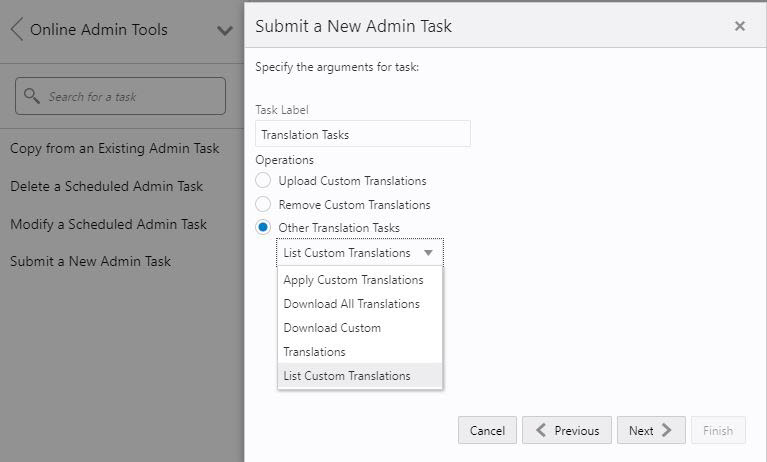

Perform the following steps to access the position names to create the locale specific file:
Make sure the browser locale is English - United States
From the OAT configure batch task, go to the Translation Task and then, Download All Translations.
The
r_msglabel.csv.ovrfile contains the English labels as updated by the implementor in the RDFCS plug-in. -
This file can serve as an example to create the locale specific
r_msglabelfile. -
The locale specific file can contain only the records with the updated labels.
Revert the browser language to the original locale.
Upload the locale specific
r_msglabel.csv.ovrfile using the Translation Task .Figure 3-12 Translation Tasks
