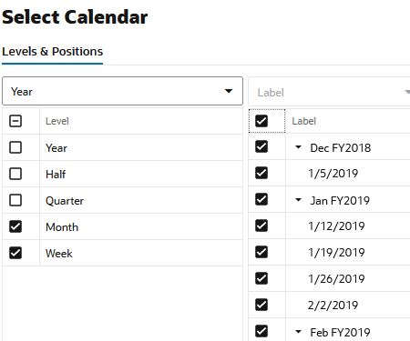

                        Select the time periods you want to work with and click Finish. Figure 5-6 Workspace Wizard: Select Available Calendar Positions

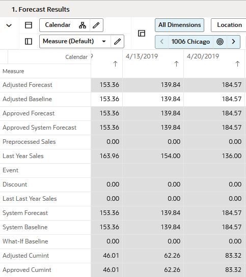

Forecast Results View
The Forecast Results view shows all information related to forecast generation. It shows the forecast with its components, baseline and promotional peaks. It also shows sales of last year, and cumulative interval information.
The navigation of this worksheet is very conveniently driven by real time or workbook alerts.
There is a duplicate of this view - Forecast Results Chart View- that is intended to show the information in chart form.
If not already in chart mode, you need to change the view type from pivot table to chart and save the format. This is a one-time action.
Figure 5-8 Forecast Results View
Measures: Forecast Results View

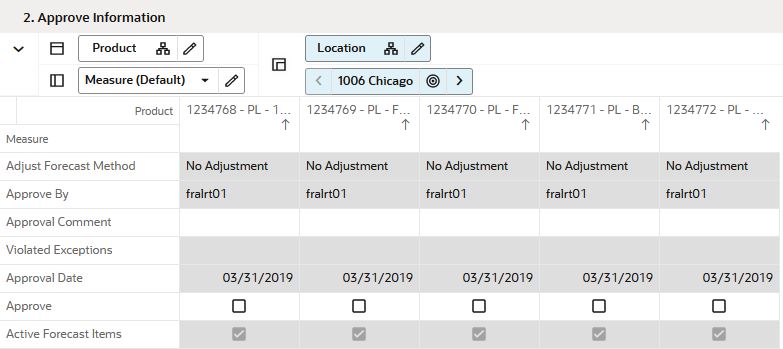

Approve Information View
The Approve Information view shows information around the approval process, like which user approved the forecast, when it was approved and potential notes.
Figure 5-9 Approve Information View
Measures: Approve Information View
The Approve Information view contains the following measures:
Active Forecast Items
This field indicates if an item/store qualifies to have a forecast generated.
Adjust Forecast Method
This measure displays the adjustment method used to programmatically adjust the system forecast. The options are:
                              No Adjustment No adjustment is made to the system generated forecast
                              Keep Last Change If any adjustments were done to the forecast in the previous runs, they are reflected in the Adjusted Forecast measure. In this use case, the total forecast is retained.
                              Keep Last Baseline If any adjustments were done in the Adjusted Baseline in the previous runs, they are retained. In this use case. the system calculated peaks are applied on the Adjusted Baseline
                              Keep Last Peak If any adjustments were done in the Adjusted Peak measure in the previous runs, they are retained. In this use case, the adjusted peaks are applied on the system calculated baseline.
Approval Comment
Approval Comment is a field in which notes may be entered regarding the forecast values or any pertinent information for specified product/location combinations.
Approval Date
Approval Date is a read-only field that displays the date that the forecast quantity is approved either automatically during the batch forecast process or when changes are made to the Adjusted Forecast. This information is necessary for RDF Cloud Service to carry out any subsequent processes, such as replenishment procedures.
Approve
This field may be checked if you want to accept the System Forecast quantity for a time series that has yet to be approved. The flag is also activated when a change is made to the Adjusted Forecast and Calculate occurs. When this flag is activated, the time series for an item/location are approved and both the Approval Date and Approved By fields are updated.
Approve By
Approved By is a read-only field that displays the name of the user to approve forecasts for an item/location. This field may be populated with Sys if the system was set to automatically approve forecasts during the batch forecast process.
Violated Exceptions
This field displays which (if at all) approval exception business rule was violated.

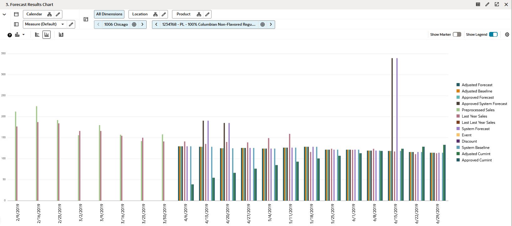

There is a duplicate of this view - Forecast Results View- that is intended to show the information in table form.
Figure 5-10 Forecast Results Chart View

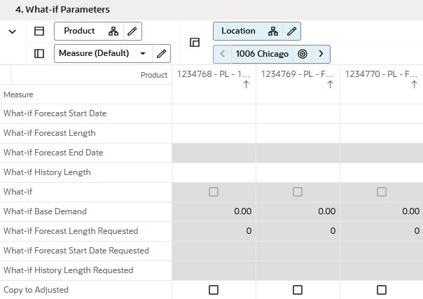

What-If Parameters View
The What-If Parameters view allows you to adjust some forecast parameters and immediately view the effects on the forecast in the Forecast Results view.
If you like the new adjusted forecast, you first have to Approve the forecast to get the forecast in the approved forecast measure. Next you have to Commit to update the database with the approved forecast as well as with the What-if forecast parameters settings. These parameters are used the next time the forecast batch is run.
Parameters that can be adjusted will affect base demand as well as total forecast.
Figure 5-11 What-If Parameters View
Measures: What-If Parameters View
The What-If Parameters view contains the following measures:
What-if
This Boolean measures specifies if the user can perform what-if. If it is unchecked, no what-if is triggered. To perform what-if you need to select at least one of the following measures:
If the What-if flag is on, you can run it by clicking on the What-if custom menu.
Copy to Adjusted
After you are finished adjusting the parameters, you can either return reviewing the forecast or you can make some of the changes stick. For this to happen, enable this measure and run the Copy to Adjusted custom menu to copy the forecast generated using What-if parameters in the Adjusted Forecast measure from the Forecast Results view.
What-if Base Demand
This measure displays the value for the base demand based on the new history length.
What-if Forecast End Date
This measure displays the date based on the entries in the Forecast Start Date and Forecast Length. Forecast End Date = Forecast Start Date + Forecast Length.
What-if Forecast Length
This measure lets you specify a forecast length, which is likely not the default forecast end date less forecast start date used in batch. The value used will be reflected in the Forecast End Date measure.
What-if Forecast Length Requested
This measure displays the requested forecast length. This is useful, because after running the What-if custom menu, the What-if Forecast Length measure will be blanked out. It is this measure where you keep track of the latest forecast length used.
What-if Forecast Start Date
This measure lets you specify a different forecast start date then the default used in batch, which is RPAS_TODAY.
What-if Forecast Start Date Requested
This measure displays the requested forecast start date. This is useful, because after running the What-if custom menu, the What-if Forecast Start Date measure will be blanked out. It is this measure where you keep track of the latest forecast stare date used.
What-if History Length
This measure lets you specify the number of periods used to calculate the base demand.
What-if History Length Requested
This measure displays the requested history length. This is useful, because after running the What-if custom menu, the What-if History Length measure will be blanked out. It is this measure where you keep track of the latest history length used.

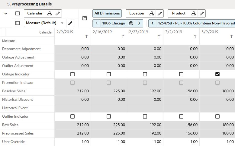

Preprocessing Details View
The Preprocessing Details view shows all necessary information to determine how the loaded sales were transformed into unconstrained demand. You can review the numbers after each step, and also have the possibility to override the total demand. Unconstrained demand is what an item would have sold at a location without the influence of any outside factor. These factors can include:
                           Out of stock situations where an item would have likely sold more
                           Outliers like fatty fingers or Software bugs
                           Promotions that can boost sales
                           Weather that can boost sales (water during a hurricane) or lower them (BBQ items for a rainy day)
For details on how the corrections are made refer to the Oracle Retail Science Platform User Guide.
Figure 5-12 Preprocessing Details View
Measures: Preprocessing Details View
The Preprocessing Details view contains the following measures:
Baseline Sales
This measure represents the demand that was sold at a location without the influence of any outside factor.
Depromote Adjustment
This measure displays the units that were removed from the historical sales, because they were caused by the lift in demand due to one or more offers.
Historical Discount
When the Historical Discount or Historical Event measures are not blank, it is likely that the Promotion Indicator is On, and the Depromote Adjustment will also have a non-zero value.
Historical Event
Outage Adjustment
This measure displays the units that were added to the historical sales, because they were caused by the artificial drop in demand due to stockouts.
Outage Indicator
This measure is either loaded or calculated by the rules in the custom menu. It is used during the pre-processing run that corrects sales for lost sales.
Outlier Adjustment
This measure displays the units that were added to the historical sales, because they were caused by the artificial drop in demand due unusual events, like human error, or extreme bottle water sales during a hurricane.
Outlier Indicator
This measure is either loaded or calculated by the rules in the custom menu. It is used during the pre-processing run that corrects the sales for outliers.
Preprocessed Sales
This measure represents the demand – including promotion and offer data that was sold at a product/location/calendar. If configured properly, the stockout and outliers impact is removed.
Promotion Indicator
This measure is usually calculated as the OR of all available offers that are active for a product/location/calendar combination. It is used during the preprocessing run that removes promotional sales.
Raw Sales
This measure is loaded and it represents the historical sales at a product/location/calendar period level. It is different from demand because it may be constrained by stockouts, outliers, weather, and so on.
