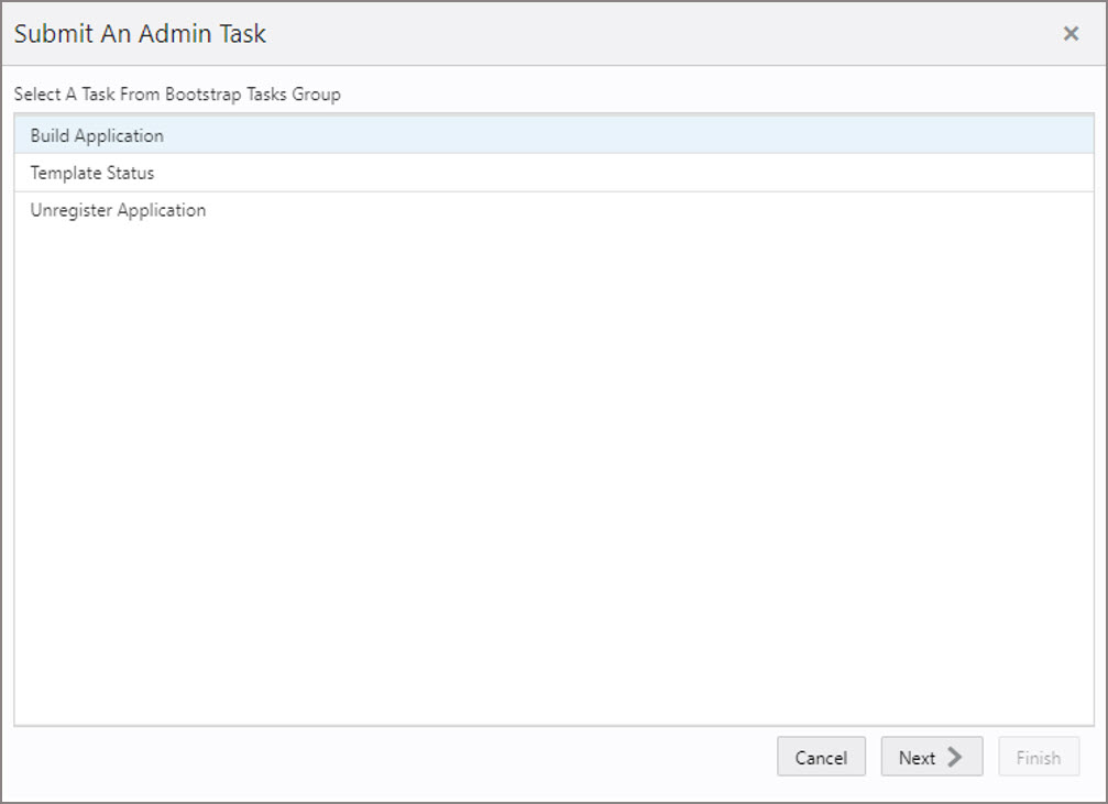

  2. In the Tasks list, select Administration and then Online Admin Tools. Click Submit a New Admin Task.
  3. Select the Build Application task and click Next.
    Figure 2-1 Select Build RDF Cloud Service Application Task
    This image shows select a bootstrap task.

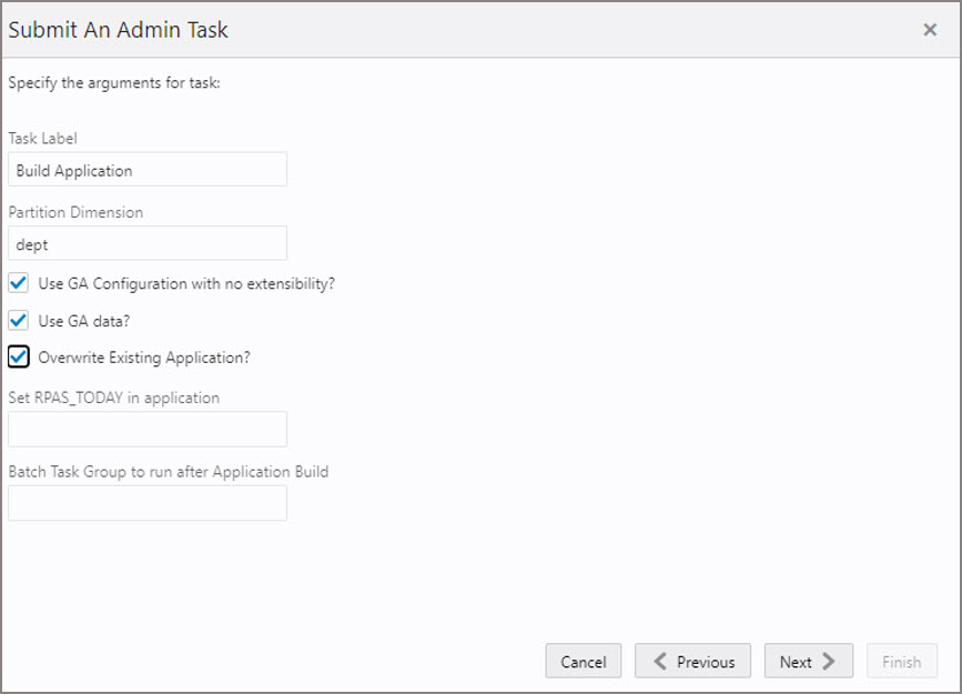

  4. Set the arguments for the task:
    Figure 2-2 Select Build Application Task Arguments
    This image shows selection arguments.
    1. Enter the Task Label.
    2. Partition Dimension is defaulted to dept dimension in for RDFCS. The application is internally partitioned based on this dimension to allow parallel processing of data in the batch.
    3. Select the Use GA Configuration with no extensibility check box, only if you need to deploy the pure template configuration without any changes, otherwise clear this box and upload the new configuration to the Object Store. If no configuration is found in Object Store, the deploy job will fail.
    4. Select the Use GA data option only if the customer wants to deploy the application using the GA data set readily available for the application. If the customer wants to deploy and use their own data set, upload the files to Object Store.
    5. If the application was already created and needs to be overwritten, select the Overwrite Existing Application option; otherwise, do not select this option. Selecting this option will drop the existing application and all associated meta data stored, so it will also lose connection to the environment. The customer will need to log out and log in again to view the status of the deploy.
    6. RPAS_TODAY is an optional parameter. It is needed only if the customer is planning to use the GA data set. For RDF GA data, the preferred RPAS_TODAY date is 20190331.
    7. Select the Batch Task Group to run after the Application Build. This is an optional parameter with the default value of post_build.
      Application Deploy without any batch will not load any hierarchy or data into the application, so the customer may need to run tasks to load hierarchy and data after domain build if they are not providing any task to run during the Application Build.
    8. After choosing all the necessary options, click Next.

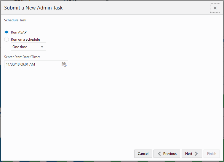

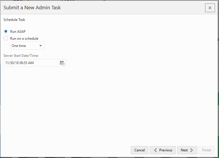

  5. Select the time to schedule the task and click Next. Click Run ASAP if the Administrator wants to run the task now or the task can be scheduled by selecting the Run on a Schedule option.
    Figure 2-3 Schedule Task
    This image shows Schedule Task.

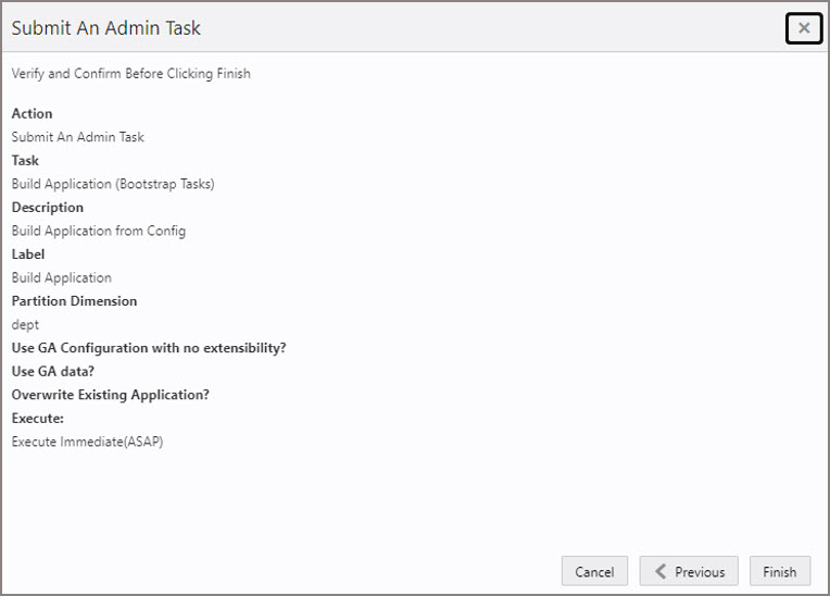

  6. Review the selections and click Finish.
    Figure 2-4 Verify and Confirm Selections
    This image shows Verify and Confirm.

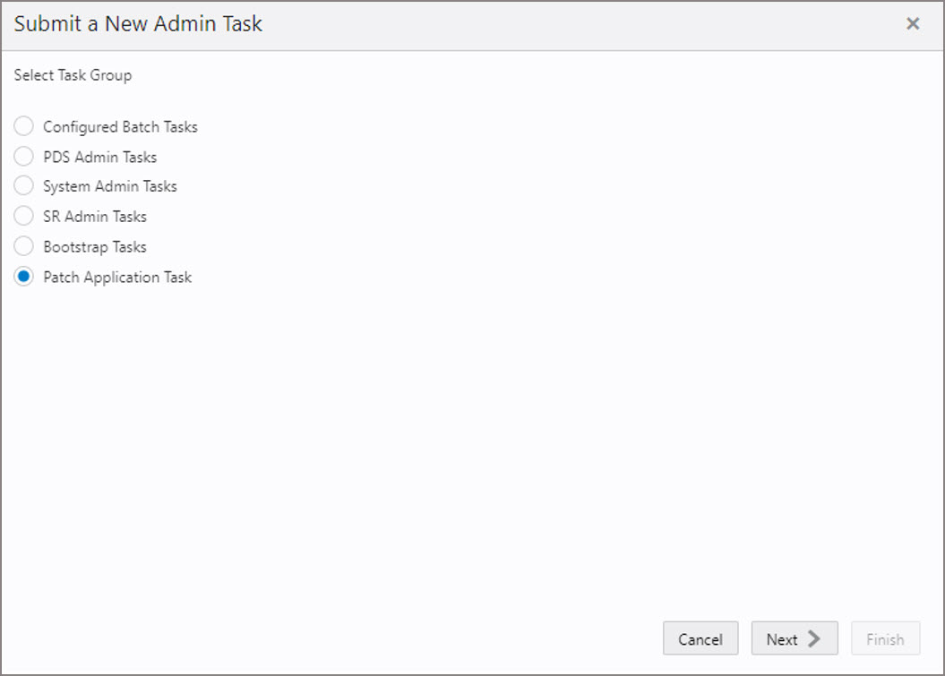

  3. Select Patch Application Task and then click Next.
    Figure 2-5 Select Patch Application Task

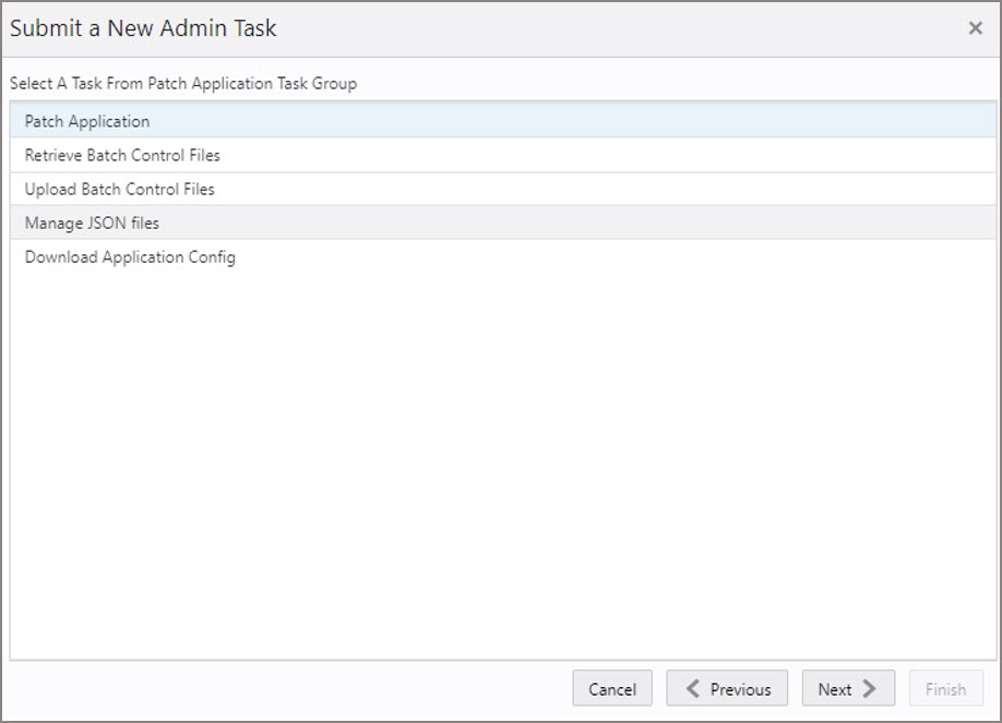

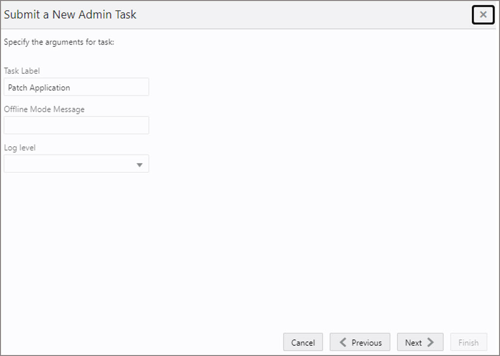

  4. Select Patch Application and set the arguments for the task:
    Figure 2-6 Select Patch Application Arguments
    Figure 2-7 Select Patch RDF Cloud Service Domain Task Arguments
    2. Enter the Offline Mode Message.
    3. If patching with an updated customer configuration, ensure that the customer configuration has been previously uploaded to the Object Store
    4. After choosing all the necessary options, click Next.
  5. Select the time to schedule the task and click Next. Click Run ASAP if the administrator wants to run the task now or the task can be scheduled by selecting the Run on a Schedule option.
    Figure 2-8 Schedule Task
    Schedule Task

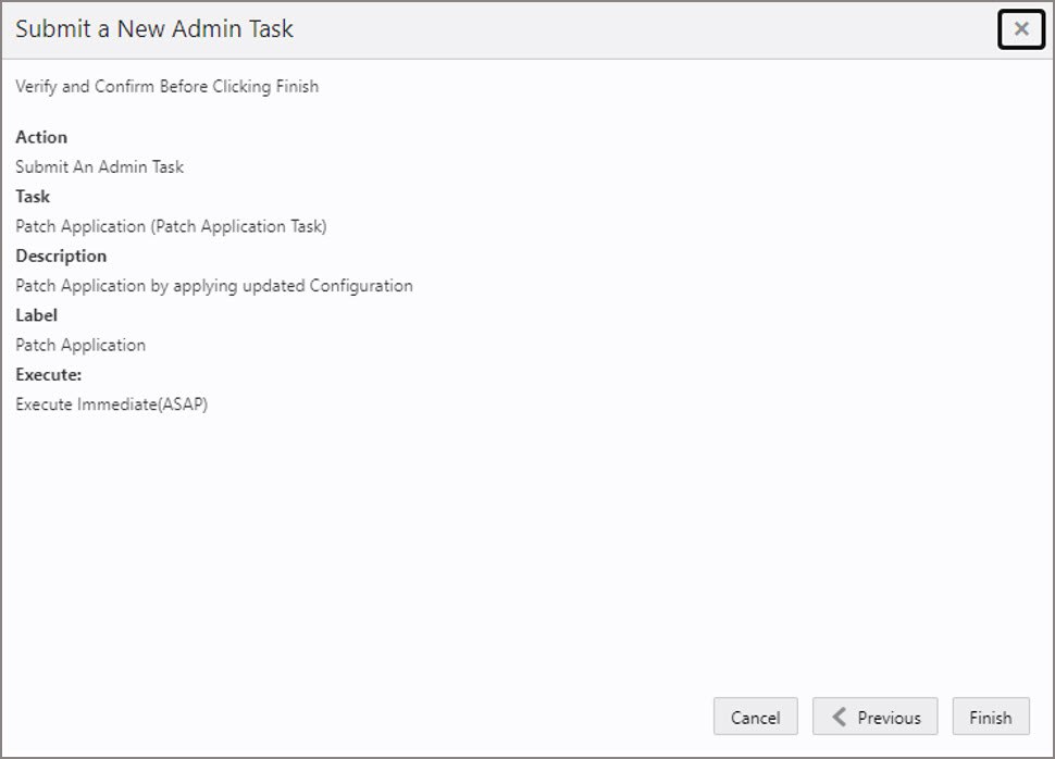

    Figure 2-9 Verify and Confirm Selections
