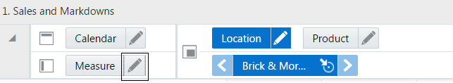

A measure profile is selected by clicking the Edit View button next to the Measure tile.
Figure 11-8 Location of Edit View Button

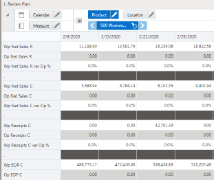

Review Plan View
In this step, review the location plan you created. The purpose of reviewing the plan is so that you can understand the goals that your plan should meet.
Figure 11-13 Review Plan View
Review Plan View

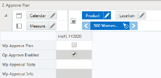

Approve Plan View
Click the Approve Plan button when you are ready to approve the location plan you created. The approved versions will be committed after the process is complete.

Review and Re-Project Plan
In this view, you can review the On Order and Open To Buy during in-season and adjust planned inventory data as needed and reapprove the CP Plan.
Figure 11-14 Review and Re-Project Plan View
Approve Plan
When you are ready to reapprove your working plan during in-season, use the Approve Plan view and custom menu Approve Plan to reapprove the plan.
Figure 11-15 Approve Plan View
Approve Plan View

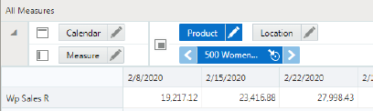

All Measures
Use this workbook to create a view of workbook measures that you may not be able to view at the same time in other views.
All Measures View
The All Measures view contains all the measures contained in the workbook; however, only the Wp Sales R measure is visible in the default measure profile. All remaining measures are available in Show/Hide.
Figure 11-16 All Measures View
All Measures View
