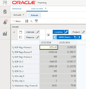

Actuals Step
The Actuals step includes a single view of the same name, the Actuals view. Use this view to validate that the actuals data was loaded in the batch process.
Figure 7-1 Actuals View
Actuals View

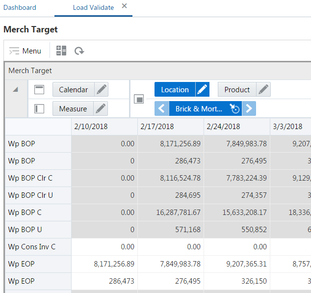

Merch Target Step
The Merch Targets step includes a single view of the same name, the Merch Target view. In this view, you can review or correct aspects of the Targets plan.
Figure 7-2 Merch Target View
Merch Target View

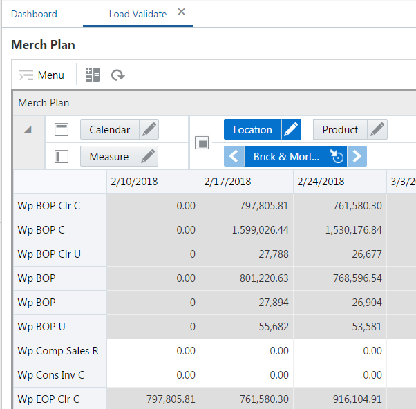

Merch Plan Step
The Merch Plan step includes a single view of the same name, the Merch Plan view.
Figure 7-3 Merch Plan View
Merch Plan View

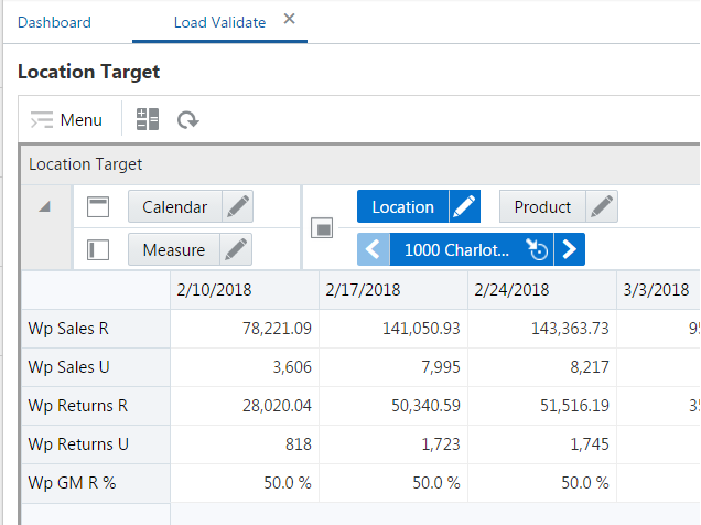

Location Target Step
The Location Target step includes a single view of the same name, the Location Target view.
Figure 7-4 Location Target View

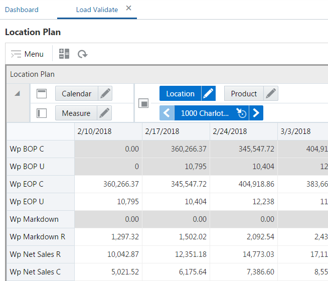

Location Plan Step
The Location Plan step includes a single view of the same name, the Location Plan view.
Figure 7-5 Location Plan View
Location Plan View
