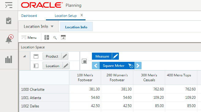

Location Space View
This is the total physical area that a department occupies within the location, expressed in square meters.
Figure 5-2 Location Space View
Location Space View
Table 5-2 Location Space View Measure
Measure Description
Square Meter
The total store area in square meters.
