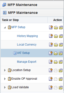

MFP Setup is part of the MFP Maintenance Activity. In MFP Setup, the administrator will maintain basic application settings related to the planning calendar, local currency, and VAT.
The steps within the MFP Setup Task:

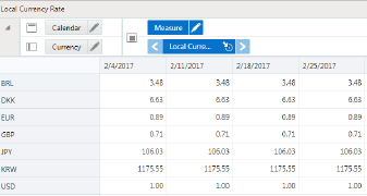

Local Currency Rate View
Within this view, you set the local currency conversion rate for each Channel by Week. The conversion rate is set in relation to the sales currency, often the corporate currency.
Figure 4-2 Local Currency Rate View
Table 4-2 Local Currency Rate View Measure
| Measure | Description |
Local Currency Rate |
The rate used to convert values from the primary currency to the local currency for a given Channel/Week. |

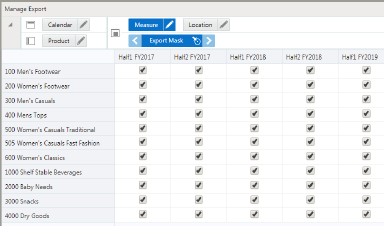

Manage Export View
Within this view, the planning administrator selects the positions that will be included when exporting plan data for all versions.
Figure 4-5 Manage Export View
Table 4-6 Manage Export View Measure
Export Mask |
Allows the user to control which positions are exported for all plan versions. When selected, the Department/Channel/Half is included when exporting plan data. By default, this Boolean is checked for all positions. If the user wants to exclude any Department/Channel/Half from exporting, the user must un-check this Boolean. |
