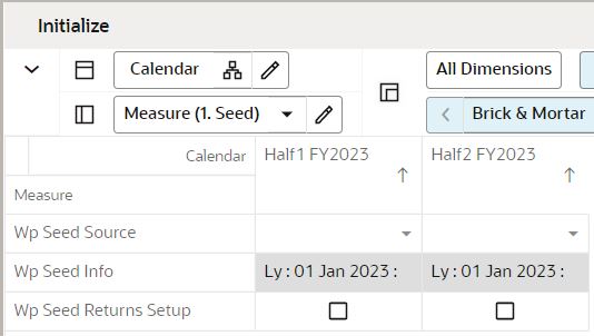

Initialize View
In order to seed the plan, you can first review the LY plan and forecast in the Sales/Markdowns tab. This will help you determine which plan you will use for seeding.
Table 8-1 Initialize View Measures
| Measure | Description |
Seed Source |
The seed source used to seed the working plan. Use this option to seed or not seed the working plan. You can seed with Last Year's (Ly) or Forecast (Fcst) data. Or, you can choose the Blank option if you do not want to seed the working plan. |
Seed Info |
Includes a few pertinent facts about the last time that the Seed custom menu was executed: last seed source concatenated with last seeded date and the last user to seed. If blank, then the given intersection has never been seeded. |
Seed Returns Setup |
Use this option to seed the working plan returns. You can seed the returns values with Last Year’s (LY) or Forecast (Fcst) data. You can also choose the blank option if you do not want to seed the working plan returns. |
When seeding the plan, you can choose which information is seeded. For instance, you can seed just one half or all halves in the workspace. You can also choose what locations and products to seed.

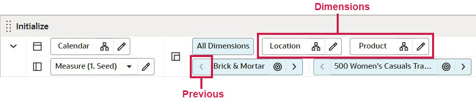

Seeding One Level at a Time
To seed one target at a time you will set the seed source information. Then, to seed the next department in the Product hierarchy within the Brick & Mortar channel, complete the following steps:
Click the dimension whose value (position) you want to change..
Click the Next or Previous arrow.
Figure 8-1 Changing a Dimension Level with Page Arrows
The page refreshes and the next position in the department dimension is displayed in the page edge. Notice that the Seed Source measure is not populated for this department.

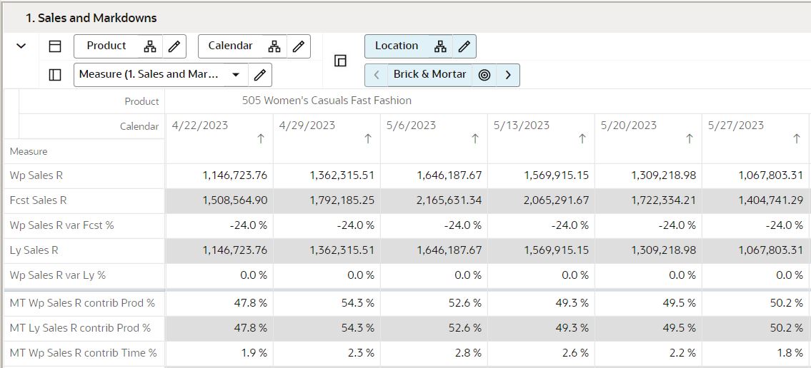

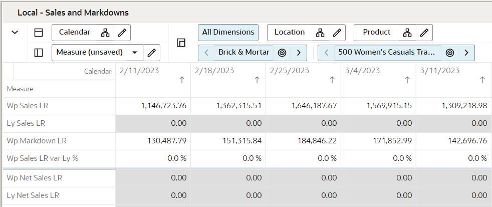

Sales and Markdowns View
In the Sales and Markdowns view, you plan net sales, promotions, and markdowns. Sales are the revenue generated by selling goods or services. Regular priced sales yield the greatest margin, however successful promotions drive more traffic and completion of sales. Though the promotional sale likely includes markdown, the overall increase in sales should outweigh the markdown and drive at good margins.

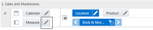

There are several measure profiles available to logically guide you through the plan variables.
A measure profile is selected by clicking on the Edit View button next to the Measure tile.
Figure 8-6 Edit View Button
The following measure profiles are available:
Sales and Markdowns
The measures in this profile represent totals which are not broken down by type of sale such as Promo, clearance, and so on. This view also incorporates the forecast for viewing on top of all Ly actuals.
Sales by Type
The measures in this profile display and capture sales and returns figures by type of sale: Regular + Promotional, and Clearance. Regular + Promo, and Clearance added together equate to the total sale or total return.
Start by planning the regular sales. Then, using your marketing calendar as a guide, align the promotional sales to the calendar. Refer to the calendar again for the exit weeks for the products, and plan the clearance sales for those weeks.
The planned figures for these sales types populates the Wp Sales R measure.

Figure 8-7 Sales and Markdowns View
Follow these steps to basic sales and markdown generation.
To create the Merch Targets, one approach is to complete the following steps within the views described above:
Using the default measure profile, which is Sales and Markdowns, review and compare the total sales to the forecast and last year.
When building the targets for Wholesale/Franchise channels, plan Net Sales and then go directly to the W/F - Sales and Markdowns view.
Enter the Wp Sales R that you are projecting. Use Fcst Sales R as a guide.
Enter the projected Wp Gross Margin% at month level and click Calculate in order to calculate the Wp Gross Margin R and Wp Net Sales C.
Continue to the next sub-step to plan the required inventory. Review Wp Stock to Sales Ratio. Adjust other seeded inventory measures, such as Wp Shrink C and Wp MOS C, and plan the Wp Receipts C to achieve the desired stock to sales ratio.

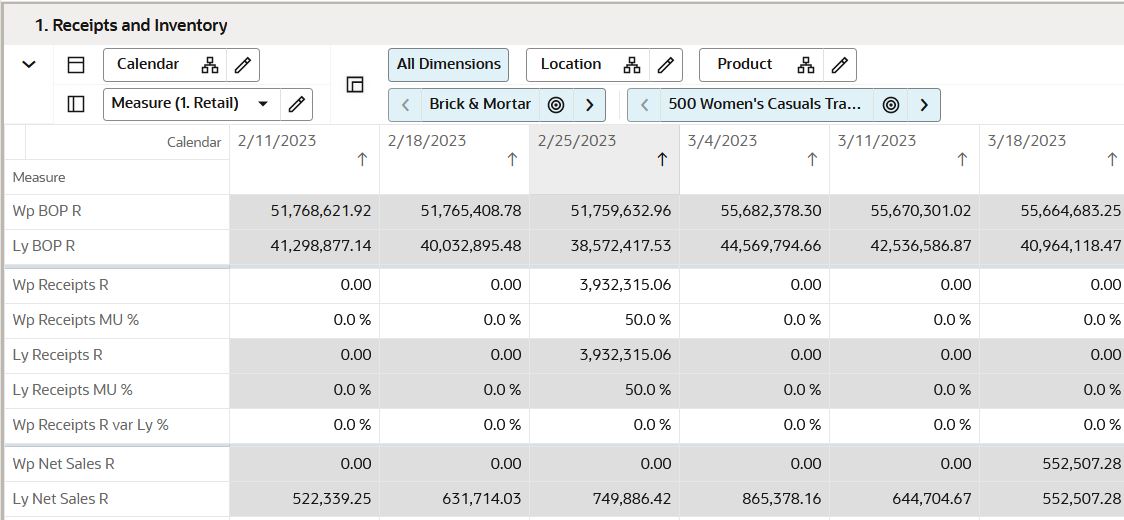

Inventory/Receipts Sub-Step
After you have developed the sales and markdown target, develop a receipts and inventory target that can support the planned sales and markdown. The purpose of this step is to ensure that you have a receipt and inventory plan that supports the sales that you are projecting.
Receipts and Inventory View
Receipts and Inventory is where you will plan Beginning-of-period (BOP)/End-of-period (EOP) inventory, receipts, turn, and so on. This view is frequently planned at a month level. At a month level, EOP is usually targeted to be about the same as BOP and then ramp up for holiday gift giving is factored in. After planning the month, it is wise to review the results at a week level to ensure there are no undesirable anomalies.
Stock to Sales Ratio is an important indicator of the effectiveness of the planned inventory. The stock to sales ratio is the proportion of inventory on hand at the beginning of a period (such as a week or month) that will support the planned sales in that period.
If the Stock to Sales Ratio rises, (due to an increase in inventory without an accompanying rise in sales), then you are adding more stock without increasing sales. Unless you are intentionally ramping up stock for holiday, promo, and so on, then it is time to hold off on receipts and work on selling down the quantity on that item. The ultimate goal is to reduce your Stock to Sales Ratio as low as possible, without losing sales.
This sub-step is not performed for W/F channels.
The adjustments you made to the Sales and Markdowns view are visible in this view if you have clicked Calculate.
There are several measure profiles available to guide you through various approaches to planning inventory and receipts:
Cost (Default)
The Cost profile is the default profile. The planning is focused on total retail cost rather than units, and sale type. This profile is the most comprehensive view of variables impacting inventory.
Inventory by Type
In this profile, you can review and maintain a breakdown of inventory by sales type, Regular + Promo, and clearance.
Units
The most important asset metrics are inventory units and inventory cost because these metrics impact cash flow. In this view, you can directly maintain EOP inventory, Average Unit Cost, plus shrink, Mark Out of Stock (MOS), and Move to Clearance (MOC) in terms of units.
Fulfillment Planning
This measure profile focuses on planning the impacts of Buy Online, Pickup in Store and Buy in Store, and Ship to Customer.
These fulfillment methods are relevant because inventory is planned for a channel based on its projected sales. When the sales are attributed to one channel but fulfilled by another, the fulfillment channel's inventory must reflect the increased inventory need (increased OTB).
Fulfillment Ly
This measure profile is used to review last year's fulfillment metrics in relation to planning the correct placement of inventory by channel.
Figure 8-11 Receipts and Inventory View

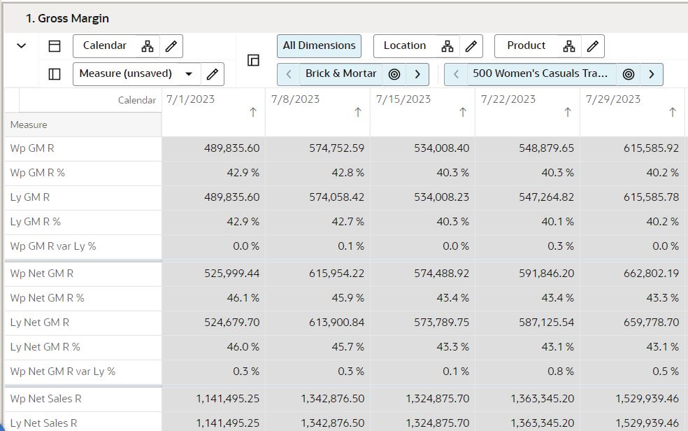

You build your plan with a close eye on gross margins and net gross margin. Gross Margin is a percentage (or ratio) of gross profit to net sales. Gross profit (expressed as Wp GM R) is the difference between net sales retail and net sales cost. Gross margin and gross profit are very important measures of the profitability and financial performance of a company.
Gross Margin View
Use the Gross Margin view to evaluate the gross margin created from your sales and markdown plan and receipts and inventory plan. Determine whether the planned gross margin meets your gross margin goal. If it does not, return to the Develop Sales and Markdown Plan and Develop Inventory and Receipt Plan steps to adjust your receipt markups and receipt flow. Finally, return to the Gross Margin view to adjust additional contributors to net gross margin such as vendor funds and royalties.
Figure 8-13 Gross Margin View

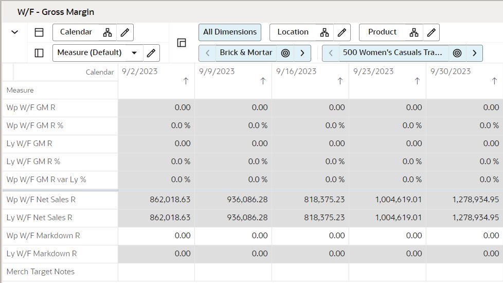

W/F - Gross Margin View
If the Wholesale Franchise option is provisioned, you plan W/F channels in this view.
Wholesale/Franchise sales are typically tracked and managed as a separate channel of a retail business. In the Wholesale/Franchise Gross Margin, you review the planned gross margin on your wholesale/franchise sales.
Figure 8-14 W/F - Gross Margin

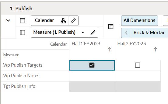

The Review and Publish Targets step is performed after you have completed creation or revision of targets in the Create Targets step. You can choose to review and publish many targets at once or one at a time as you complete building the targets of each Dept/Channel/Half.
The key action in this task is publishing the targets so that your planners can view them and begin to build their plans. To learn about the Planner's role, see Chapter 8.
If you need to revise your targets at any time during the pre-season, you can follow the same procedures described in this chapter. Since you have already created a working plan, there is no need to seed the task again, unless you want to start over with Ly (Last Year) or Fcst (Forecast) data.

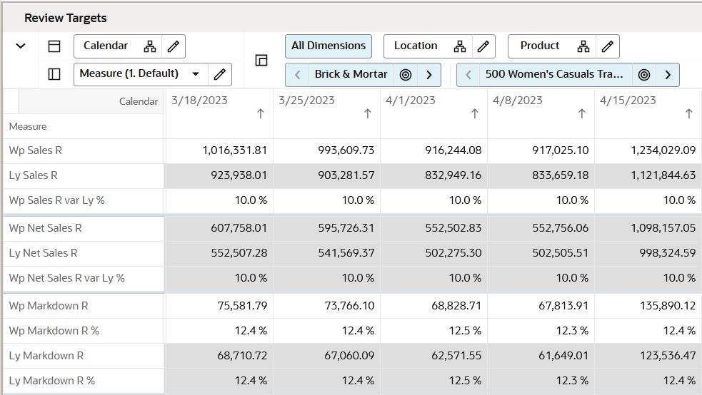

Review Targets Sub-Step

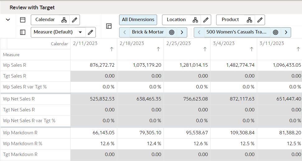

In this sub-step, review the targets you created in the previous step. If you need to alter the targets, return to the Create Targets step to make edits.
Review Targets View
There are several measure profiles in this view to quickly guide you to the plans you wish to review:
Default
This measure profile shows the main Working Plan metrics for comparison with last year metrics. This is the profile you will use after initially performing the Create Targets step.
Tgt with Cp
This measure profile shows the main Working Plan metrics for comparison with Current Plan metrics. Current Plan is a version of the plan that is approved in-season (and is actualized for elapsed/historical periods).
Tgt with Op
This measure profile shows the main Working Plan metrics for comparison with Original Plan metrics. Original Plan is the plan as it was initially approved-typically it got approved pre-season and stays fixed when the period becomes in-season.
Figure 8-15 Review Targets View
Publish Targets Sub-Step
Publishing a target copies the targets you built in the Wp measures to the target (Tgt) measures, and then commits them to the database. Once committed, Planners can retrieve those targets and take action planning to them.
The Tgt measures are shown in the Publish Targets view found in the Review and Publish Targets step. These measures initially have zero values. After the targets are published in this step, those measures are populated with the target information. There are two views within the Publish Targets Sub-step.
Publish Targets View
To publish the targets, complete the following steps.
Select the halves in the Wp Publish Targets measure that you want to publish.
If needed, enter relevant information in the Wp Publish Notes measure. This is optional.
Repeat Steps 1 and 2 for other channels and departments as desired.
Click Publish Targets. This button is located in the bottom right corner.
A success message is displayed. Click Dismiss to close it.
The view refreshes and clears the data in Wp Publish Targets and Wp Publish Notes measures. It populates the data for Tgt Publish Info measure as name:date:notes.

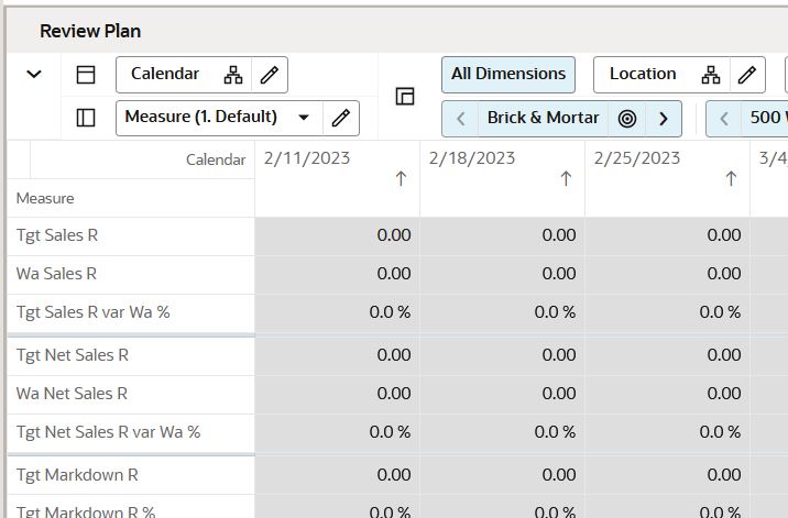

Review Plan Sub-Step
In the Review Plan sub-step, you directly compare the Planners Wa plan to the targets. There are several Tgt-to-Wa variance measures that quickly guide you to areas of difference.

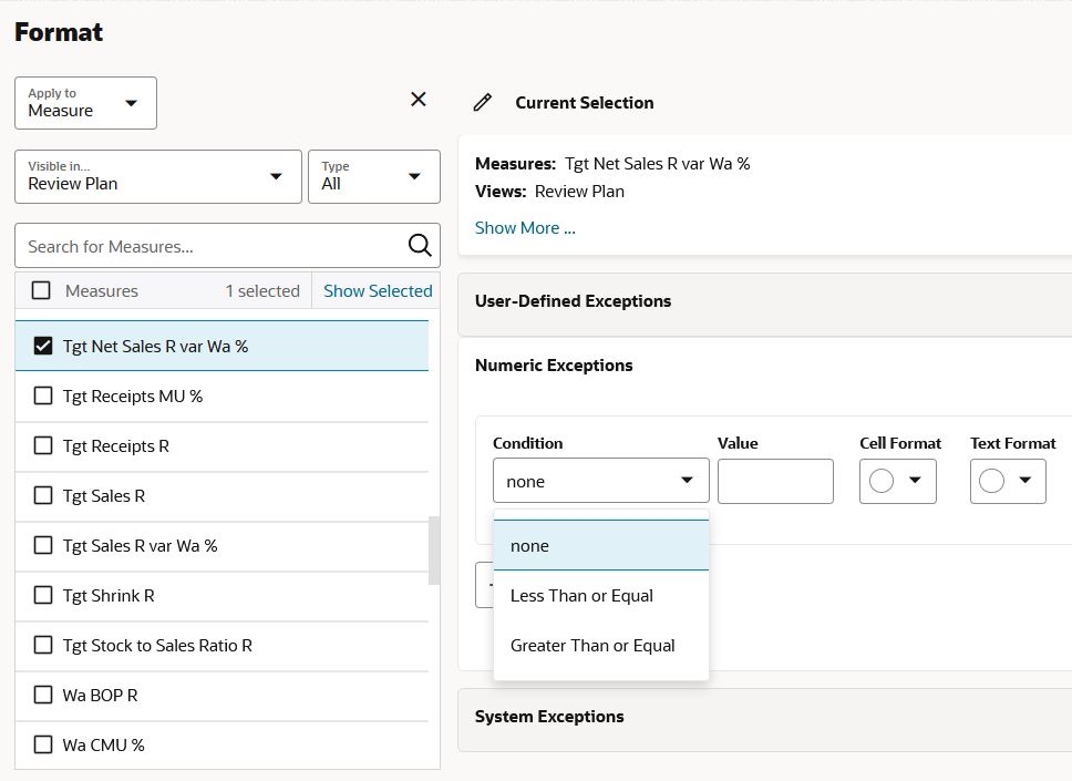

Tip:
Use exception formatting on the variance measures to highlight variances. To reach the formatting dialog, right click the measure label and choose Format from the popup menu.
Figure 8-16 Format Dialog
If plans have been published, republished, submitted, or resubmitted since you created the workspace, select Refresh from the Action menu to reload the latest values. A refresh will reload all data in the workspace to the last committed version, so you must commit all of your plan work first, or it will be reverted to the last point of commit.
Continue to the Approve step to set the plan's Approved status to either approved or rejected.

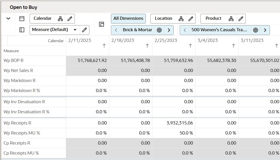

Open to Buy Sub-Step
This sub-step has one view.
Open to Buy View
Use Open to Buy (OTB) to understand the variance between the current planned receipts and the on order plus any on order adjustments. This variance is shown in the Wp OTB C measure. OTB indicate how many additional receipts can be purchased. Users should understand if their planned receipts keep them on the overall Cp EOP inventory plan. To understand the variance between the Cp EOP inventory plan and the Wp EOP inventory plan, reference the measure Wp EOP C var Cp%. Use this view to validate what OTB you have available and then start adjusting your plan. Then, confirm that your updates can be obtained given the OTB constraints you may have.
The following profiles are available:
Cost
This measure profile focuses on key metrics of total sales, markdowns, receipts, and on order to summarize open to buy.
Units
This measure profile focus on unit and average unit cost key metrics for sales, receipt, and on order.
Use the following best practices to adjust OTB:
To understand the difference between the current approved receipts and the net on order, compare Cp Receipts C to Wp Net On Order C.
If receipts are booked for upcoming (non-elapsed) periods, you can enter the Wp Receipt C data into the Wp On Order Adj C to capture the Wp OTB C measure. For example, this may occur if receipts book daily for the retailer, and OTB is completed on a Tuesday. By using the Wp On Order Adj measures, you can capture all receipts for comparing the Net On Order to the Cp receipt plan.
Figure 8-20 Open to Buy View
