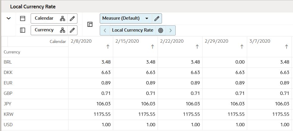

Local Currency Rate View
Within this view, you set the local currency conversion rate for each Channel by Week. The conversion rate is set in relation to the sales currency, often the corporate currency.
Figure 4-2 Local Currency Rate View
Table 4-2 Local Currency Rate View Measure
Measure Description
Local Currency Rate
The rate used to convert values from the primary currency to the local currency for a given Channel/Week.

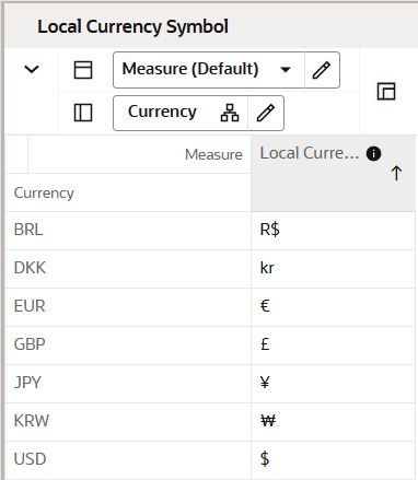

Local Currency Symbol View
Within this view, the planning administrator sets the local currency symbol for each channel. This currency symbol can be included as the Location attribute in all Local Currency views.
For example, in Figure 4-3 the BRA Brick & Mortar channel has R$ as its local currency symbol, which indicates that local currency values for this channel are in Brazilian Real. All local currency BRA Brick & Mortar monetary values are displayed with R$.
Figure 4-3 Local Currency Symbol View
Table 4-3 Local Currency Symbol View Measure
Measure Description
The graphic symbol associated with the channel's local currency.

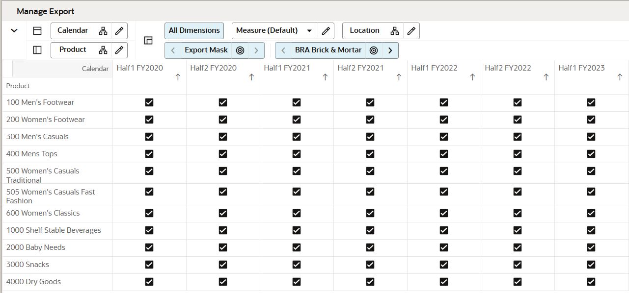

Manage Export View
Within this view, the planning administrator selects the positions that will be included when exporting plan data for all versions.
Figure 4-5 Manage Export View
Manage Export View
Table 4-6 Manage Export View Measure
Measure Description
Export Mask
Allows the user to control which positions are exported for all plan versions. When selected, the Department/Channel/Half is included when exporting plan data. By default, this Boolean is checked for all positions. If the user wants to exclude any Department/Channel/Half from exporting, the user must un-check this Boolean.
The export flags are set based on Export Mask and Approved or Submitted Info for Approved or Submitted Plans and Seeded Info for Working Plans.
