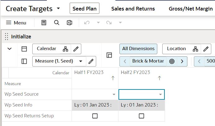

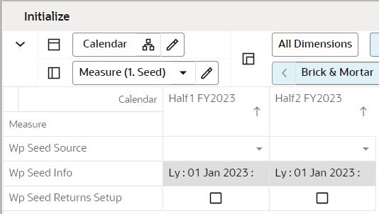

Seed Plan Sub-Step
The first action that the Planning Manager completes when creating new targets is to seed the plan within the Initialize view. In order to seed the plan, you can first review the LY plan and forecast in the Sales/Markdowns tab. This will help you determine which plan you will use for seeding.
Initialize View
With this view, you can choose to seed your plan with Last Year (Ly) or Forecast (Fcst) data to create a demand curve on which to spread the new plan's initial targets. Or, you can instead choose to not seed the plan, which allows you to create a plan that is not influenced by last year's performance or forecast (plus last year's performance).When seeding the plan, you can choose which information is seeded. For instance, you can seed just one half or all halves in the workspace. You can also choose what locations and products to seed.
Figure 8-1 Create Targets - Seed Plan: Initialize View
Table 8-1 Initialize View Measures
Measure | Description |
Seed Source |
The seed source used to seed the working plan. Use this option to seed or not seed the working plan. You can seed with Last Year's (Ly) or Forecast (Fcst) data. Or, you can choose the Blank option if you do not want to seed the working plan. |
Seed Info |
Includes a few pertinent facts about the last time that the Seed custom menu was executed: last seed source concatenated with last seeded date and the last user to seed. If blank, then the given intersection has never been seeded. |
Seed Returns Setup |
Use this option to seed the working plan returns. You can seed the returns values with Last Year’s (LY) or Forecast (Fcst) data. You can also choose the blank option if you do not want to seed the working plan returns. |
There are two ways you can seed. You can seed each level individually, or you can seed several levels at once by changing the dimension level shown in the view.

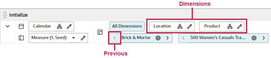

Seeding One Level at a Time
To seed one target at a time you will set the seed source information. Then, to seed the next department in the Product hierarchy within the Brick & Mortar channel, complete the following steps:
Click on the Dimension whose value (position) you want to change, as shown in Figure 8-2.
Click the Next or Previous arrow, as shown in Figure 8-2.
Figure 8-2 Changing a Dimension Level with Page Arrows
The page refreshes and the next position in the department level is displayed in the page edge. Notice that the Seed Source measure is not populated for this department.
Select the half that you want to seed with Ly or Forecast data.
Click the Next arrow to view and seed the next department.
When you have selected all the data you want to seed, click Seed in the bottom right corner.
Figure 8-3 Seed Button
A confirmation message is displayed, stating that the data has been successfully seeded. Click OK.
After you have seeded, the view refreshes and the Last Seed Source and Last Seed Date measures contain the source and date of the last seed.

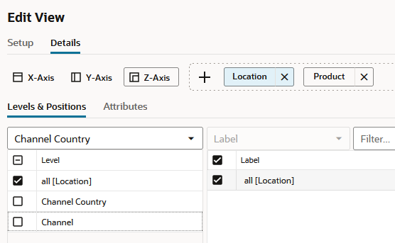

To change the level shown in the page edge or grid, complete the following steps:
Click the Edit View button of the dimension level you want to change.
Figure 8-4 Location Dimension Tile
The dimension window is displayed. Select the level of the dimension that you want to appear in the page edge. If you want to view more than one level at a time in the page edge or grid, select multiple levels. In Figure 8-5, Channel was deselected and all [Location] was selected instead.
Figure 8-5 Location Dimension Window
Click OK when finished.
Repeat Steps 1 through 3 for other dimensions if necessary.

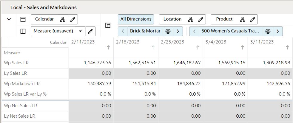

Select Local Currency View
The local currency chosen will be applied to the views of local currency found throughout the Create Merch Plan Targets task.
After selecting a currency, you can click Calculate to apply the rate. If you have not yet performed a seeding action, the rate will be applied at the time of seeding.

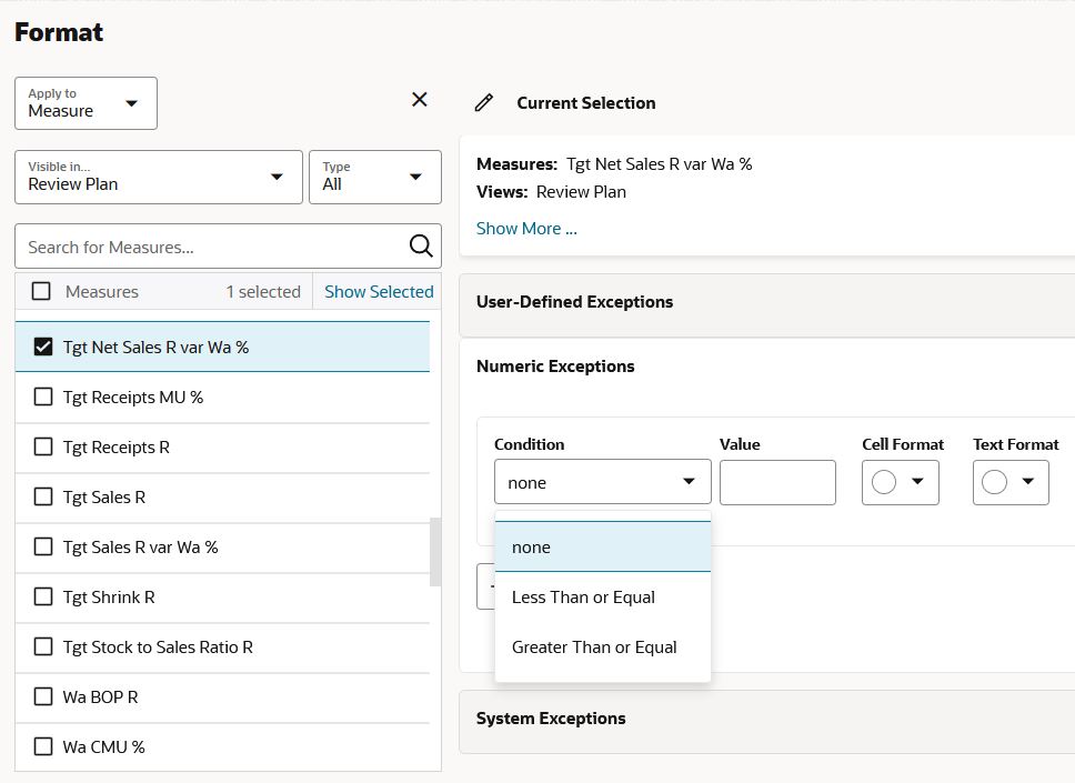

Set Alert Thresholds View
In this view, you set the threshold minimums (mins) and maximums (maxs) that will trigger alert formatting and alerts in the MT: Exceptions dashboard. The following table lists the conditions under which an alert is triggered. Thresholds must be non-zero to trigger alerts.
Threshold | Condition |
Wp GM R % Max Threshold |
Alert is green when Wp GM R % is greater than the threshold |
Wp GM R % Min Threshold |
Alert is red when Wp GM R % is less than the threshold |
Wp Markdown R % Max Threshold |
Alert is red when Markdown R % is greater than the threshold |
Wp Markdown R % Min Threshold |
Alert is green when Markdown R % is less than the threshold |
Wp Net Sales R Max Threshold |
Alert is green when Net Sales R is greater than the threshold |
Wp Net Sales R Min Threshold |
Alert is red when Net Sales R is less than the threshold |
Wp Returns R % Max Threshold |
Alert is red when Returns R % is greater than the threshold |
Wp Returns R % Min Threshold |
Alert is green when Returns R % is less than the threshold |
Wp Sell Thru R % Max Threshold |
Alert is green when higher than the threshold |
Wp Sell Thru R % Min Threshold |
Alert is yellow when less than the threshold |
Wp Do Not Alert |
Prevents alerting of the department/channels that are checked |

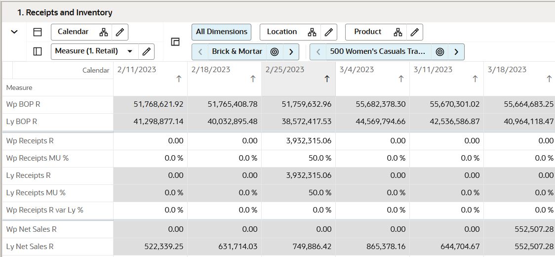

Receipts and Inventory View
Receipts and Inventory is where you will plan Beginning-of-period (BOP)/End-of-period (EOP) inventory, receipts, turn, and so on. This view is frequently planned at a month level. At a month level, EOP is usually targeted to be about the same as BOP and then ramp up for holiday gift giving is factored in. After planning the month, it is wise to review the results at a week level to ensure there are no undesirable anomalies.
Inventory turn is an important indicator of the effectiveness of the planned inventory. It tells you how many times stock is being sold and repurchased over a given period of time. The goal is to increase your turn as much as possible, without having to take markdowns. Turn (Wp CUM Turn R) is reviewed in this workspace view.
Another important indicator is Stock to Sales Ratio. The stock to sales ratio is the proportion of inventory on hand at the beginning of a period (such as a week or month) that will support the planned sales in that period.
If the Stock to Sales Ratio rises, (due to an increase in inventory without an accompanying rise in sales), then you are adding more stock without increasing sales. Unless you are intentionally ramping up stock for holiday, promo, and so on, then it is time to hold off on receipts and work on selling down the quantity on that item. The ultimate goal is to reduce your Stock to Sales Ratio as low as possible, without losing sales.
This sub-step is not performed for W/F channels.
There are several measure profiles available to guide you through various approaches to planning inventory and receipts.
The adjustments you made to the Sales and Markdowns view are visible in this view if you have clicked Calculate.
The following measure profiles are available:
Retail (Default)
The Retail profile is the default profile. The planning is focused on total retail rather than units, and sale type. This profile is the most comprehensive view of variables impacting inventory.
Inventory by Type
In this profile, you can review and maintain a breakdown of inventory by sales type, Regular + Promo, and Clearance.
Units
In this view, you can directly maintain EOP inventory, Mark Out of Stock (MOS), and Move to Clearance in terms of units.
Fulfillment Planning
This measure profile focuses on planning the impacts of Buy Online, Pickup in Store and Buy in Store, Ship to Customer.
These fulfillment methods are relevant because inventory is planned for a channel based on its projected sales. When the sales are attributed to one channel but fulfilled by another, the fulfillment channel's inventory must reflect the increased inventory need (increased OTB).
Fulfillment Ly
This measure profile is used to review last year's fulfillment metrics in relation to planning the correct placement of inventory by channel.
Use the following best practices to plan the receipts and inventory:
Plan the receipt flow and then evaluate the average inventory and turn.
Review the Receipts Markup (MU) for accuracy. Often this will follow the keystone 50%, but many variables can impact the decision on markup-from competitor pricing to freight costs, and overhead operating expense.
Review the Wp CMU % measure. Cumulative markup rate (CMU %) is a blend of the beginning of period (BOP) inventory retail and cost with the future receipt retail and receipt cost. The Wp CMU % directly affects the cost of goods sold (COGS), which then affects the gross margin.
Review the Wp Stock to Sales R ratio. Make adjustments to Sales and other inventory measures (Receipts, Move out of Stock, Move to Clr, and so on) to achieve the desired stock to sales ratio.
Figure 8-12 Receipts and Inventory View

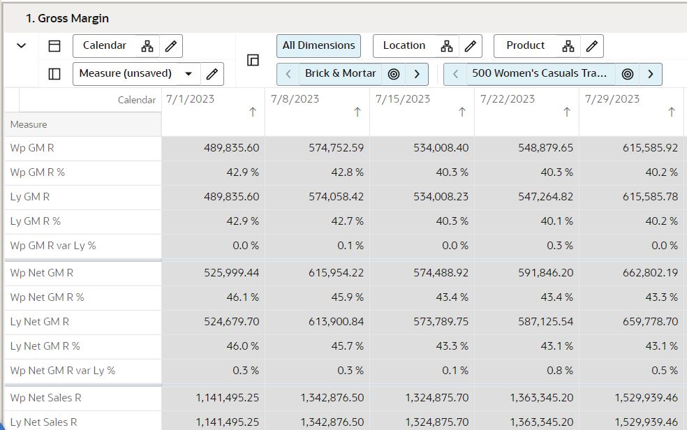

Gross Margin Sub-Step
You build your plan with a close eye on gross margins and net gross margin. Gross Margin is a percentage (or ratio) of gross profit to net sales. Gross profit (expressed as Wp GM R) is the difference between net sales retail and Cost of Goods Sold (COGS). Gross margin and gross profit are very important measures of the profitability and financial performance of a company.
Gross Margin View
Use the Gross Margin view to evaluate the gross margin created from your sales and markdown plan and receipts and inventory plan. Determine whether the planned gross margin meets your gross margin goal. If it does not, return to the Develop Sales and Markdown Plan and Develop Inventory and Receipt Plan steps to adjust your receipt markups and receipt flow. Finally, return to the Gross Margin view to adjust additional contributors to net gross margin such as vendor funds and royalties.
Figure 8-14 Gross Margin View

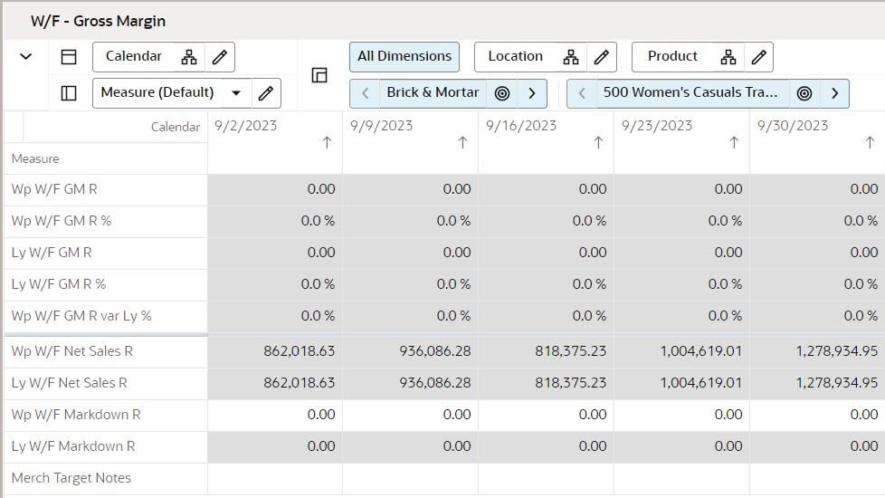

W/F - Gross Margin View
If the Wholesale Franchise option is provisioned, you plan W/F channels in this view.
Wholesale/Franchise sales are typically tracked and managed as a separate channel of a retail business. In the Wholesale/Franchise Gross Margin, you review the planned gross margin on your wholesale/franchise sales.
Figure 8-15 W/F - Gross Margin

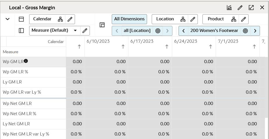

Local - Gross Margin View
If the Local Currency option is provisioned, then there is an additional view to support planning Gross Margin.
The key planning KPIs contributing to gross margin are available in local currency for cross-referencing and high-level planning.
Figure 8-16 Local - Gross Margin

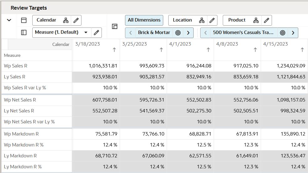

Review Targets View
There are several measure profiles in this view to quickly guide you to the plans you wish to review:
Default
This measure profile shows the main Working Plan metrics for comparison with last year metrics. This is the profile you will use after initially performing the Create Targets step.
Tgt with Cp
This measure profile shows the main Working Plan metrics for comparison with Current Plan metrics. Current Plan is a version of the plan that is approved in-season (and is actualized for elapsed/historical periods).
Tgt with Op
This measure profile shows the main Working Plan metrics for comparison with Original Plan metrics. Original Plan is the plan as it was initially approved-typically it got approved pre-season and stays fixed when the period becomes in-season.
Figure 8-17 Review Targets View

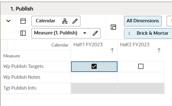

To publish the targets, complete the following steps.
Select the halves in the Wp Publish Targets measure that you want to publish.
If needed, enter relevant information in the Wp Publish Notes measure. This is optional.
Repeat Steps 1 and 2 for other channels and departments as desired.
Click Publish Targets. This button is located in the bottom right corner.
A success message is displayed. Click Dismiss to close it.
The view refreshes and clears the data in Wp Publish Targets and Wp Publish Notes measures. It populates the data for Tgt Publish Info measure as name:date:notes.
Figure 8-18 Publish Targets

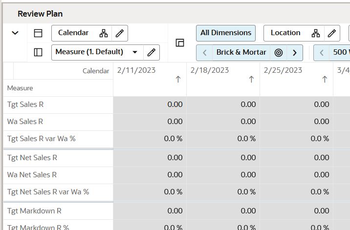

Review and Approve Plan Step
The Review and Approve Plan step is performed after the Planner has built a merch plan that aligns with the Targets you previously created and published. In the Create Merch Plan Task, the planner must submit their plan for approval at which point their working plan is copied into the Waiting Approval (Wa) plan version which you can view here.
The Approve sub-step is used to both approve and reject the submitted plan.
Review Plan Sub-Step
In the Review Plan sub-step, you directly compare the Planners Wa plan to the targets. There are several Tgt-to-Wa variance measures that quickly guide you to areas of difference.
Tip:
Use exception formatting on the variance measures to highlight variances. To reach the formatting dialog, right click the measure label and choose Format from the popup menu.
Figure 8-19 Format Dialog
If plans have been published, republished, submitted, or resubmitted, since you created the workspace, click the refresh menu option to reload the latest values. A refresh will reload all data in the workspace to the last committed version, so you must commit all of your plan work first, or it will be reverted to the last point of commit.
Figure 8-20 Refresh Menu Option
Continue to the Approve step to set the plan's Approved status to either approved or rejected.
Approve Sub-Step
In the Approve sub-step, you set the plan status to either Approved or Rejected. If rejected, the planner must rework their plan until it satisfactorily meets targets. For rejected plan, repeat the Review and Approve step once the planner resubmits the plan.
The Op Approve Enabled indicator controls whether or not a plan can be submitted for Op approval. This indicator is usually set to False after all plans are approved, before the plan becomes in-season. This setting can be modified by the system administrator. If false, approved plans can only be promoted to Cp, and not Op.
Once approved, the Wa Plan gets copied to Original Plan (Op) and Current Plan (Cp) version.

Open to Buy Sub-Step
This sub-step has one view.

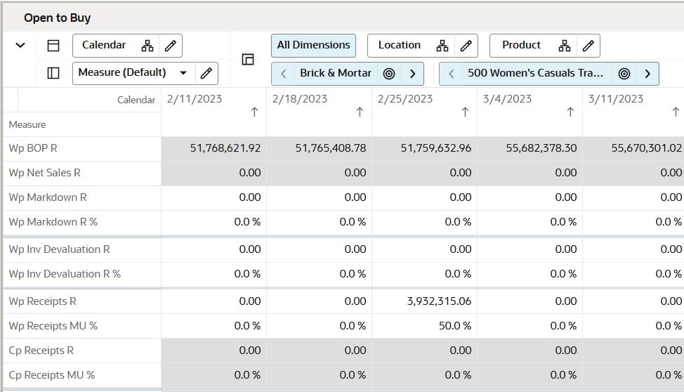

Open to Buy View
Use Open to Buy (OTB) to understand the variance between the planned and projected inventory levels. This variance is shown in the Wp OTB R measure. OTB indicate how many additional receipts can be purchased (or canceled) after projected sales and markdowns. Users should understand if their planned receipts keep them on the overall Cp EOP inventory plan. To understand the variance between the Cp EOP inventory plan and the Wp EOP inventory plan, reference the measure Wp EOP R var Cp%. Use this view to validate what OTB you have available and then start adjusting your plan. Then, confirm that your updates can be obtained given the OTB constraints you may have. Use the following best practices to adjust OTB:
To understand the difference between the current approved receipts and the net on order, compare Cp Receipts R to Wp Net On Order R.
If receipts are booked for upcoming (non-elapsed) periods, you can enter the Wp Receipt R data into the Wp On Order Adj R to capture the Wp OTB R measure. For example, this may occur if receipts book daily for the retailer, and OTB is completed on a Tuesday. By using the Wp On Order Adj measures, you can capture all receipts for comparing the Net On Order to the Cp receipt plan.
This view has two measure profiles:
Default
This measure profile focuses on key metrics of total sales, markdowns, receipts, and on order to summarize open to buy.
Units
This measure profile focuses on unit and average unit cost key metrics for sales, receipt, and on order.
Figure 8-22 Open to Buy View
