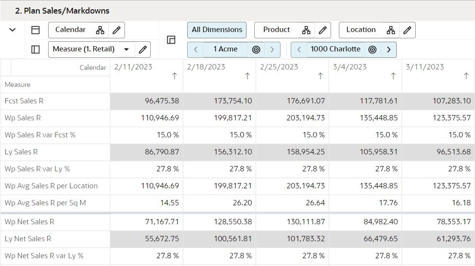

2. Plan Sales/Gross Margin % View
In the Plan Sales/Gross Margin % view, you plan sales, returns, and gross margins for each location.
Figure 10-1 2. Plan Sales/Gross Margin % View

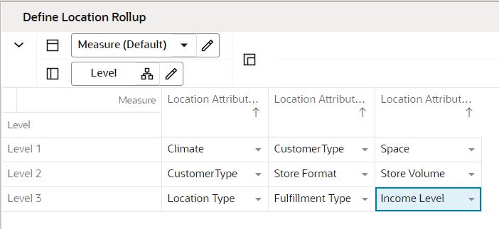

Define Location Rollup
The Define Location Rollup view is used to select location attributes to view in an alternate hierarchy. Nested location attribute roll up is provided with three levels. A planner can set up to three different combinations for nested rollup with a maximum of three levels in each combination. Nesting of dynamic attributes is a configurable option. For example: As a first combination, you select Climate as a Level 1, Customer Type as Level 2, and Store Format as Level 3 by clicking the list of attributes available. This allows you to roll up your location by Climate, then Customer Type inside each Climate and then by Store Format inside each customer type. This feature also allows you to view subtotals for each of the levels. You can edit subtotals and spread the values to all the associated child positions.
Perform the following steps to complete this process:
Select up to three dynamic location attributes from the list.
Run the Refresh Location Rollup Application Action.
To view the location attribute:
In a view that displays location level, click the Location Hierarchy tile.
Select the attribute (Attribute 1 or 2 or 3) that you would like to view in the nested dynamic rollup.
Click OK.
Figure 10-2 Define Location Rollup

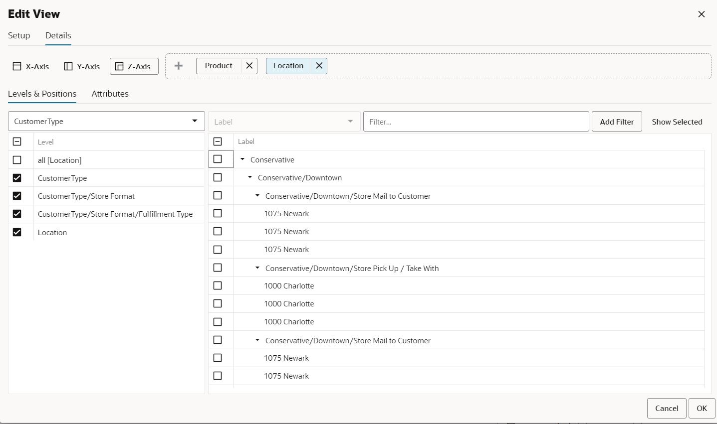

Figure 10-3 Edit View
Table 10-2 Define Location Rollup View Measure
| Label | Definition |
Location Attribute 1, 2, 3 |
List to present location attributes for nested dynamic product hierarchy rollup |

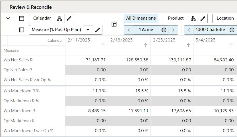

Review and Reconcile View
This view provides a comparison between key Wp targets and location plan sales figures. This view has measure profiles defined to quickly guide your comparison of different location plan versions:
PoC Op Plan (Default)
The Point of Commerce (PoC) Op profile is shown by default when the workspace is opened. This measure profile shows the Wp target measures and Location Plan Op measures.
PoC Cp Plan
This profile shows the Wp target measures and Location Plan Cp measures.
Figure 10-4 Review & Reconcile View

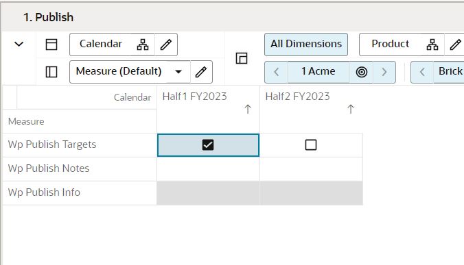

Publish View
To publish the targets:
Place a checkmark in the Wp Publish Targets measure for the halves that you want to publish.
If desired, enter relevant information in the Wp Publish Notes measure. This is optional.
Repeat Steps 1 and 2 for other channels as desired.
Click Publish Targets. This button is located in the bottom right corner.
A success message is displayed. Click Dismiss to close it.
The view refreshes and clears the data in Wp Publish Targets and Wp Publish Notes measures. The action has populated Tgt Publish Info with name:date:notes.
Figure 10-5 Publish View

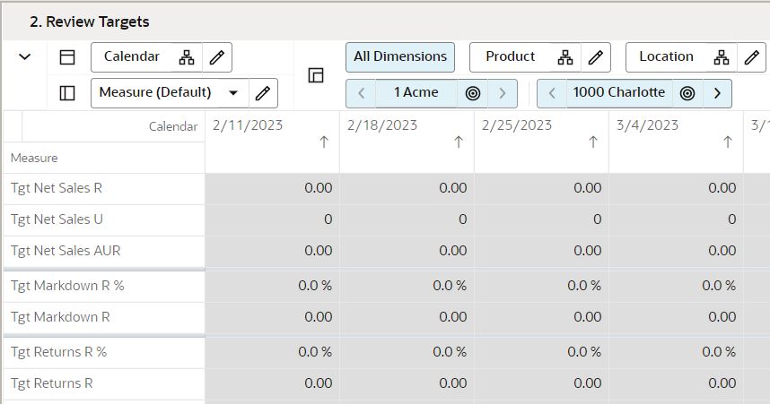

Review Targets
This view can be used to verify and review the currently published targets. The targets in this view are static and not editable. Changes to targets must be executed in the Wp plan and then published into the Tgt version.
If plans have been published or republished since you created the worksheet, click Refresh to reload the latest values. A refresh will reload all data in the worksheet to the last committed version.
Figure 10-6 Review Targets View
