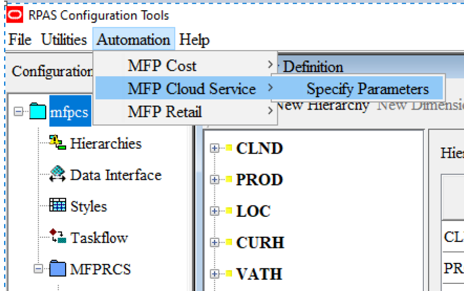

From Automation, select MFP Cloud Service and then Specify Parameters.
Figure A-1 Specify Parameters

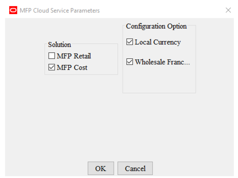

From the Service Parameters dialog box, select MFP Cost and clear the MFP Retail Solution.
Select or clear any Configuration Options.
Click OK.

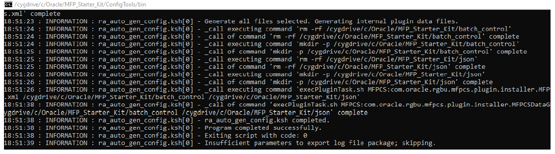

ra_auto_gen_config.ksh -c /cygdrive/c/Oracle/MFP_Starter_Kit -n mfpcs -genAllFiles
The script should run and complete with non-zero return code as shown in Figure A-3.

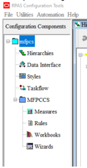

Open the configuration using RPAS Cloud Edition Configuration Tools and verify that solution now shows as MFPCCS.
Figure A-4 Verify the Solution
