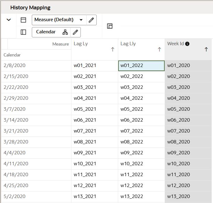

History Mapping Step
The History Mapping step is used by the administrator to map the weeks for last year and last last year (two years ago).
The History Mappings step contains one view, History Mapping.
History Mapping View
When a new calendar year is loaded, these values are automatically populated for the new year by the weekly batch. Use this view to make any updates needed in week mapping to most accurately account for moving holidays, promotions, and also to set up 52 to 53 week mappings.
The last year's (Ly) mapping is used to identify which week to map to in order to Seed from Ly, and review Ly values in a workspace.
The last last year (Lly) is used to identify which week to map to for reviewing history from two years prior in a workspace.
A week can be mapped to more than one Ly or Lly week to account for 53 week years. Separate weeks with a comma. If more than one week needs to be assigned, then those week positions should be separated with a space. Those week positions data will then be aggregated.
Figure 4-1 History Mapping View
Table 4-1 History Mapping View Measures
| Measure | Description |
Lag Ly |
Identifies the week used for mapping as adjusted last year. |
Lag Lly |
Identifies the week that is being used for mapping as last last year (two years ago). |
Week ID |
Identifies the internal week position for the current week for reference. This is useful for copying week positions when manually setting Lag Ly and Lag Lly. |

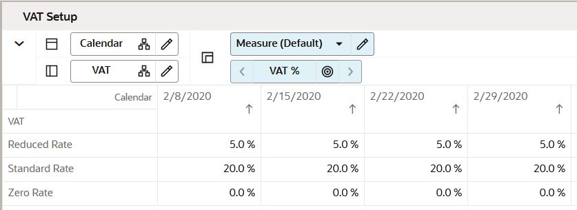

VAT Setup Step
The VAT Setup step allows a planning administrator to enter the Value Added Tax (VAT) rate for each subclass by week.
The VAT Setup step contains a single view, VAT Setup.
VAT Setup View
In this view, the planning administrator inputs the VAT% (sales) and VAT C % (cost rate).
When planning sales retail, the VAT% rate is applied to gross sales and then returns are subtracted to calculate net sales. If no VAT% rate is planned, then net sales are simply determined as gross sales less returns.
VAT Rate% is stored at Week/Subclass/Channel.
Figure 4-4 VAT Setup View
Table 4-4 VAT Setup View Measures

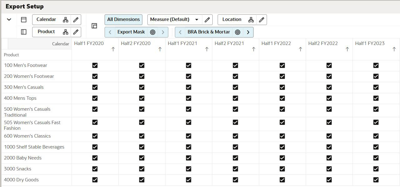

Export Setup View
Within this view, the planning administrator selects the positions that will be included when exporting plan data for all versions.
Figure 4-5 Export Setup View
Table 4-6 Export Setup View Measure
Export Mask |
Allows the user to control which positions are exported for all plan versions. When selected, the Department/Channel/Half is included when exporting plan data. By default, this Boolean is checked for all positions. If the user wants to exclude any Department/Channel/Half from exporting, you must clear this Boolean. |
The export flags are set based on Export Mask and Approved or Submitted Info for Approved or Submitted Plans and Seeded Info for Working Plans.
