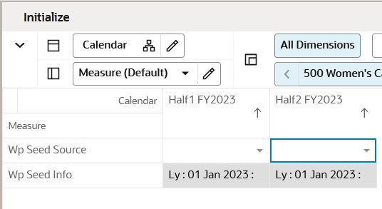

Seed Plan Sub-Step
The first action to take when creating a new plan is to seed the plan.
Initialize View
With this view, you can choose to seed your plan Last Year (Ly), Forecast (Fcst), or Targets (Tgt) data to create a demand curve on which to initially spread the new plan. Or, you can instead choose to not seed the plan, which allows you to create a plan that is not influenced by last year's performance or forecast (plus last year's performance).

Wp Seed Source |
The seed source used to seed the working plan. Use this option to seed or not seed the working plan. You can seed with Forecast (Fcst) or Target data. Alternatively, choose the Blank option if you do not want to seed the working plan. |
Wp Seed Info |
Includes a few pertinent facts about the last time that the Seed custom menu was executed: last seed source concatenated with last seeded date and the last user to seed. If blank, then the given intersection has never been seeded. |

Initialize View
With this view, you can choose to seed your plan with Last Year (Ly) or Forecast (Fcst) data to create a demand curve on which to spread the new plan's initial targets. Or, you can instead choose to not seed the plan, which allows you to create a plan that is not influenced by last year's performance or forecast (plus last year's performance).
When seeding the plan, you can choose which information is seeded. For instance, you can seed just one half or all halves in the task. You can also choose what locations and products to seed.

Seed Source |
The seed source used to seed the working plan. Use this option to seed or not seed the working plan. You can seed with Last Year's (Ly) or Forecast (Fcst) data. Alternatively, choose the Blank option if you do not want to seed the working plan. |
Seed Info |

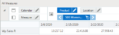

There are two ways you can seed. You can seed each level individually, or you can seed several levels at once by changing the dimension level shown in the view.
Seeding One Level at a Time
To seed one target at a time, you set the seed source information. Then, to seed the next department in the Product hierarchy within the current channel, complete the following steps:
Click the dimension whose value (position) you want to change.
Click the Next or Previous arrow, as shown in Figure 11-2.
Figure 11-2 Changing a Dimension Level with Page Arrows
The page refreshes and the next department is displayed in the page edge. Note that the Seed Source measure is not populated for this department.
Select the half that you want to seed with Ly or Forecast data.
Click the Next arrow to view and seed the next department.
When you have selected all the data you want to seed, click Seed in the bottom right corner.

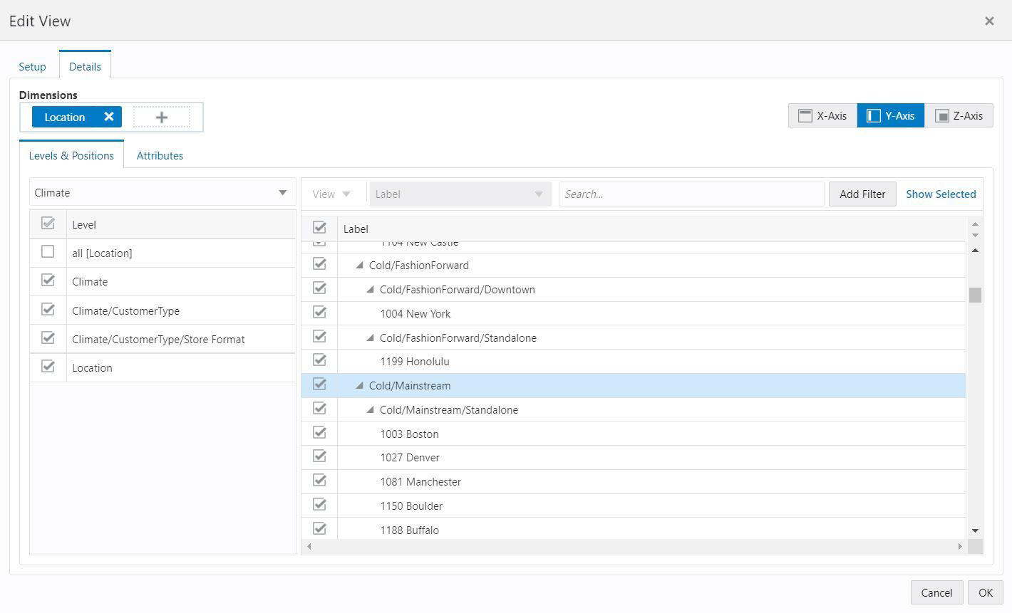

Seeding Several Levels at Once
The default setting of the Initialize Plan view is set to show the Half dimension of the Calendar, the Channel dimension of the Location hierarchy, and the Subclass dimension of the Product hierarchy.
To change the dimension level shown in the page edge or grid, complete the following steps:
Click the Edit View button of the dimension tile you want to change.
Figure 11-4 Location Tile — Edit View Button
The dimension window is displayed. Select the level of the dimension that you want to appear in the page edge. If you want to view more than one level at a time in the page edge or grid, select multiple levels. In the following image the, Channel was deselected and all [Location] was selected instead.
Figure 11-5 Location Dimension Selection Window
Click OK when finished.
Repeat Steps 1 through 3 for other dimensions if necessary.
After the dimensions are at the level you want, select the halves that you want to seed.
In the following image Figure 11-6, both the Location and Product dimensions are at the highest level, Company, and the half Half1 FY2023 are set to seed from last year.

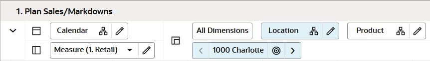

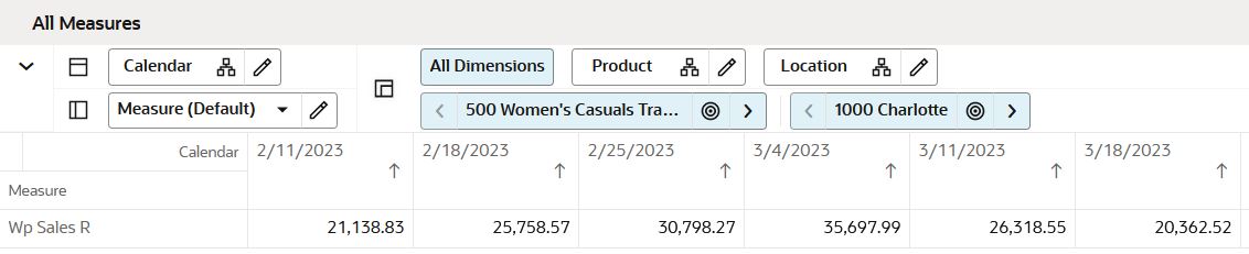

Sales and Markdowns Sub-Step

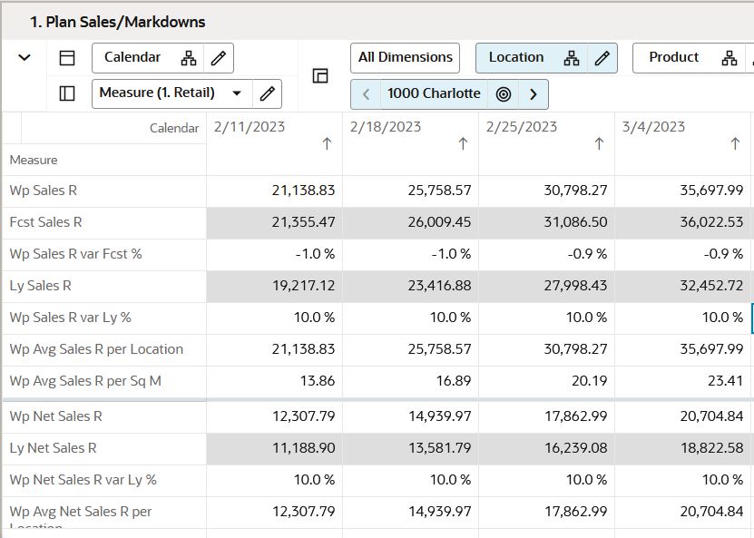

After seeding, you can verify the seeded sales and markdown data in this view.
Figure 11-7 Plan Sales and Markdowns View
You can verify the seeded sales and markdown data in this view. After you have seeded, develop the sales and markdown location plan for those departments.
If you are planning a Wholesale/Franchise location, use this view to plan Net Sales. Then use the W/F Sales and Markup View to complete planning.

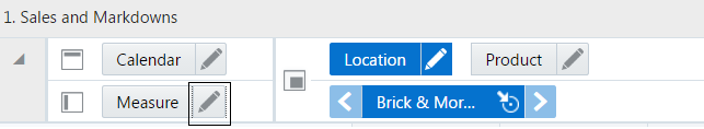

There are several measure profiles available to logically guide you through the plan variables.
A measure profile is selected by clicking the Edit View button next to the Measure tile.
Figure 11-8 Location of Edit View Button
The following measure profiles are available:
Sales (Default)
The sales measure profile shows the key sales planning metrics including sales, net sales, and returns.
To use the Average Sales/Net Sales/Returns Per Location measures to see averages, you must rollup the Location Dimension to a level above Location. The average calculated is limited to the average of the active locations of the workspace segment. A segment with one location will have an average equal to the Wp. In the same way, a level with only a single location which rolls up to it will also have an average equal to the Wp.
Markdowns
The markdowns measure profile shows sales against markdowns.
To use the Average Sales/Net Sales/Markdowns Per Location measures to see averages, you must rollup the Location Dimension to a level above Location. The average calculated is limited to the average of the active locations of the workspace segment. A segment with one location will have an average equal to the Wp. In the same way, a level with only a single location which rolls up to it will also have an average equal to the Wp.

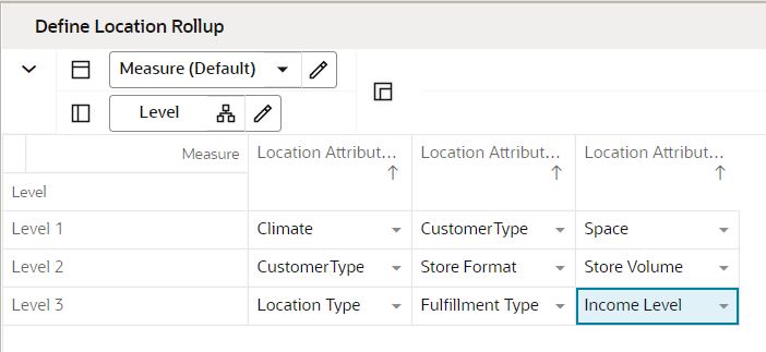

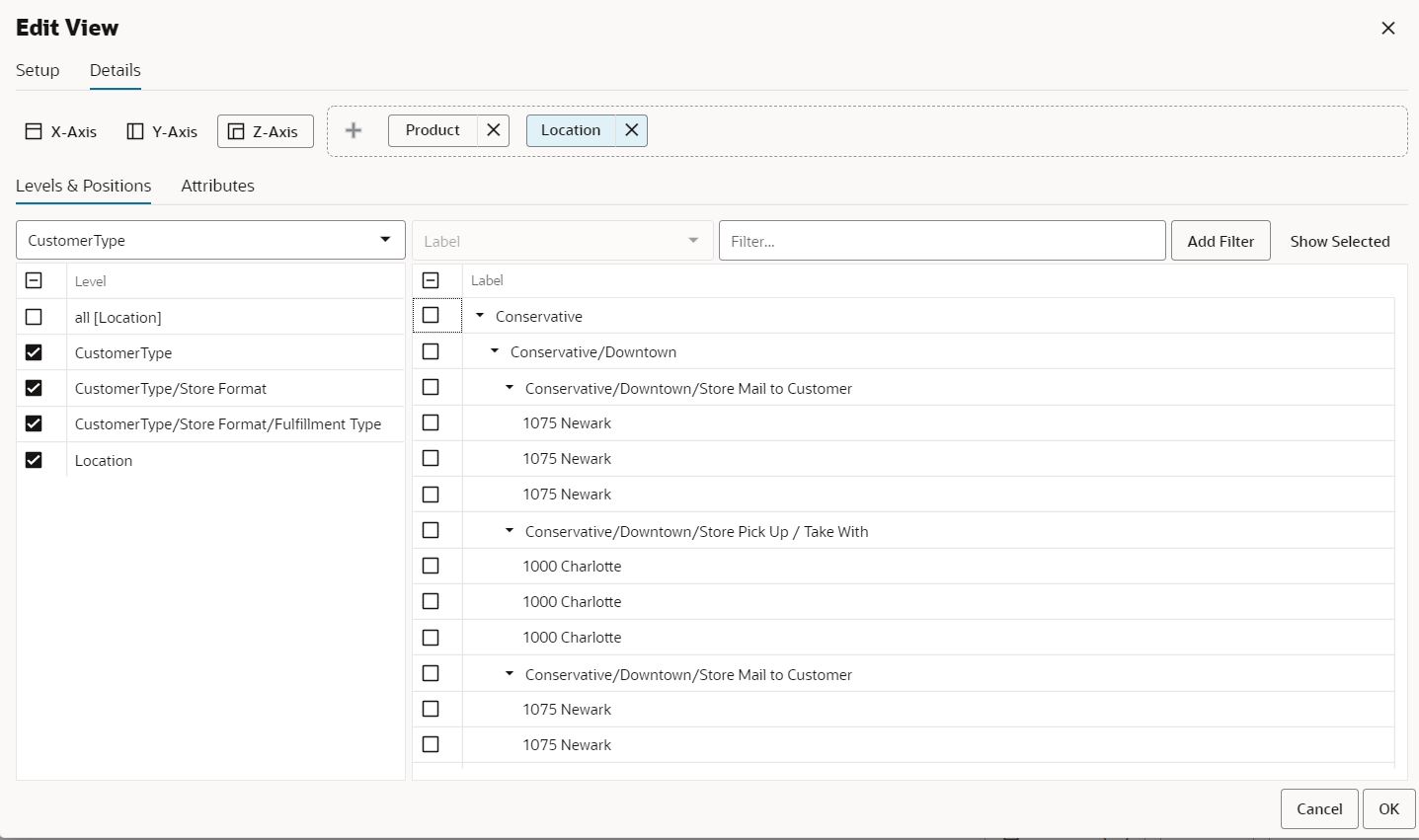

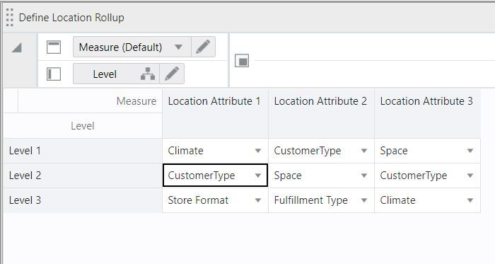

Define Location Rollup
The Define Location Rollup view is used to select location attributes to view in an alternate hierarchy. Nested location attribute roll up is provided with three levels. A planner can set up to three different combinations for nested rollup with a maximum of three levels in each combination. Nesting of dynamic attributes is a configurable option. For example: As a first combination, you select Climate as a Level 1, Customer Type as Level 2, and Store Format as Level 3 by clicking the list of attributes available. This allows you to roll up your location by Climate, then Customer Type inside each Climate and then by Store Format inside each customer type. This feature also allows you to view subtotals for each of the levels. You can edit subtotals and spread the values to all the associated child positions.
Perform the following steps to complete this process:
Select up to three dynamic location attributes from the list.
Run the Refresh Location Rollup Application Action.
To view the location attribute:
In a view that displays location level, click the Location Hierarchy tile.
Select the attribute (Attribute 1 or 2 or 3) that you would like to view in the nested dynamic rollup.
Click OK.
Figure 11-11 Define Location Rollup
Figure 11-12 Edit View

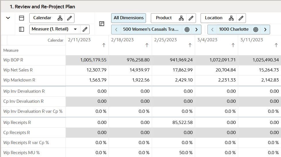

Review and Reconcile to MFP Step

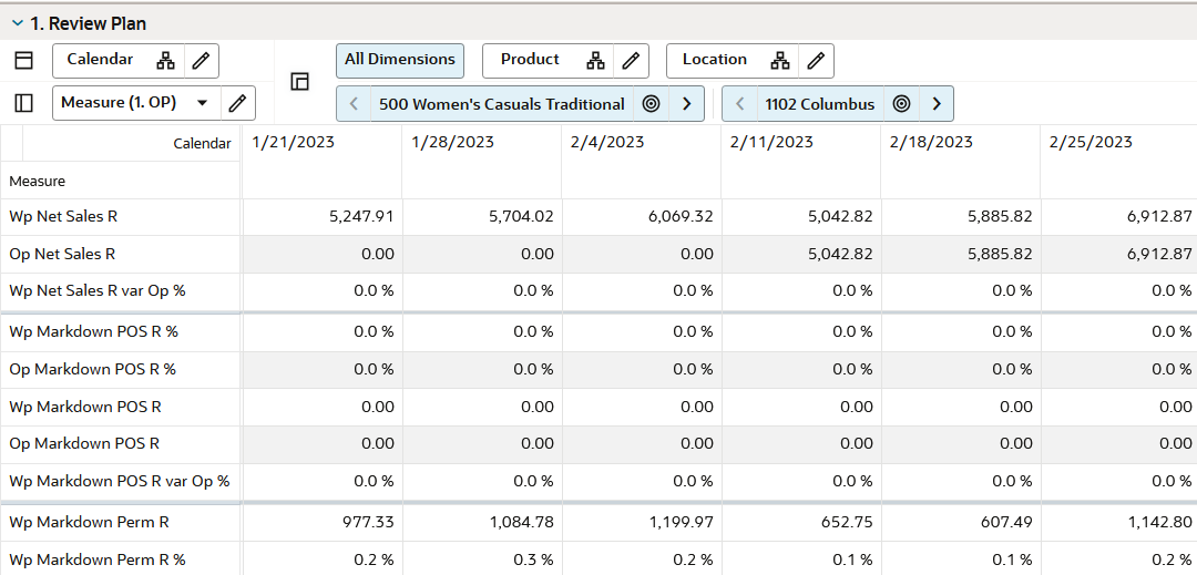

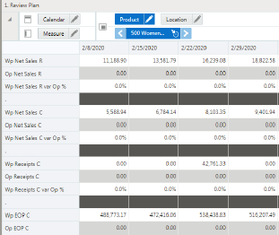

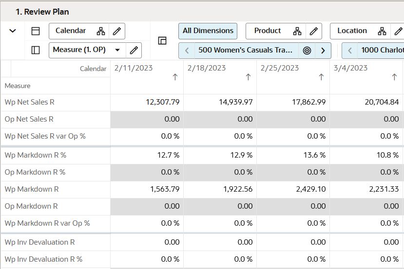

In this step, review and compare your plan to ensure the goals set forth in the merch plan are being met.
Review and Reconcile View
When you believe you are ready to approve your Location plans, use the Review Plan view to make sure the location plan meets merchandise planners expectations.
There are several measure profiles in this view to quickly guide you to the plans you wish to review:
MFP OP
This measure profile shows the main Working Plan metrics for comparison with Original Plan metrics from the Create Merch Plan Task. Original Plan is the plan as it was initially approved. Typically, it got approved pre-season and stays fixed when the period becomes in-season.
MFP CP
This measure profile shows the main Working Plan metrics for comparison with Current Plan metrics from the Create Merch Plan. Current Plan is a version of the plan that is approved in-season (and is actualized for elapsed/historical periods).

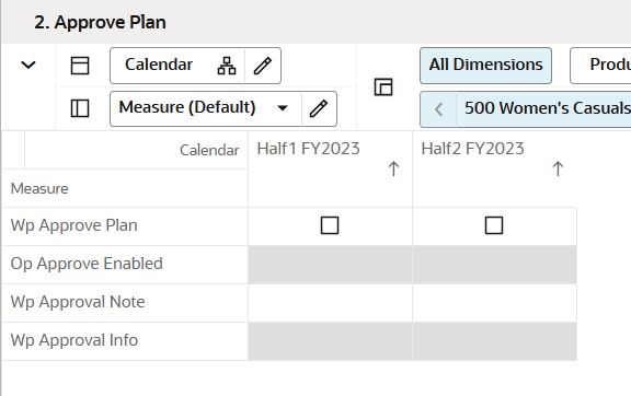

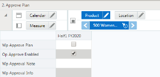

Review and Approve Step
In this step, the location planner can review and approve the created location plan. The Review and Approve step contains two views: Review Plan and Approve Plan.

Review and Reconcile with MFP Sub-step
In this step, review and compare your plan to ensure the goals set forth in the Merch Plan are being met. This sub-step has two views:
Define Location Roll up View
Use the MFP OP and the MFP CP measure profiles to reconcile your location plan to the Merch Plan.
Define Location Roll Up View
Click OK.
Figure 11-14 Define Location Rollup View
A measure profile is selected by clicking on the Edit View button next to the Measure tile.
Figure 11-15 Edit View
Sales and Returns Sub-step
After pre-season plan, review the sales return plan during In-season. This has similar views and measures as Sales and Returns steps from pre-season step.
Plan Sales / Markdown
Local – Sales / Markdown
W/F Sales and Markdown
Inventory and Gross Margin Sub-step
The Planner can use this sub-step to review the inventory and margins against the target during In-season process. This step has similar views and measures as Inventory and Gross Margin sub-step from pre-season step.
Plan Receipts and Inventory
Gross margin
Local – Gross Margin
W/F Gross Margin
Review and Re-Approve Step
Use this step to review the location plan during in-season for On Order and Open to Buy and to update the plan and reapprove if necessary. The Review and Re-Approve step has two views: Review and Re-Project Plan and Approve Plan.
