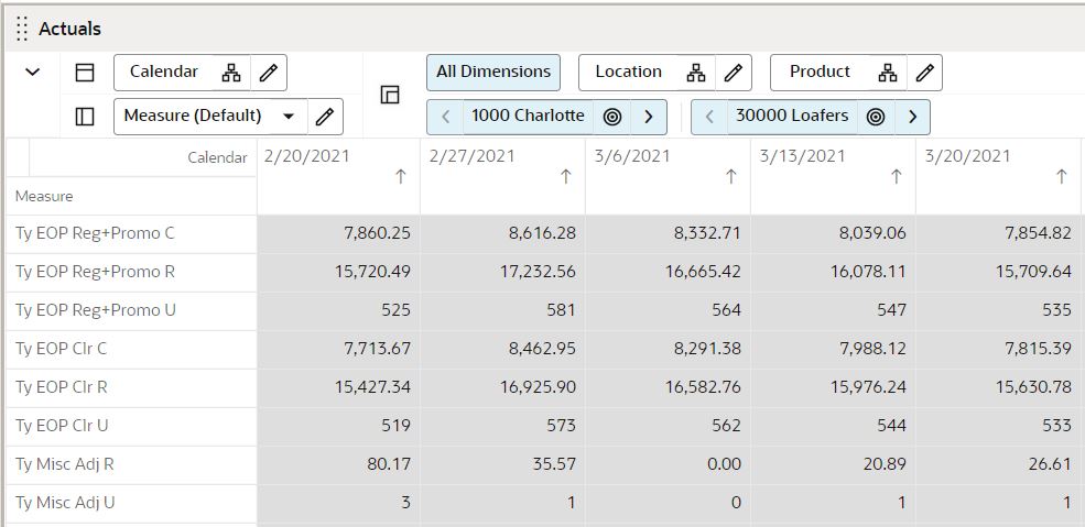

The Actuals step includes a single view of the same name, the Actuals view. Use this view to validate that the actuals data was loaded in the batch process.
Figure 7-1 Actuals View

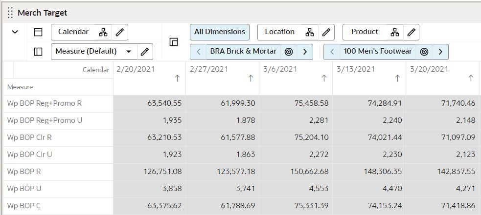

Merch Target Step
The Merch Targets step includes a single view of the same name, the Merch Target view. In this view, you can review or correct aspects of the Targets plan.
Figure 7-2 Merch Target View
