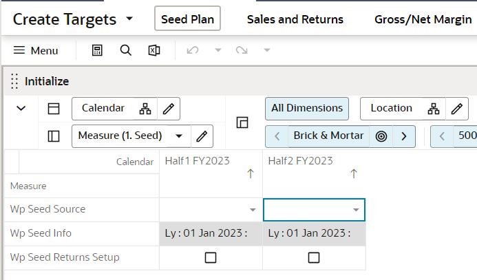

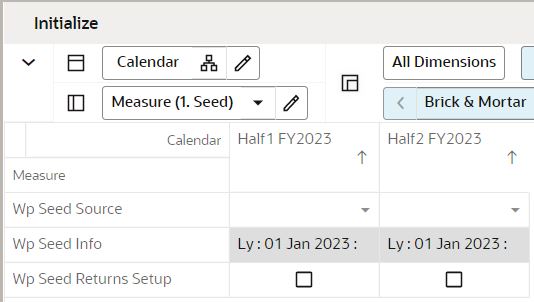

Seed Plan Sub-Step
The first action that the Planning Manager completes when creating new targets is to seed the plan within the Initialize view. In order to seed the plan, you can first review the LY plan and forecast in the Sales/Markdowns tab. This will help you determine which plan you will use for seeding.
Initialize View
With this view, you can choose to seed your plan with Last Year (Ly) or Forecast (Fcst) data to create a demand curve on which to spread the new plans initial targets. Or you can instead choose to not seed the plan, which allows you to create a plan that is not influenced by last years performance or the forecast (plus last years performance) result. When seeding the plan, you can choose which information is seeded. For instance, you can seed just one half or all halves in the workspace. You can also choose what locations and products to seed.
Figure 8-1 Create Targets - Seed Plan: Initialize View
Table 8-1 Initialize View Measures
Measure Description
Seed Source
The seed source used to seed the working plan. Use this option to seed or not seed the working plan. You can seed with Last Year (Ly) or Forecast (Fcst) data output. Or, you can choose the blank option if you do not want to seed the working plan.
Seed Info
Includes a few pertinent facts about the last time that the Seed custom menu was executed: last seed source concatenated with last seeded date and the last user to seed.
If blank, then the given intersection has never been seeded.
Seed Returns Setup
Use this option to seed the working plan returns. You can seed the returns values with Last Year (LY) or Forecast (Fcst) data. You can also choose the blank option if you do not want to seed the working plan returns.

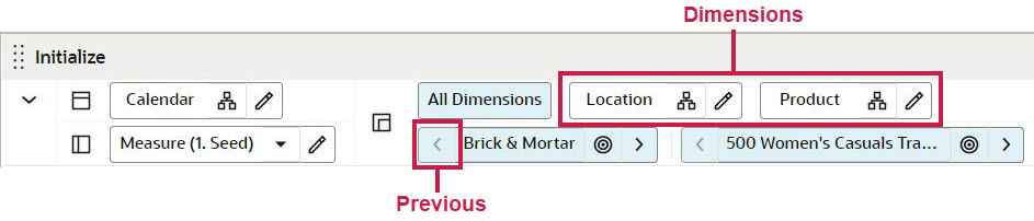

Seeding One Level at a Time
To seed one target at a time you will set the seed source information. Then, to seed the next department in the Product hierarchy within the Brick & Mortar channel, complete the following steps:
  1. Click on the Dimension whose value (position) you want to change, as shown in Figure 8-2.
  2. Click the Next or Previous arrow, as shown in Figure 8-2.
    Figure 8-2 Changing a Dimension Level with Page Arrows
  3. The page refreshes and the next position in the department level is displayed in the page edge. Notice that the Seed Source measure is not populated for this department.
  4. Select the half that you want to seed with Last Year (LY) or Forecast data.
  5. Click the Next arrow to view and seed the next department.
  6. When you have selected all the data you want to seed, click Seed in the bottom right corner.
  7. A confirmation message is displayed, stating that the data has been successfully seeded. Click OK.
    After you have seeded, the view refreshes and the Last Seed Source and Last Seed Date measures contain the source and date of the last seed.

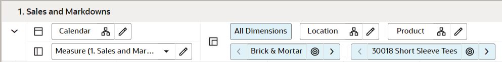

Sales and Markdowns View
In the Sales and Markdowns view, you plan net sales, promotions, and markdowns. Sales are the revenue generated by selling goods or services. Regular priced sales yield the greatest margin, however successful promotions drive more traffic and completion of sales. Though the promotional sale likely includes markdown, the overall increase in sales should outweigh the markdown and drive at good margins.
There are several measure profiles available to logically guide you through the plan variables.
A measure profile is selected by clicking on the Edit View button next to the Measure tile.
Figure 8-6 Edit View Button
Edit View Button
The following measure profiles are available:
  • Sales and Markdowns (Default)
    The measures in this profile represent totals which are not broken down by type of sale such as Promo, clearance, and so on. This view also incorporates the forecast for viewing on top of all Ly actuals.
  • Sales by Type
    The measures in this profile display and capture sales and returns figures by type of sale: Regular + Promotional, and Clearance. Regular + Promo, and Clearance added together equate to the total sale or total return.
    Start by planning the regular sales. Then, using your marketing calendar as a guide, align the promotional sales to the calendar. Refer to the calendar again for the exit weeks for the products, and plan the clearance sales for those weeks.
    The planned figures for these sales types populates the Wp Sales R measure.
  • Markdowns by Type
    Markdown is the difference between the original retail price and the actual selling price. The measures in this profile display and capture markdown figures as a total as well as by sales type: Regular + Promotional, and Clearance. The markdown types added together equate to the markdown (Wp Markdown POS R).
  • Units
    Some lines of businesses may prefer to build the plan, or at least closely couple the financial plan, by sales in terms of units. You also use this view to review the Average Unit Retail (AUR) to ensure it aligns with your strategic plans for the department.
  • Direct
    This measure profile contains the KPIs for direct-to-consumer channels.
  • Fulfillment Planning
    This measure profile is focused on planning returns which result from Online purchases which are returned to the store. Often a significant portion of those returns are then sent back to the Online Fulfillment warehouses. These returns are rightfully attributed to the Direct channel and impact the net sales.
    The restocking costs associated with such returns are reflected in the net gross margin of the Direct channel.
  • Fulfillment Ly
    This measure profile is used to review last year's financials for sales returns and returns back to online.
Figure 8-7 1. Sales and Markdowns View
Follow these steps to basic sales and markdown generation:
  1. Using the default measure profile, which is Sales and Markdowns, review and compare the total sales to the forecast and last year.
    When building the targets for Wholesale/Franchise channels, plan Net Sales and then go directly to the W/F - Sales and Markdowns view.
  2. Change the measure profile to Sales by Type.
  3. In the Sales by Type measure profile, plan your sales by type. The sales types are Total Sales, Regular + Promo Sales, and Clearance Sales.
  4. Return to the Sales and Markdowns measure profile.
  5. With the total Wp Sales R populated, you can adjust the total to your target while still maintaining the relationships between the different sales types.
  6. Change the measure profile to Markdown by Type. In the Markdown by Type profile, edit the Wp Markdown POS Reg+Promo R% to adjust the Wp Markdown POS Reg+Promo Rate.
    Since sales and markdowns are both planned at the type level, you must first complete the sales by type planning before you can plan the markdowns by type.

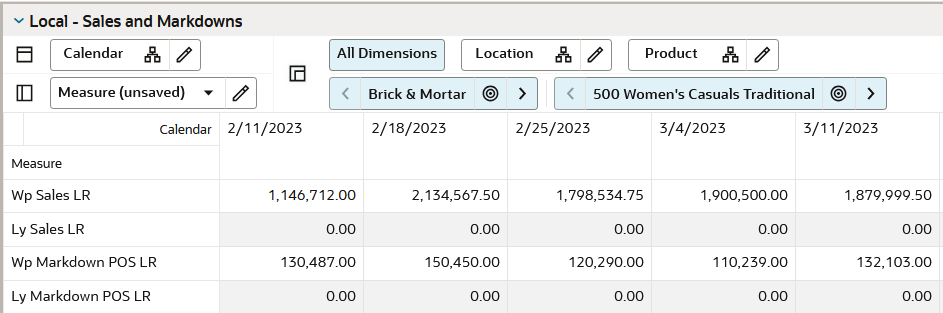

Local - Sales and Markdowns View
If the Local Currency option is provisioned, you use this view. The key planning KPIs are available in local currency for cross-referencing and high-level planning.
Figure 8-10 Local - Sales and Markdowns

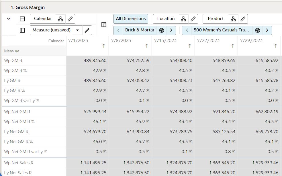

Gross Margin Sub-Step
You build your plan with a close eye on gross margins and net gross margin. Gross Margin is a percentage (or ratio) of gross profit to net sales. Gross profit (expressed as Wp GM R) is the difference between net sales retail and Cost of Goods Sold (COGS). Gross margin and gross profit are very important measures of the profitability and financial performance of a company.
Gross Margin View
Use the Gross Margin view to evaluate the gross margin created from your sales and markdown plan and receipts and inventory plan. Determine whether the planned gross margin meets your gross margin goal. If it does not, return to the Develop Sales and Markdown Plan and Develop Inventory and Receipt Plan steps to adjust your receipt markups and receipt flow. Finally, return to the Gross Margin view to adjust additional contributors to net gross margin such as vendor funds and royalties.
Figure 8-13 Gross Margin View
Gross Margin View

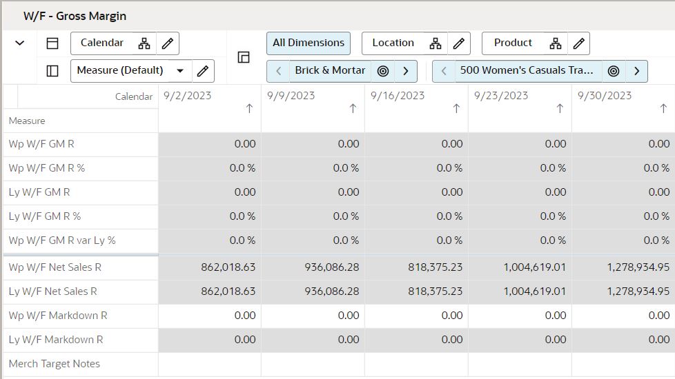

W/F - Gross Margin View
If the Wholesale Franchise option is provisioned, you plan W/F channels in this view.
Wholesale/Franchise sales are typically tracked and managed as a separate channel of a retail business. In the Wholesale/Franchise Gross Margin, you review the planned gross margin on your wholesale/franchise sales.
Figure 8-14 W/F - Gross Margin
W/F - Gross Margin

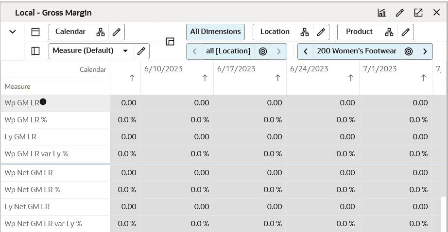

Local - Gross Margin View
If the Local Currency option is provisioned, then there is an additional view to support planning Gross Margin.
The key planning KPIs contributing to gross margin are available in local currency for cross-referencing and high-level planning.
Figure 8-15 Local - Gross Margin

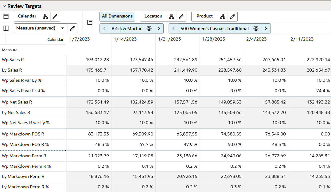

Review Targets Sub-Step
In this sub-step, review the targets you created in the previous step. If you need to alter the targets, return to the Create Targets step to make edits.
Review Targets View
There are several measure profiles in this view to quickly guide you to the plans you wish to review:
  • Default
    This measure profile shows the main Working Plan metrics for comparison with last year metrics. This is the profile you will use after initially performing the Create Targets step.
  • Tgt with Cp
    This measure profile shows the main Working Plan metrics for comparison with Current Plan metrics. Current Plan is a version of the plan that is approved in-season (and is actualized for elapsed/historical periods).
  • Tgt with Op
    This measure profile shows the main Working Plan metrics for comparison with Original Plan metrics. Original Plan is the plan as it was initially approved-typically it got approved pre-season and stays fixed when the period becomes in-season.
Figure 8-16 Review Targets View
Review Targets View

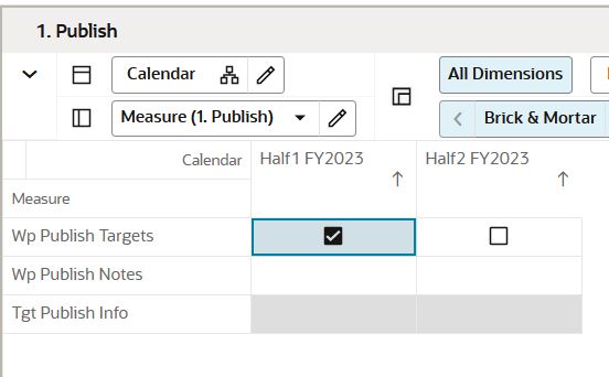

Publish Targets Sub-Step
Publishing a target copies the targets you built in the Wp measures to the target (Tgt) measures, and then commits them to the database. Once committed, Planners can retrieve those targets and take action planning to them.
The Tgt measures are shown in the Publish Targets view found in the Review and Publish Targets step. These measures initially have zero values. After the targets are published in this step, those measures are populated with the target information.
Publish Targets View
To publish the targets, complete the following steps.
  1. Select the halves in the Wp Publish Targets measure that you want to publish.
  2. If needed, enter relevant information in the Wp Publish Notes measure. This is optional.
  3. Repeat Steps 1 and 2 for other channels and departments as desired.
  4. Click Publish Targets. This button is located in the bottom right corner.
  5. A success message is displayed. Click Dismiss to close it.
    The view refreshes and clears the data in Wp Publish Targets and Wp Publish Notes measures. It populates the data for Tgt Publish Info measure as name:date:notes.
    Figure 8-17 Publish Targets
    Publish Targets

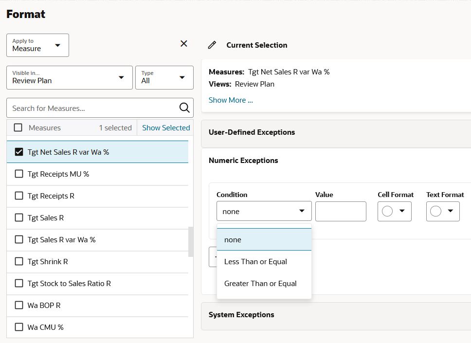

Tip:
Use exception formatting on the variance measures to highlight variances. To reach the formatting dialog, right click the measure label and choose Format from the popup menu.
Figure 8-18 Format Dialog
Format Dialog

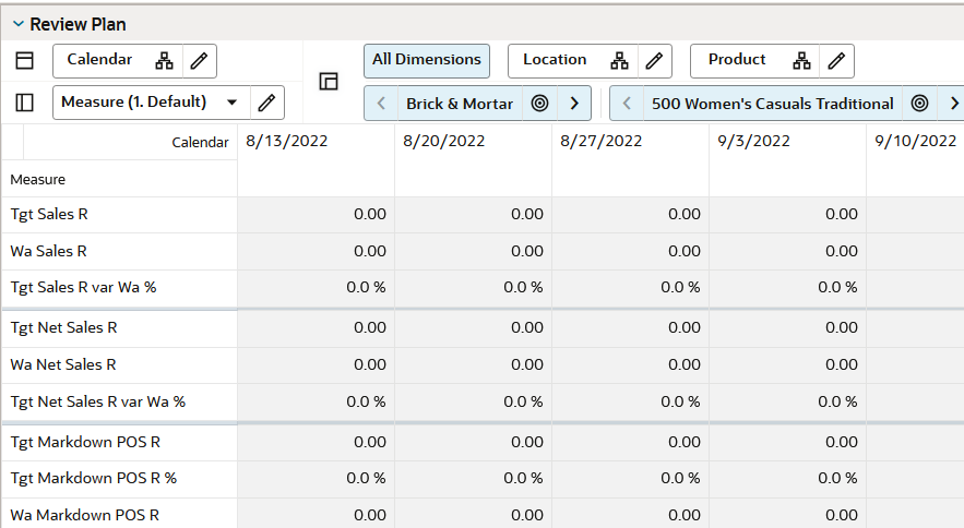

Review Plan Sub-Step
Similar to pre-season, the Review Plan sub-step is performed to review the Planner's in-season plan which is awaiting approval.
Review Plan View
This view shows the currently published targets compared to the Waiting Approval (Wa) plan.
Figure 8-20 Review Plan View
Review Plan View

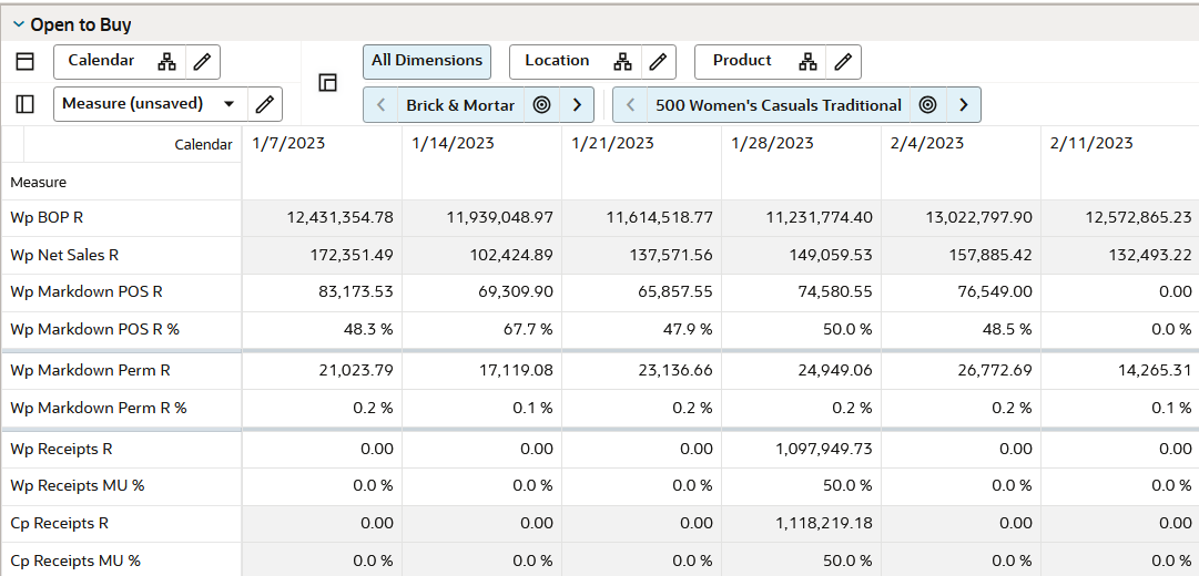

Open to Buy Sub-Step
This sub-step has one view.
Open to Buy View
Use Open to Buy (OTB) to understand the variance between the planned and projected inventory levels. This variance is shown in the Wp OTB R measure. OTB indicate how many additional receipts can be purchased (or canceled) after projected sales and markdowns. Users should understand if their planned receipts keep them on the overall Cp EOP inventory plan. To understand the variance between the Cp EOP inventory plan and the Wp EOP inventory plan, reference the measure Wp EOP R var Cp%. Use this view to validate what OTB you have available and then start adjusting your plan. Then, confirm that your updates can be obtained given the OTB constraints you may have. Use the following best practices to adjust OTB:
  • To understand the difference between the current approved receipts and the net on order, compare Cp Receipts R to Wp Net On Order R.
  • If receipts are booked for upcoming (non-elapsed) periods, you can enter the Wp Receipt R data into the Wp On Order Adj R to capture the Wp OTB R measure. For example, this may occur if receipts book daily for the retailer, and OTB is completed on a Tuesday. By using the Wp On Order Adj measures, you can capture all receipts for comparing the Net On Order to the Cp receipt plan.
This view has two measure profiles:
  • Default
    This measure profile focuses on key metrics of total sales, markdowns, receipts, and on order to summarize open to buy.
  • Units
    This measure profile focuses on unit and average unit cost key metrics for sales, receipt, and on order.
Figure 8-21 Open to Buy View
Open to Buy View
