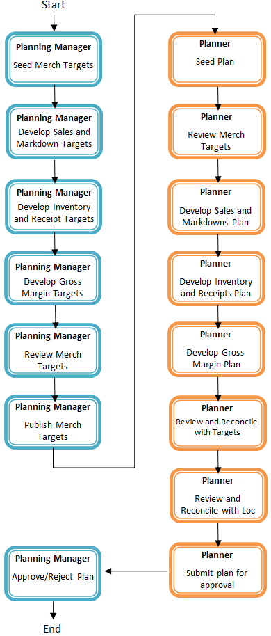

Merch Planning Process
The Merch planning process can be separated into two sub-processes: pre-season and in-season planning. Creating the merchandise financial plan occurs during pre-season planning. Managing and updating the merchandise financial plan occurs during in-season planning. Pre-season planning focuses on creating the Original Plan (Op) against which to benchmark in-season progress. In the pre-season process, the plan is initialized by seeding from Last Year (Ly) or from a forecast. This seeding gives users a curve of demand against which to spread a new plan. Users then plan sales, receipts inventory, turn, and gross margin measures.
There are two types of users in merch planning:
  • Planning Managers. These users are planning directors or managers. They create the overall targets for the Merch Plan.

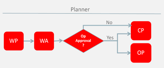

  • Planner. These users are the merchandise planners. They create Original Plan (Op) and Current Plan (Cp) plans for approval by the Planning Managers role.
The targets are published by superior levels to the subsequent level: Planning Managers passes targets to the Planner. The Planner then submits the Op, Cp, or both to the Planning Manager for approval. The Op and Cp plans are not created until they are approved by the Planning Manager.
This process is shown in Figure 1-1 and Figure 1-2.
Figure 1-1 Create Merchandise Financial Targets and Plan Process

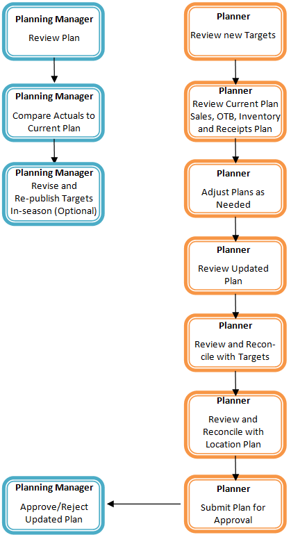

After the planning period has begun, the process of in-season planning begins. The objective of in-season planning is to track progress against the original plan in order to identify opportunity and risk for the Original Plan (Op).
Figure 1-2 Manage/Update Merchandise Financial Plan Process

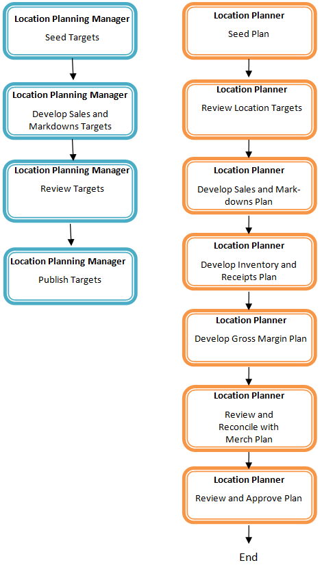

This process is shown in Figure 1-3 and Figure 1-4.
Figure 1-3 Create Location Targets and Plan Process

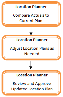

Figure 1-4 Manage/Update Location Plan Process

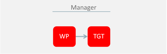

The Manager sets targets for the Planner, both for Merchandise Financial Planning and Location Planning. The approved plans can be made visible to an item planner using a separate product, Oracle Retail Item Planning.

Figure 1-5 Plan Versions Created by Manager
Figure 1-6 Plan Versions Created by Planner

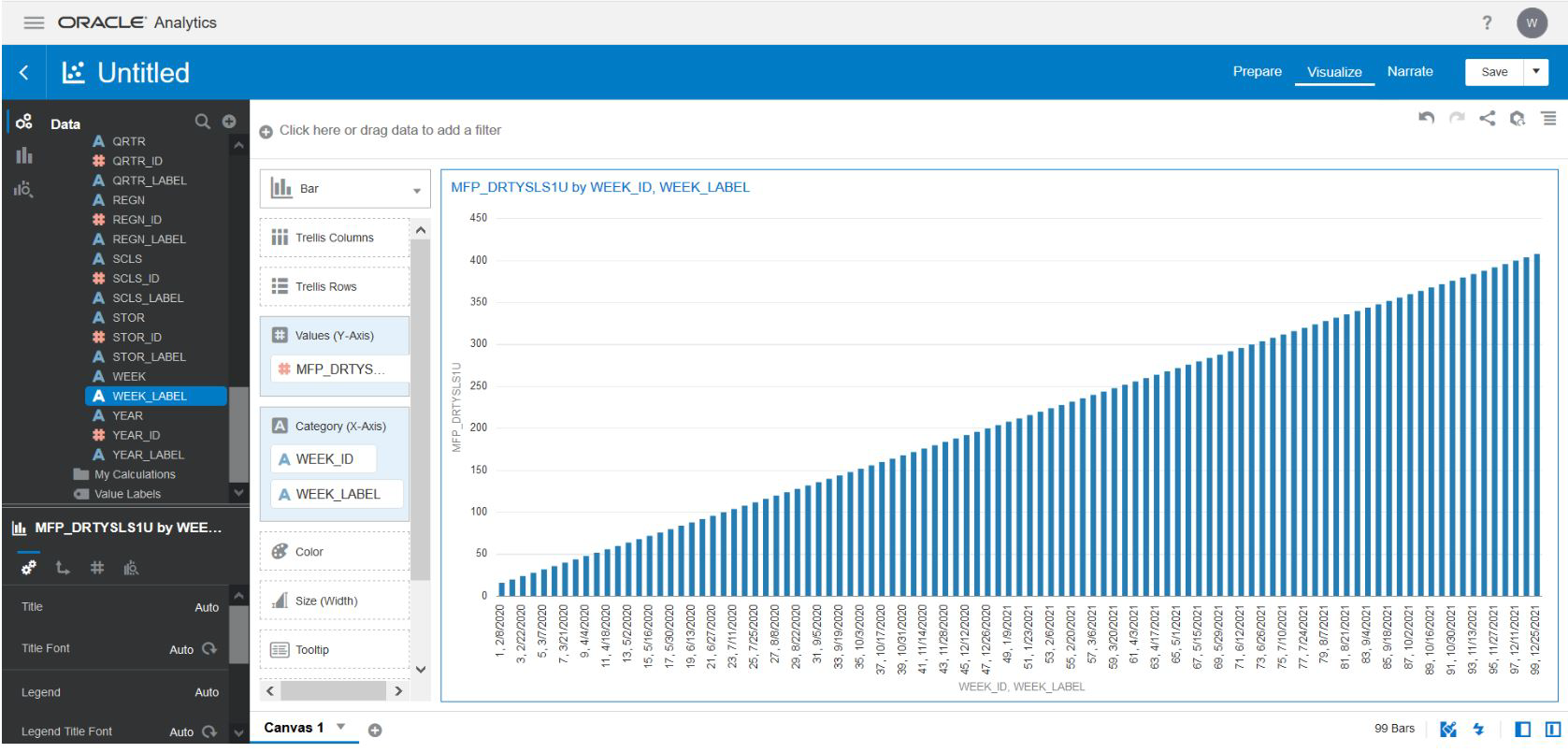

Figure 1-7 Data Visualization Reports
Data Visualization reports are now available out-of-the-box for the MFP application. These reports allow you to analyze KPIs visually leveraging the best reporting capabilities Oracle offers. The provided out-of-the-box reports are expected to serve as a starting point for users. You can then further build required reports tailored to your specific needs.
These out-of-the-box reports are included as part of the OAS catalogue. To access the reports, navigate to the Shared folder, then the AI Foundation folder and finally the MFP folder.
