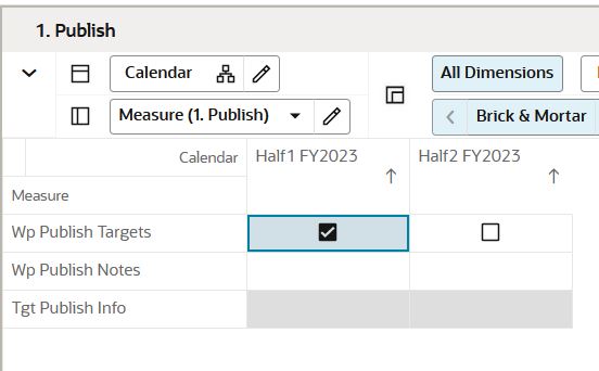

The first two steps are related to pre-season creation and publication of targets to the Merch Planner. The third step involves reviewing and approving or rejecting plans submitted by the Merch Plan role. The fourth step is used for in-season adjustments to targets.
The Planning Manager must complete the first two steps to publish the strategic targets to the Planner.

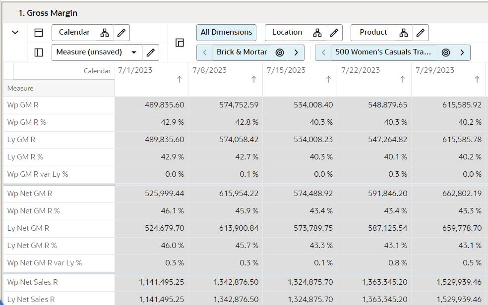

  5. Review Gross Margin results.

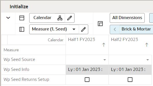

Initialize View
In order to seed the plan, you can first review the Last Year (Ly) plan and forecast in the Sales/Markdowns tab. This helps you determine which plan you use for seeding.
Table 8-1 Initialize View Measures
Measure Description
Seed Source
The seed source used to seed the working plan. Use this option to seed or not seed the working plan. You can seed with Last Year (Ly), Forecast (Fcst), or Portfolio Optimization data. Or, you can choose the blank option if you do not want to seed the working plan.
Seed Info
Includes a few pertinent facts about the last time that the Seed custom menu was executed: last seed source concatenated with last seeded date and the last user to seed.
If blank, then the given intersection has never been seeded.
Seed Returns Setup
Use this option to seed the working plan returns. You can seed the returns values with Last Year (Ly) or Forecast (Fcst) data. You can also choose the blank option if you do not want to seed the working plan returns.
When seeding the plan, you can choose which information is seeded. For instance, you can seed just one half or all halves in the workspace. You can also choose what locations and products to seed.

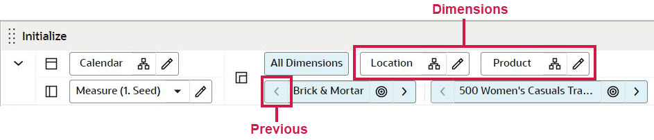

  1. Click the dimension whose value (position) you want to change..
  2. Click the Next or Previous arrow.
    Figure 8-1 Changing a Dimension Level with Page Arrows
  3. The page refreshes and the next position in the department dimension is displayed in the page edge. Notice that the Seed Source measure is not populated for this department.

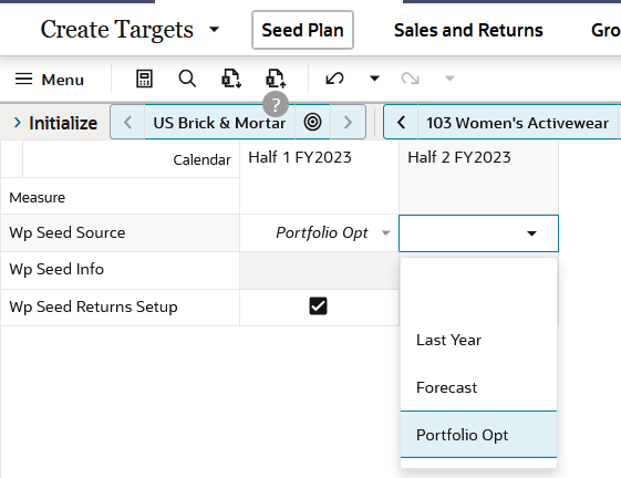

  4. Select the half that you want to seed with Last Year (LY), Forecast (Fcst), or Portfolio Optimization data.
    Before seeding with Portfolio Optimization data, you need to retrieve results from Portfolio Optimization using the Review Portfolio Optimization view.
    Figure 8-2 Seeding Options
    Seeding Options

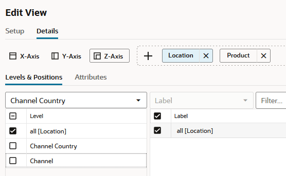

To change the dimension shown in the page edge or grid, complete the following steps:
  1. Click the Edit View button of the dimension level you want to change.
    Figure 8-3 Location Tile — Edit View Button
  2. The dimension window is displayed. Select the level of the dimension that you want to appear in the page edge. If you want to view more than one level at a time in the page edge or grid, select multiple levels. In the following figure Channel was deselected and all [Location] was selected instead.
    Figure 8-4 Location Dimension Selection Window
  3. Click OK when finished.
  4. Repeat Steps 1 through 3 for other dimensions if necessary.

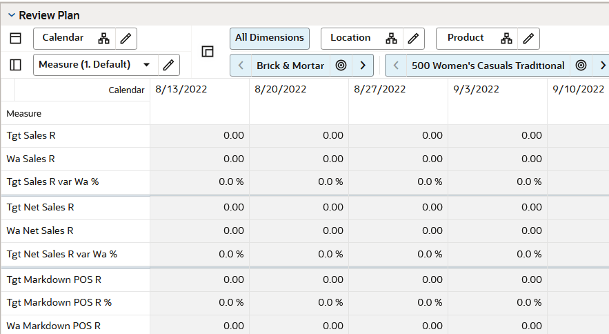

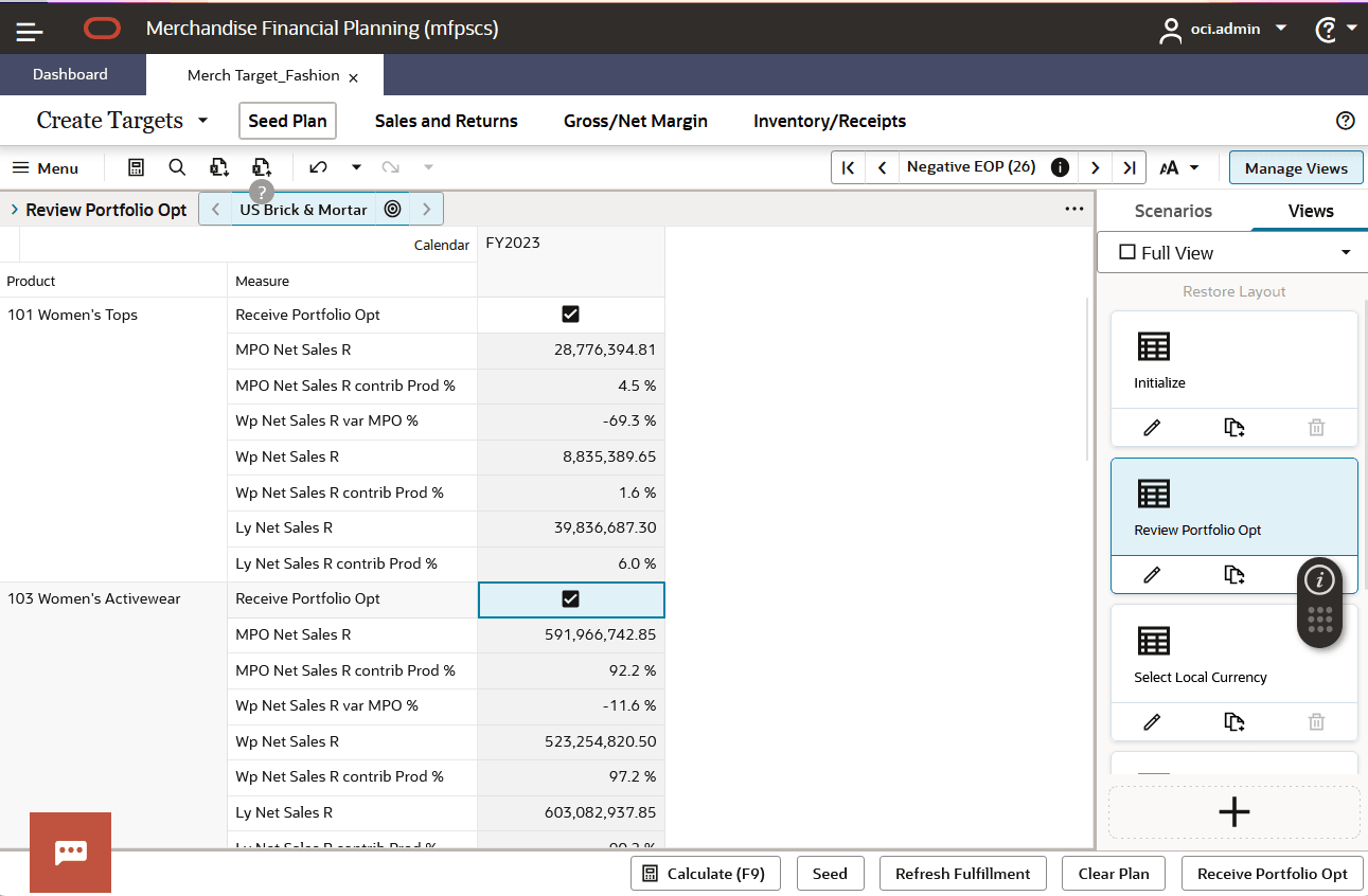

Review Portfolio Optimization View
The Portfolio Optimization output can be used for seeding the Merch Target Plan. Select the Boolean for dimension scope and click the custom menu action, Receive Portfolio Opt. After the results are populated against the MPO (Portfolio Optimization) measures, you can proceed with seeding the plan from the Initialize view. By default, MFP GA receives Net Sales R as output from Portfolio Optimization and it populates MPO Net Sales R in the view. The portfolio optimization results are retrieved at the year level which are then split into weeks using the LY data reference while seeding. You can choose to configure it for Gross Sales Portfolio Optimization output.
When creating the Merch Target workbook, the scope of the workbook should be at the same level of the scope of the Portfolio Optimization run.
Figure 8-6 Review Portfolio Optimization View

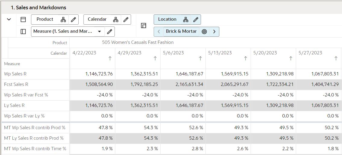

Sales and Markdowns View
In the Sales and Markdowns view, you plan net sales, promotions, and markdowns. Sales are the revenue generated by selling goods or services. Regular priced sales yield the greatest margin, however successful promotions drive more traffic and completion of sales. Though the promotional sale likely includes markdown, the overall increase in sales should outweigh the markdown and drive at good margins.

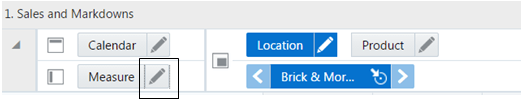

There are several measure profiles available to logically guide you through the plan variables.
A measure profile is selected by clicking on the Edit View button next to the Measure tile.
Figure 8-7 Edit View Button
Edit View Button

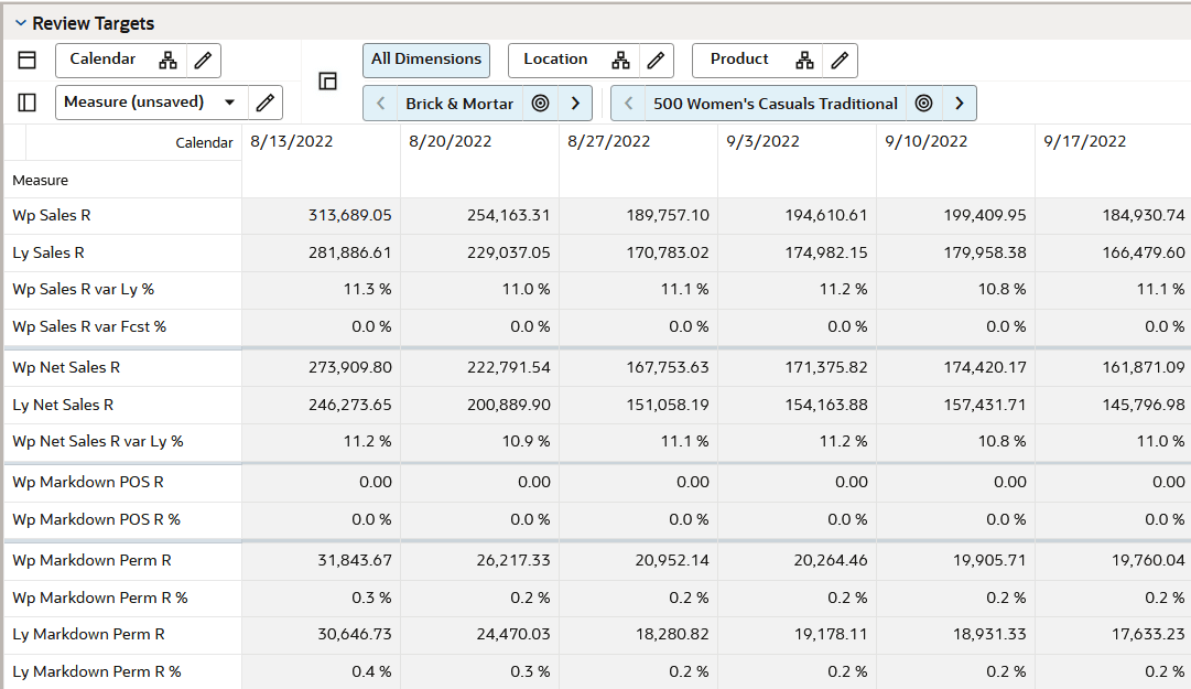

Follow these steps to basic sales and markdown generation.
To create the Merch Targets, one approach is to complete the following steps within the views described above:
  1. Using the default measure profile, which is Sales and Markdowns, review and compare the total sales to the forecast and last year.
    When building the targets for Wholesale/Franchise channels, plan Net Sales and then go directly to the W/F - Sales and Markdowns view.
  2. Enter the Wp Sales R that you are projecting. Use Fcst Sales R as a guide.
  3. Enter the projected Wp Gross Margin% at month level and click Calculate in order to calculate the Wp Gross Margin R and Wp Net Sales C.
  4. Continue to the next sub-step to plan the required inventory. Review Wp Stock to Sales Ratio. Adjust other seeded inventory measures, such as Wp Shrink C and Wp MOS C, and plan the Wp Receipts C to achieve the desired stock to sales ratio.

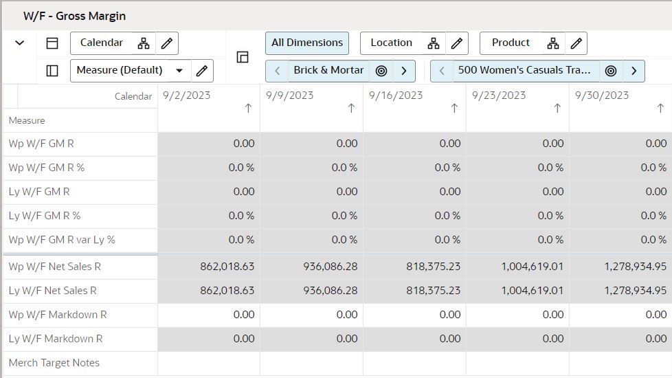

W/F - Sales and Markdowns View
If the Wholesale/Franchise option is provisioned, you plan sales here. Wholesale/Franchise sales are typically tracked and managed as a separate channel of a retail business. Use the Wholesale/Franchise Sales and Markdowns view to build your target sales, markup, and markdowns that you will make as wholesaler or franchisor.
Figure 8-10 W/F - Sales and Markdowns

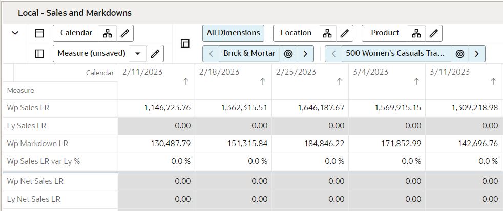

Local - Sales and Markdowns View
If the Local Currency option is provisioned, you use this view. The key planning KPIs are available in local currency for cross-referencing and high-level planning.
Figure 8-11 Local - Sales and Markdowns

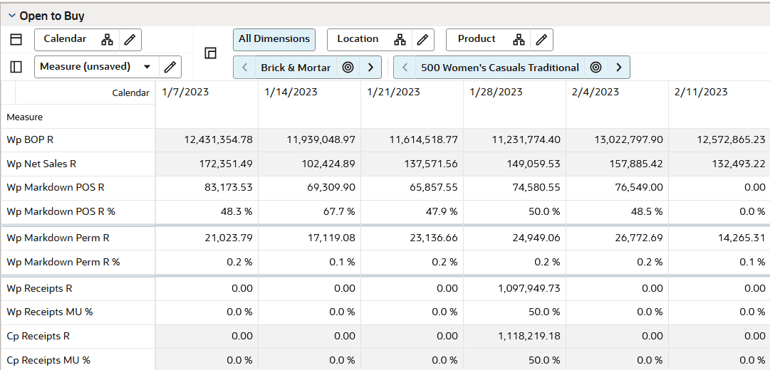

Inventory/Receipts Sub-Step
After you have developed the sales and markdown target, develop a receipts and inventory target that can support the planned sales and markdown. The purpose of this step is to ensure that you have a receipt and inventory plan that supports the sales that you are projecting.

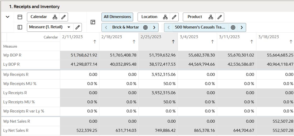

Receipts and Inventory View
Receipts and Inventory is where you will plan Beginning-of-period (BOP)/End-of-period (EOP) inventory, receipts, turn, and so on. This view is frequently planned at a month level. At a month level, EOP is usually targeted to be about the same as BOP and then ramp up for holiday gift giving is factored in. After planning the month, it is wise to review the results at a week level to ensure there are no undesirable anomalies.
Stock to Sales Ratio is an important indicator of the effectiveness of the planned inventory. The stock to sales ratio is the proportion of inventory on hand at the beginning of a period (such as a week or month) that will support the planned sales in that period.
If the Stock to Sales Ratio rises, (due to an increase in inventory without an accompanying rise in sales), then you are adding more stock without increasing sales. Unless you are intentionally ramping up stock for holiday, promo, and so on, then it is time to hold off on receipts and work on selling down the quantity on that item. The ultimate goal is to reduce your Stock to Sales Ratio as low as possible, without losing sales.
This sub-step is not performed for W/F channels.
The adjustments you made to the Sales and Markdowns view are visible in this view if you have clicked Calculate.
Move to Clearance View
This is an important step in creating separate Reg+Promo and Clearance balance sets.
Figure 8-13 Move to Clearance View
Gross Margin Sub-Step
You build your plan with a close eye on gross margins and net gross margin. Gross Margin is a percentage (or ratio) of gross profit to net sales. Gross profit (expressed as Wp GM R) is the difference between net sales retail and net sales cost. Gross margin and gross profit are very important measures of the profitability and financial performance of a company.
Gross Margin View
Use the Gross Margin view to evaluate the gross margin created from your sales and markdown plan and receipts and inventory plan. Determine whether the planned gross margin meets your gross margin goal. If it does not, return to the Develop Sales and Markdown Plan and Develop Inventory and Receipt Plan steps to adjust your receipt markups and receipt flow. Finally, return to the Gross Margin view to adjust additional contributors to net gross margin such as vendor funds and royalties.
Figure 8-14 Gross Margin View
Gross Margin View
W/F - Gross Margin View
If the Wholesale Franchise option is provisioned, you plan W/F channels in this view.
Wholesale/Franchise sales are typically tracked and managed as a separate channel of a retail business. In the Wholesale/Franchise Gross Margin, you review the planned gross margin on your wholesale/franchise sales.
Figure 8-15 W/F - Gross Margin
W/F - Gross Margin

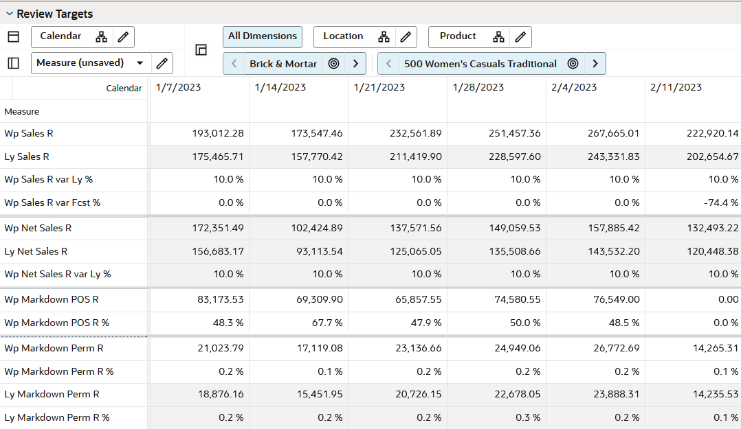

Review Targets Sub-Step
In this sub-step, review the targets you created in the previous step. If you need to alter the targets, return to the Create Targets step to make edits.
Review Targets View
There are several measure profiles in this view to quickly guide you to the plans you wish to review:
  • Default
    This measure profile shows the main Working Plan metrics for comparison with last year metrics. This is the profile you will use after initially performing the Create Targets step.
  • Tgt with Cp
    This measure profile shows the main Working Plan metrics for comparison with Current Plan metrics. Current Plan is a version of the plan that is approved in-season (and is actualized for elapsed/historical periods).
  • Tgt with Op
    This measure profile shows the main Working Plan metrics for comparison with Original Plan metrics. Original Plan is the plan as it was initially approved-typically it got approved pre-season and stays fixed when the period becomes in-season.
Figure 8-16 Review Targets View
Review Targets View

To publish the targets, complete the following steps.
  1. Select the halves in the Wp Publish Targets measure that you want to publish.
  2. If needed, enter relevant information in the Wp Publish Notes measure. This is optional.
  3. Repeat Steps 1 and 2 for other channels and departments as desired.
  4. Click Publish Targets. This button is located in the bottom right corner.
  5. A success message is displayed. Click Dismiss to close it.
    The view refreshes and clears the data in Wp Publish Targets and Wp Publish Notes measures. It populates the data for Tgt Publish Info measure as name:date:notes.

Review Plan Sub-Step
In the Review Plan sub-step, you directly compare the Planners Wa plan to the targets. There are several Tgt-to-Wa variance measures that quickly guide you to areas of difference.

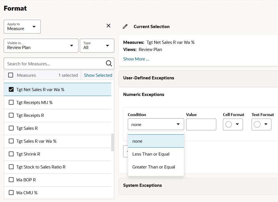

Tip:
Use exception formatting on the variance measures to highlight variances. To reach the formatting dialog, right click the measure label and choose Format from the popup menu.
Figure 8-17 Format Dialog
Format Dialog
If plans have been published, republished, submitted, or resubmitted since you created the workspace, select Refresh from the Action menu to reload the latest values. A refresh will reload all data in the workspace to the last committed version, so you must commit all of your plan work first, or it will be reverted to the last point of commit.
Continue to the Approve step to set the plan's Approved status to either approved or rejected.

Review and Re-Project Sub-Step
Use the Review and Re-project sub-step to compare and rework your Wp targets with the current plan, the original plan, and last year's actuals.
Review Targets View
Use the following measure profiles in this view to review and re-project as desired:
  • Default
    Use this profile to see Wp and Ly values.
  • Tgt with Cp
    Use this profile to see Wp and Cp values.
  • Tgt with Op
    Use this profile to see Wp and Op values.
Figure 8-18 Review Targets View
Review Targets View

Open to Buy Sub-Step
This sub-step has one view.
Open to Buy View
Use Open to Buy (OTB) to understand the variance between the current planned receipts and the on order plus any on order adjustments. This variance is shown in the Wp OTB C measure. OTB indicate how many additional receipts can be purchased. Users should understand if their planned receipts keep them on the overall Cp EOP inventory plan. To understand the variance between the Cp EOP inventory plan and the Wp EOP inventory plan, reference the measure Wp EOP C var Cp%. Use this view to validate what OTB you have available and then start adjusting your plan. Then, confirm that your updates can be obtained given the OTB constraints you may have.
The following profiles are available:
  • Cost
    This measure profile focuses on key metrics of total sales, markdowns, receipts, and on order to summarize open to buy.
  • Units
    This measure profile focus on unit and average unit cost key metrics for sales, receipt, and on order.
Use the following best practices to adjust OTB:
  • To understand the difference between the current approved receipts and the net on order, compare Cp Receipts C to Wp Net On Order C.
  • If receipts are booked for upcoming (non-elapsed) periods, you can enter the Wp Receipt C data into the Wp On Order Adj C to capture the Wp OTB C measure. For example, this may occur if receipts book daily for the retailer, and OTB is completed on a Tuesday. By using the Wp On Order Adj measures, you can capture all receipts for comparing the Net On Order to the Cp receipt plan.
Figure 8-21 Open to Buy View
Open to Buy View

  • Direct
    Key metrics for e-commerce are display including traffic, transactions, and returns.
  • Local Currency
    If the Local Currency option is enabled, user view key metrics in local currency.
